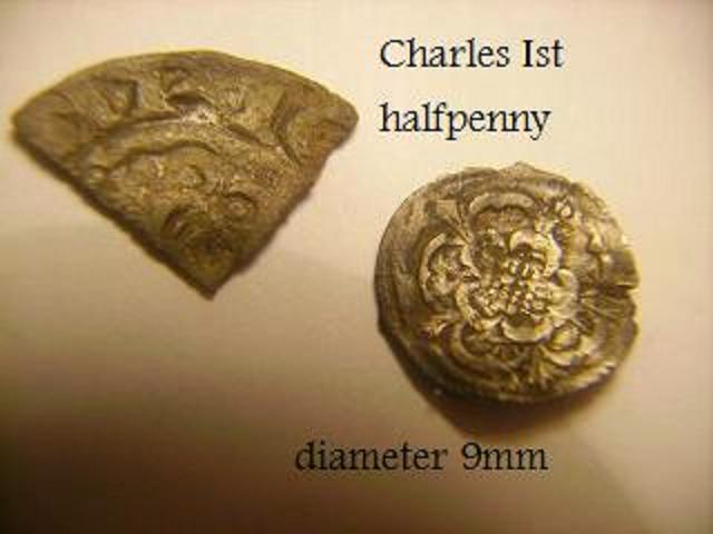

                    Here are two tiny English hammered coins that I found fairly recently- surface finds on damp soil. The round Charles Ist halfpenny is 9mm diameter. They are both made from good quality silver. I actually found them with my Blisstool which is 8Kz but it does seem to find tiny surface (2" down) coins quite easily as well as much deeper larger coins. I'd like to know how it can do this as my old 12Khz Tesoros wouldn't have signalled on them so easily.
                    I keep wondering whether to use my GMP (18Khz) on some sites or the Blisstool. The GMP is quieter overall and generally easier to use. I took both machines out once and tested them on bad ground on a very tiny (about 8-9mm diameter) thin gold Indian coin laid on the surface. I actually got a slightly better signal from the Blisstool so I am still confused about the frequency issue, i.e. which is the best for tiny hammered.. The Blisstool has a built in Lithium battery so perhaps that is making it more sensitive/powerful than the GMP.
