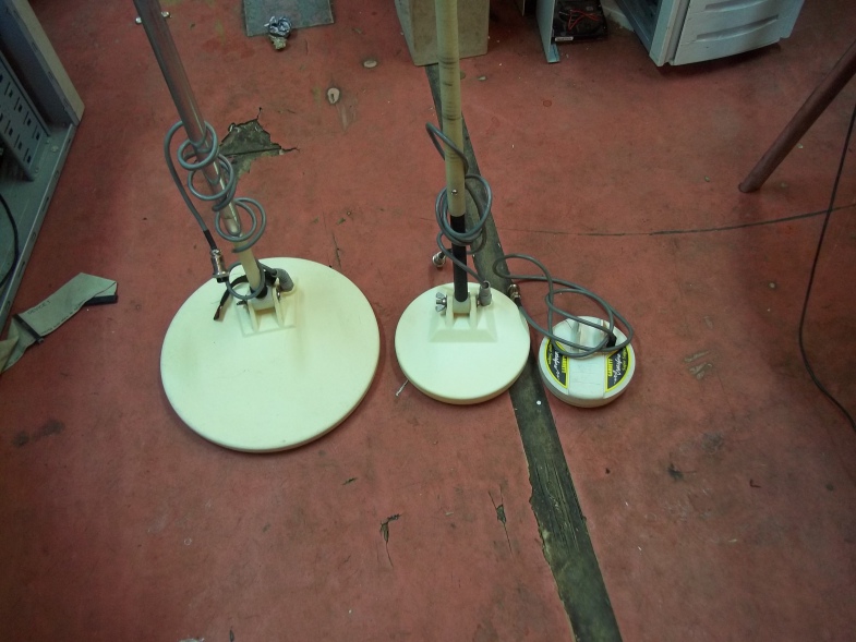

                    hi nm, and all, yes these detectors do need the coils retuning if they go out of whack, though they are no longer produced the official uk supplier still has new stock and rebalances the coils.
                    there are ways round this though, you could build a dd coil to the right spec, and i have heard of modifying coils off of another machine but cant remember what, a little digging around might help there, the thing i always found strange about these machines was that the simplified machine actually cost more than the full bells and whistles version.
                      reading your other thread rang a bell, on the russian pics, there are two Nautilus coils large and small, at the side is a tiny older garrett coil, this jogged old memories about small coils on the Nautilus, if the small ones work just find the larger garrett counterparts if the small ones work so will the large.
                      you need to identify the 5" garrett coil in the russian pics, then look for its larger version, they may not be as spot on as the original, but they may work well enough and wont need nulling every 2 years.
                      hope this helps.Click image for larger version
