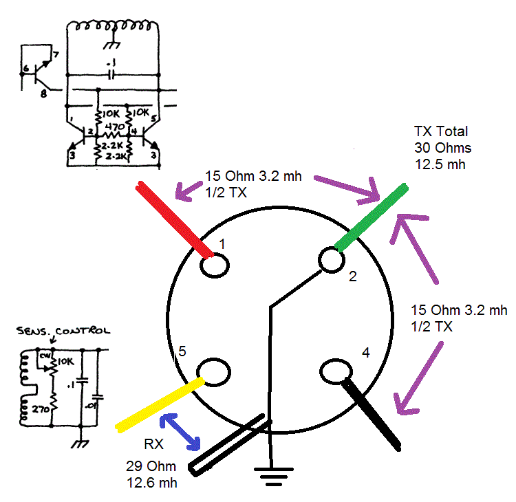

    I bought a Fisher 440 coil off Ebay to play around with and thought I'd give the
    specs here for future generations;
    TX center tapped 12.5 mh total 30 ohms
    3.2 mh per side 15 ohms
    RX 12.5 mh 30 ohms
    Picture;
    I'll build a center tapped TX and try running this beast on my TGSL.
