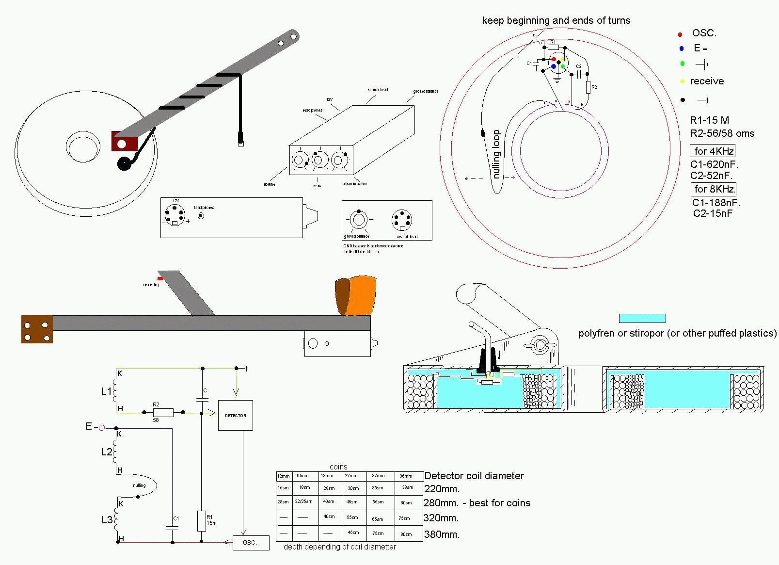

    hi all trying to find the pinouts of the fisher 1266, plug and socket, done a search but could not find it i know it used to be here, the coil i have is the white spider coil (8"), the diagram one i found did not match my coil wire, it had different colours, mine only has white plus a screen, and red plus a screen.
    thanks.
    I have this;
      I have this;
      [ATTACH]30910[/ATTACH]
      thanks SD, this is the one i found, but looking at mine it is not even similar, there are only 4 wires in mine,red and white and two braids.
      to be honest nothing iv'e seen on the net looks like this.

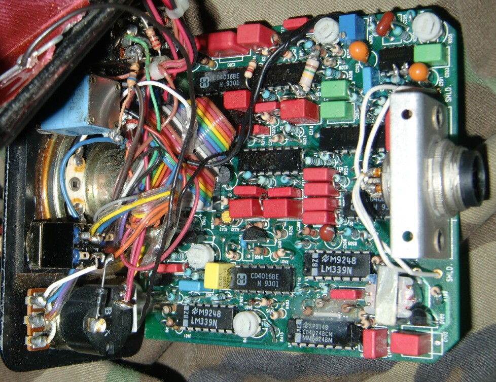

        Well this pic of the inside of the detector shows 4 white wires and two are marked shield;

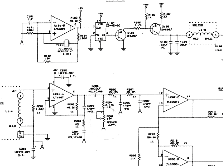

        And here's part pf the original schematic. It shows white and shield is RX and Red and shield is TX;
          thanks sd, now i know how to do it.
