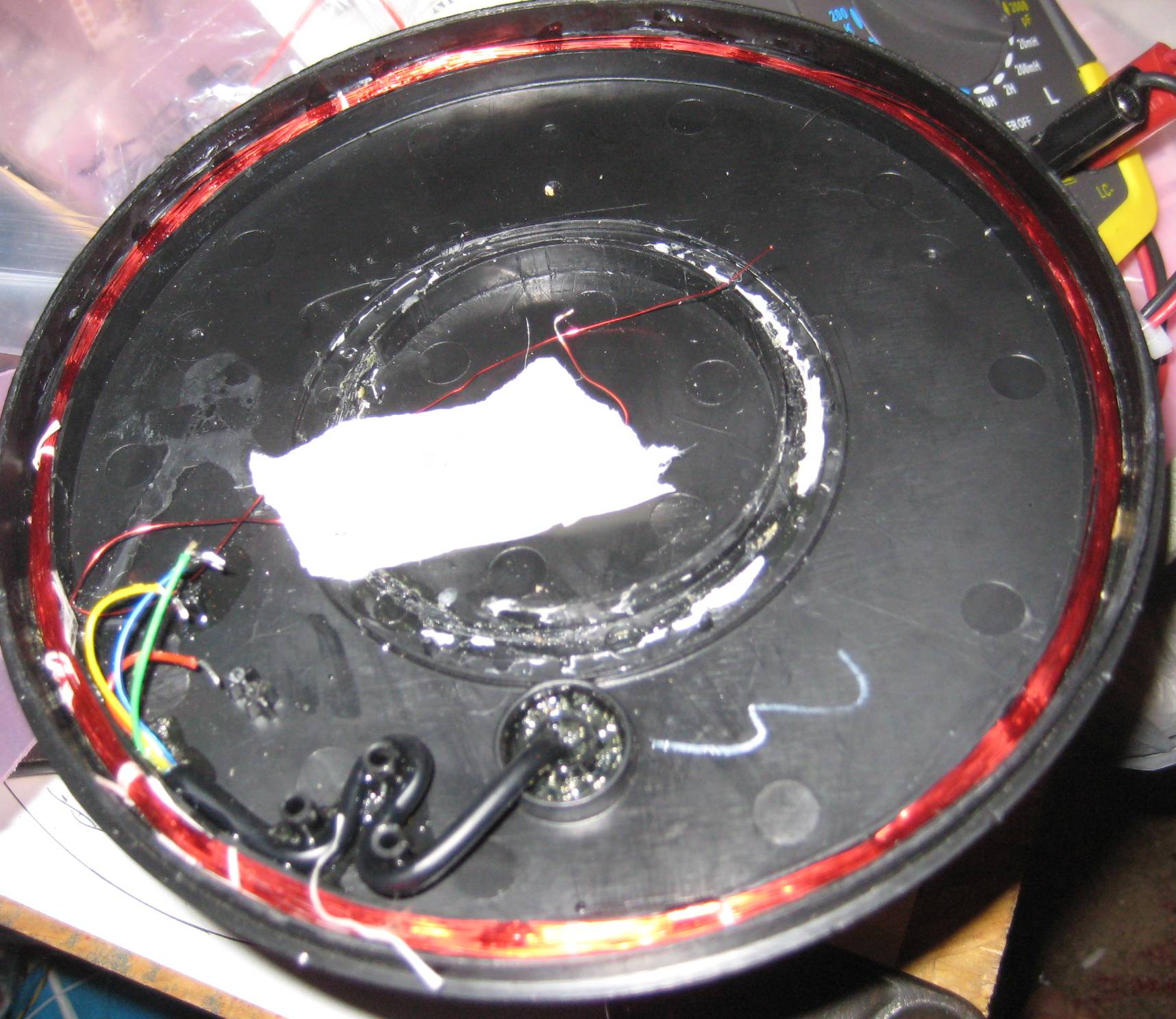

            I am winding a 6" coil to fit inside an old Radio Shack detector I got at a yard sale for $5 and
            found a huge change in inductance from on the form to off. I had never seen this with other
            coils but always tied them with dental floss while on the form and super glued them there too.
            This one I decided not to tie and use minimal super glue but it was tricky as I had to put it
            back on the form for 10 more turns!

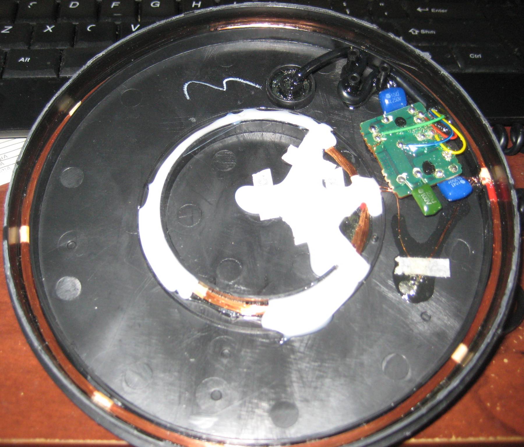

            Original Radio Shack Coil;
            New TX;

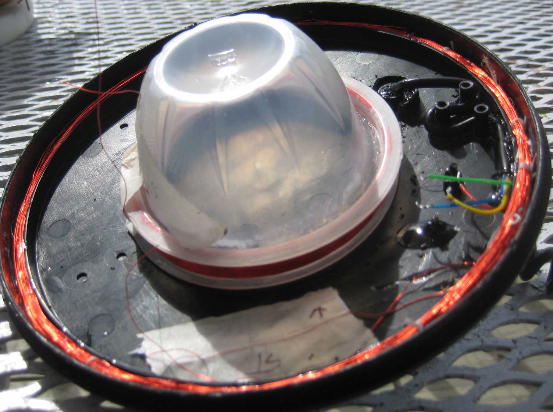

            Now to wind a 3" RX with bucking coil on top. It's tough finding a bobbin to use so I'm making one
            out of some old plastic applesauce containers. I hope 200 winds fits on it!
              So my coil sits with TX = 6.24mh and RX = 6.48mh
              The plan is that the buck will subtract 0.12mh so
              I will end up with 6.0 and 6.5 give or take a little.
              Here's a picture;
              I'm still working out how to epoxy the coils and shield it...

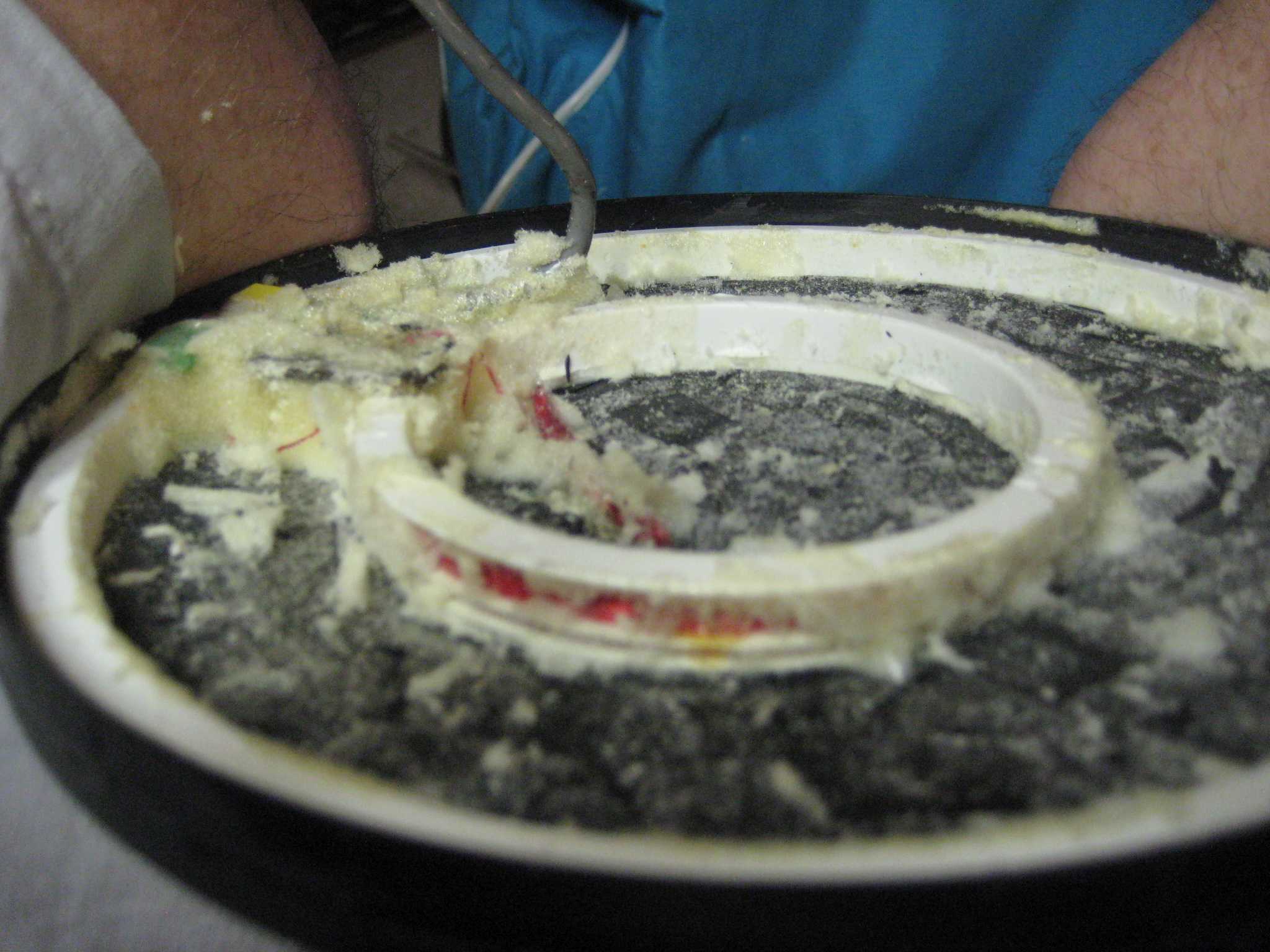

                I just opened up an old Bounty Hunter coil. It uses a spool with RX above buck. See picture;
                Anyone know what solvent might melt the 2 part foam and leave everything else intact for
                cleanup of this coil?
