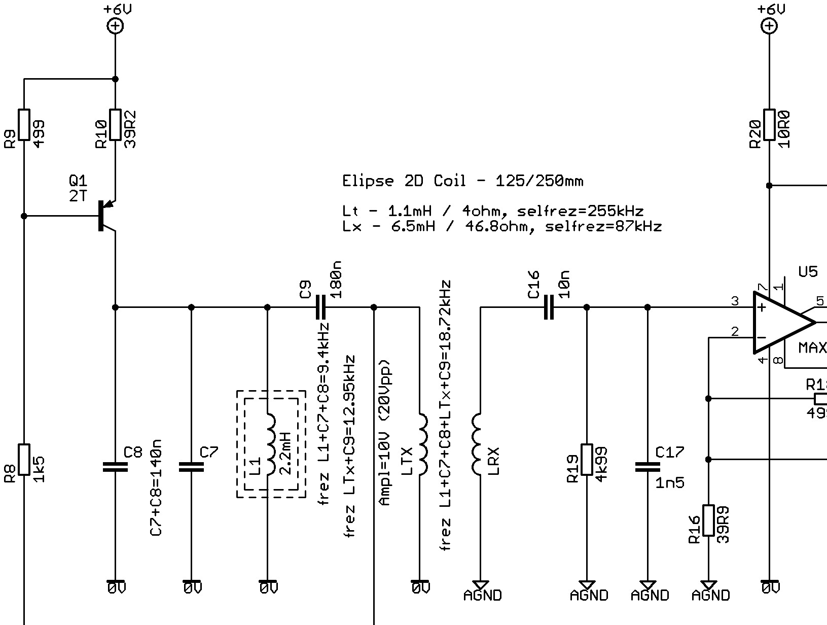

    There's some info here;
    http://www.geotech1.com/forums/showt...highlight=troy
      mrand alias (Poland state) did draw this diagram.
