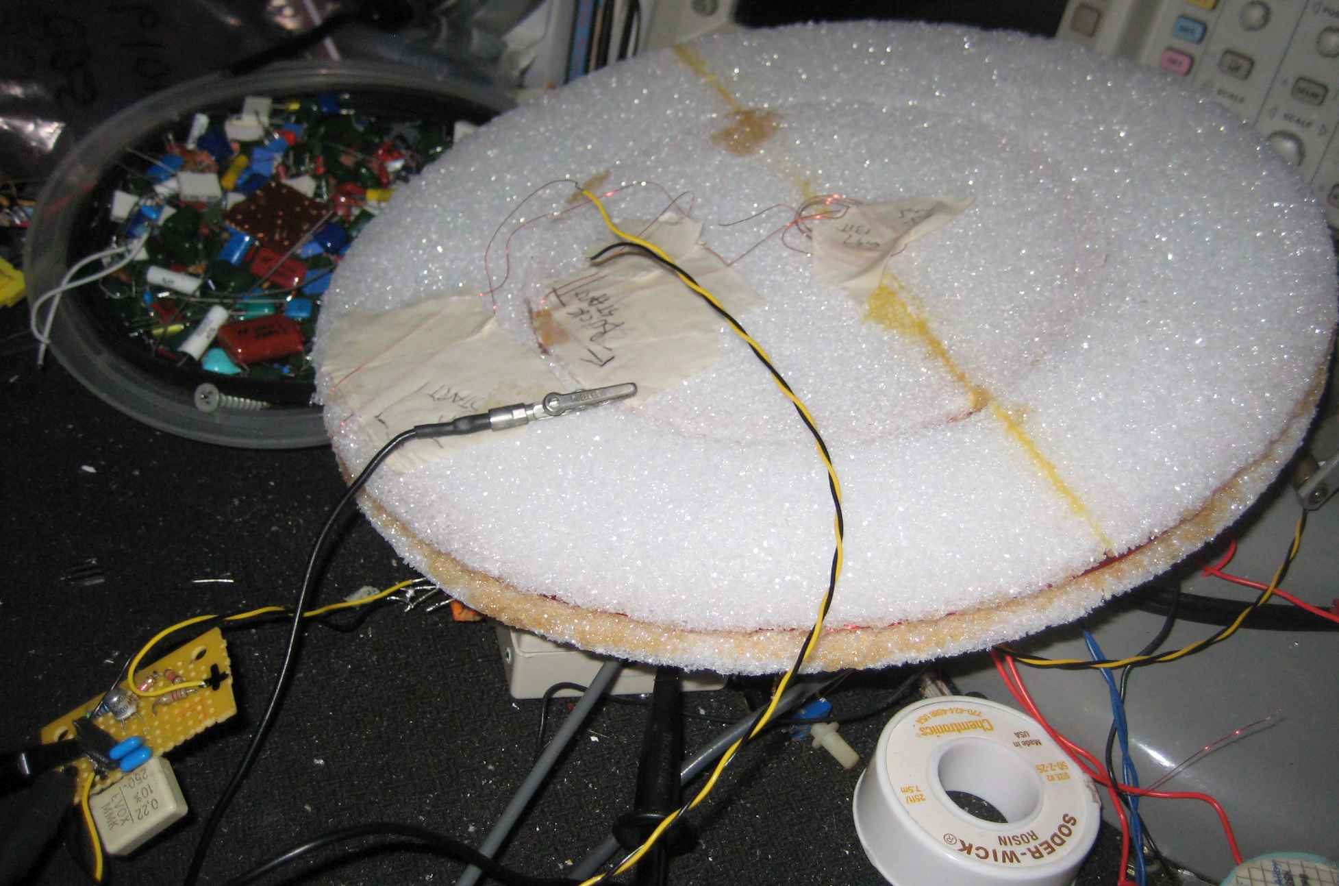

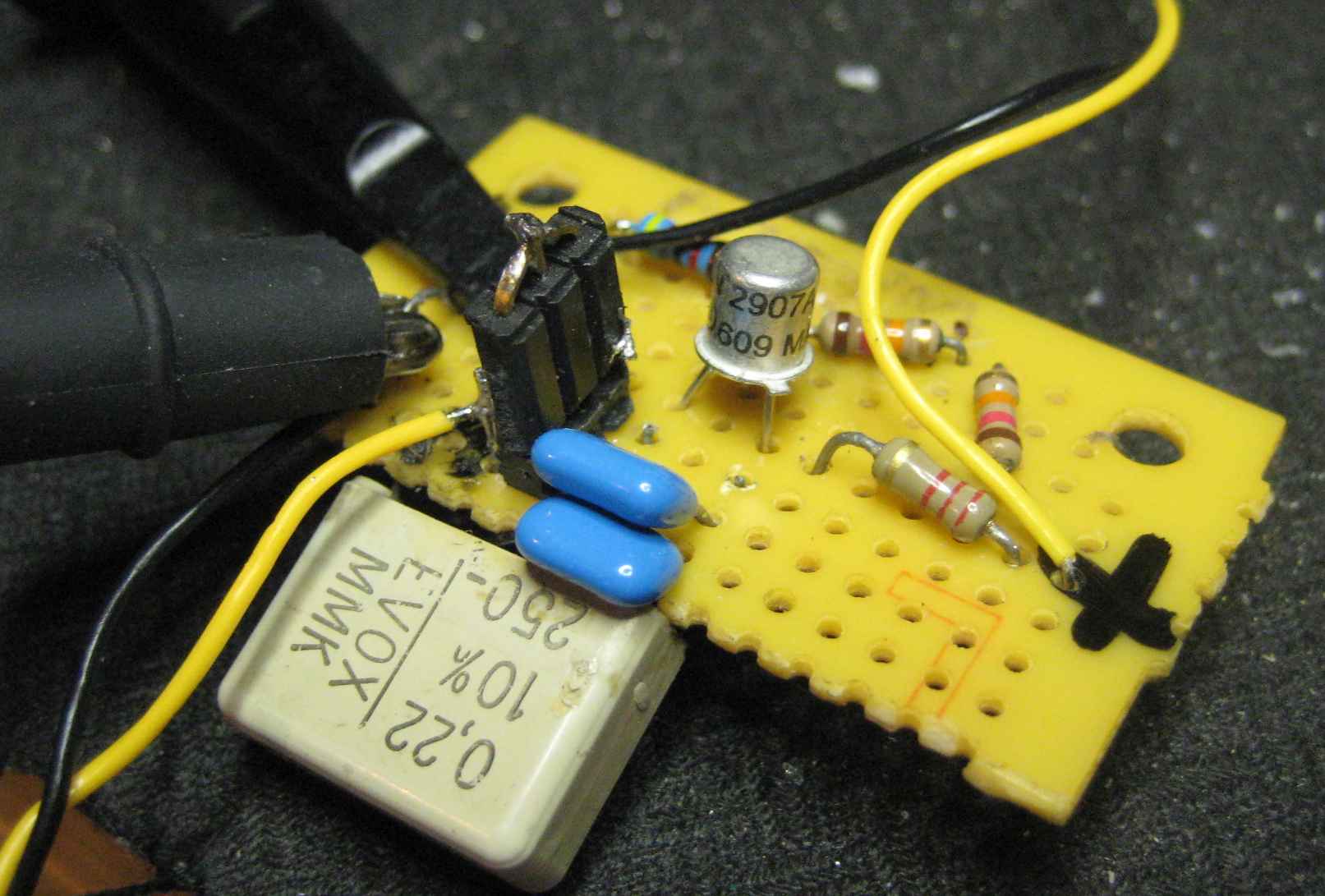

              Well I decided to build the TFT oscillator (Triple Frequency Transmitter) to test this out;
              I used the 440 foam and coils (Note: They were in my lap during testing);

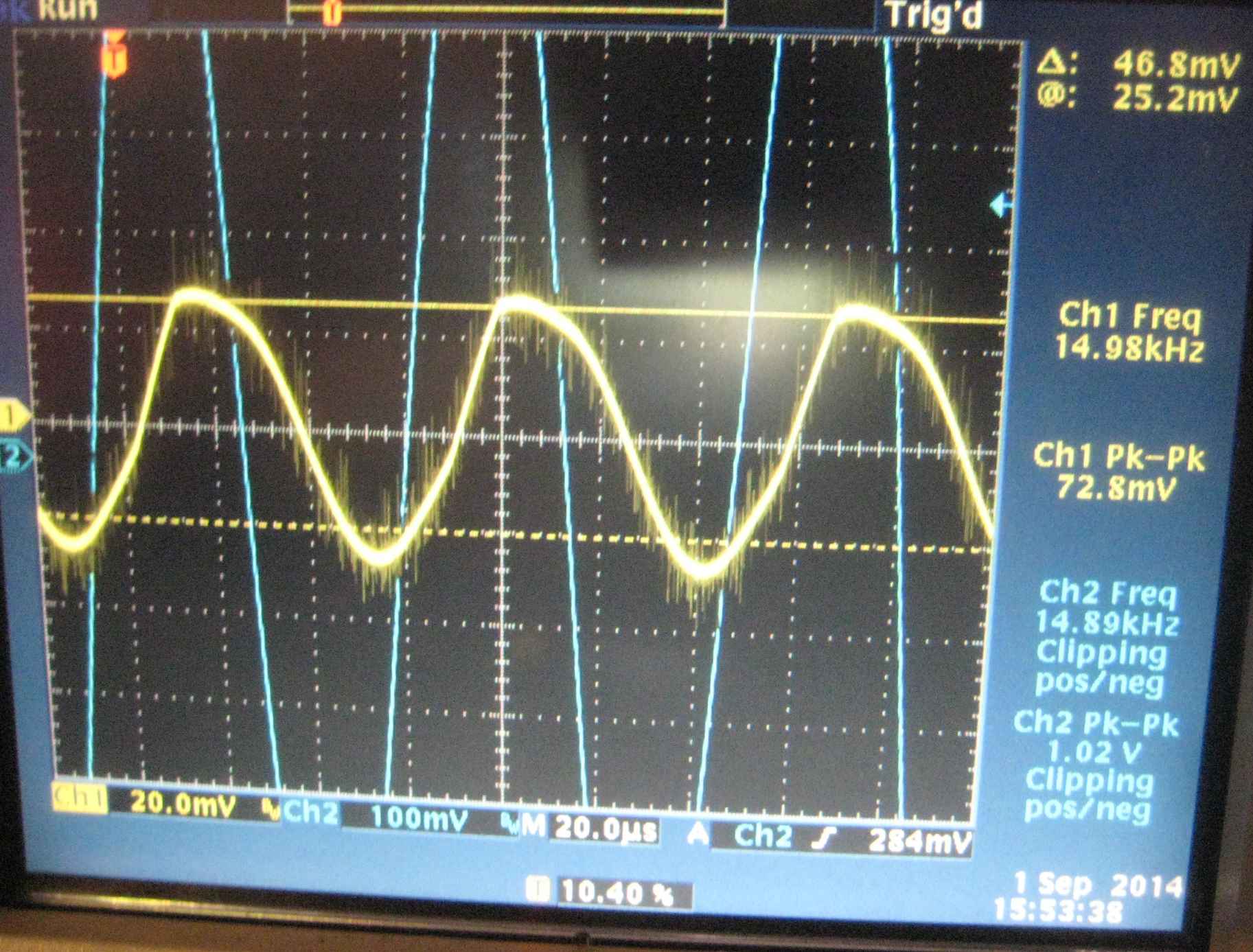

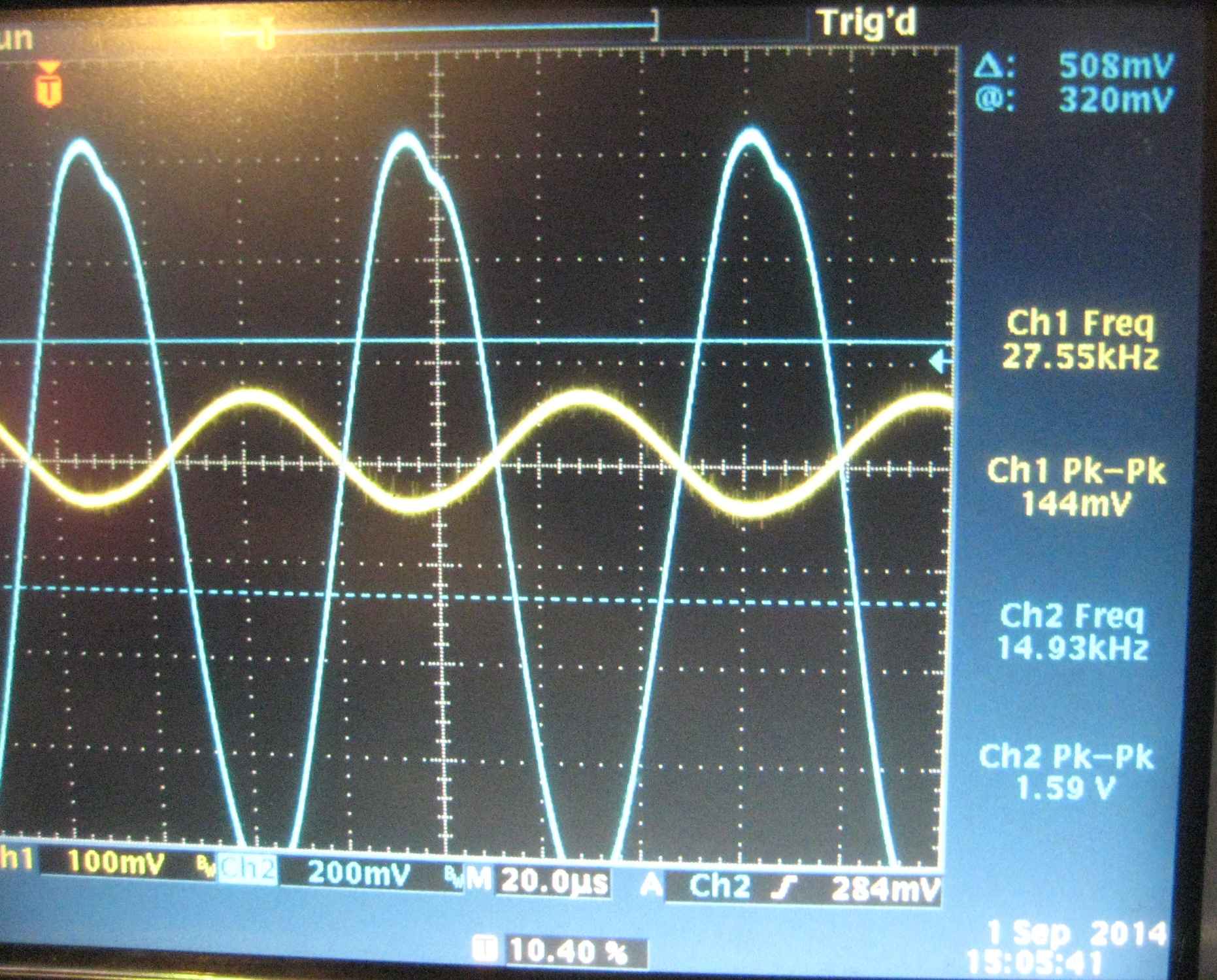

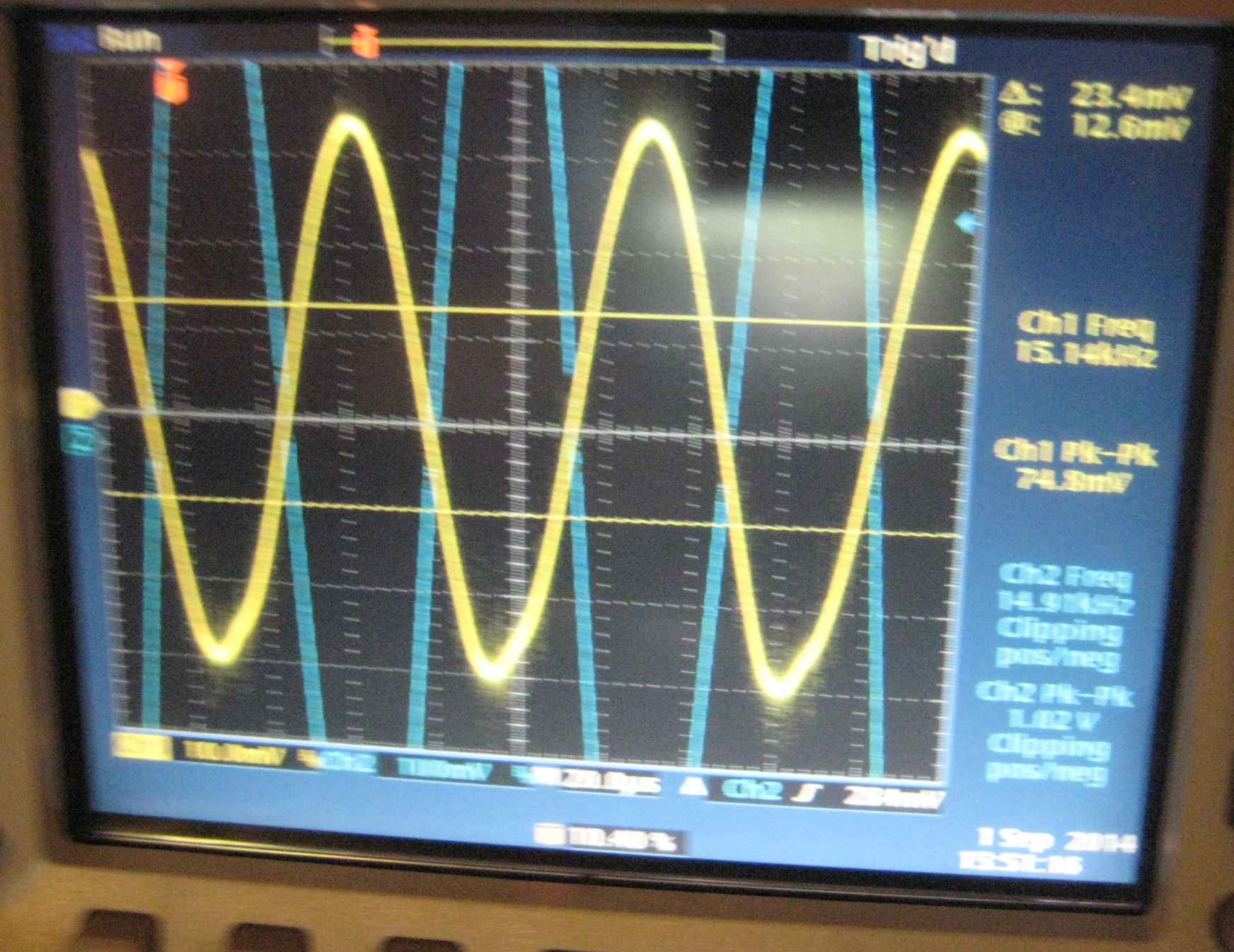

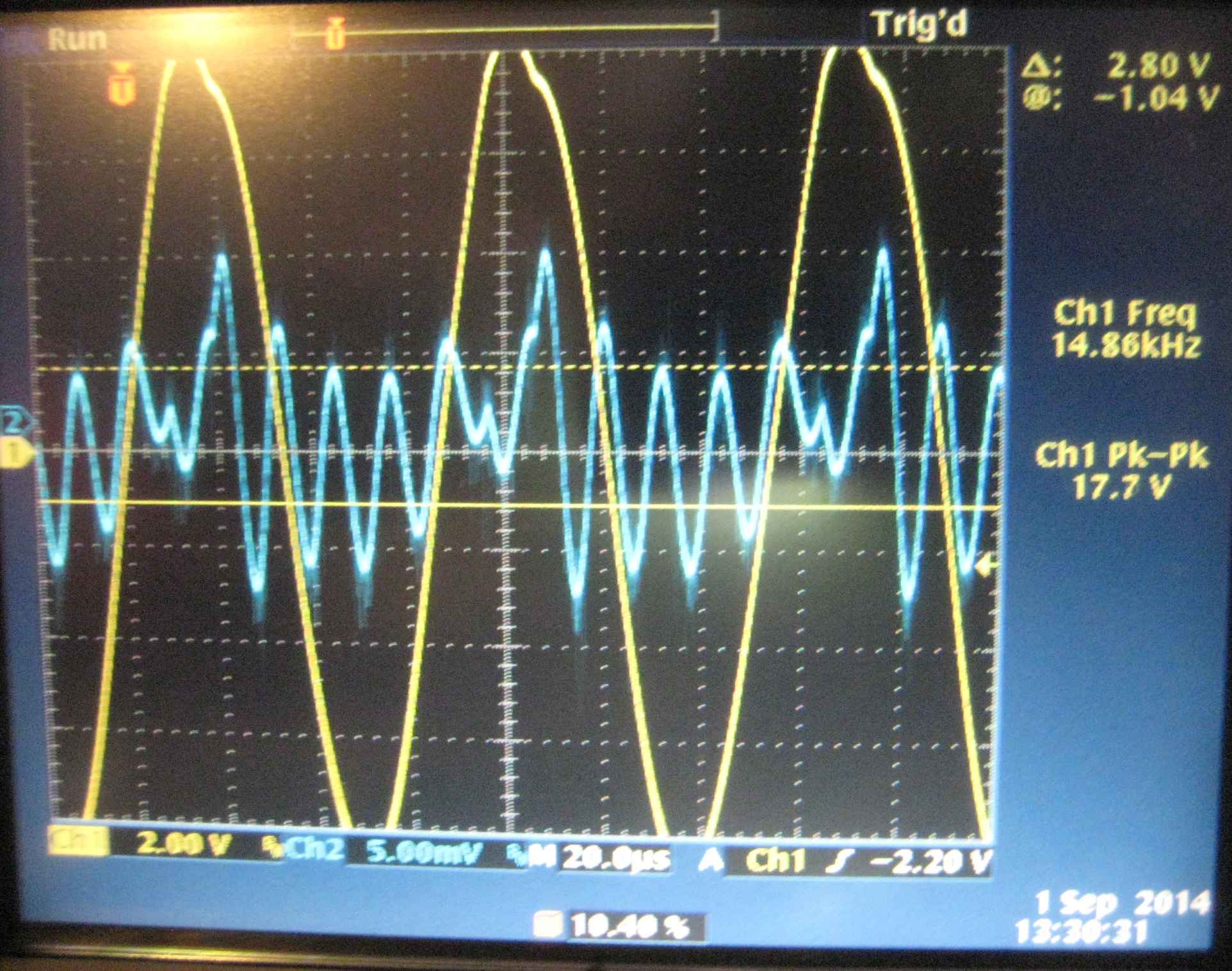

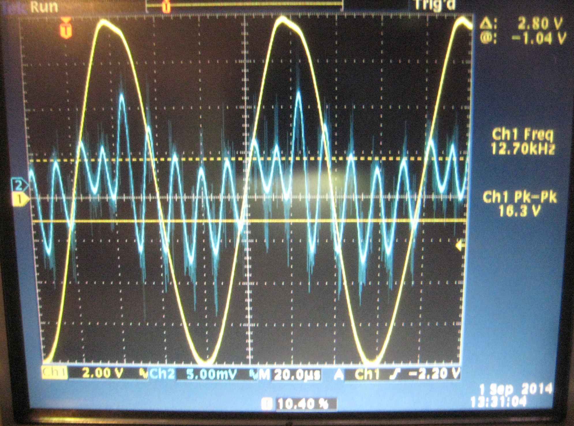

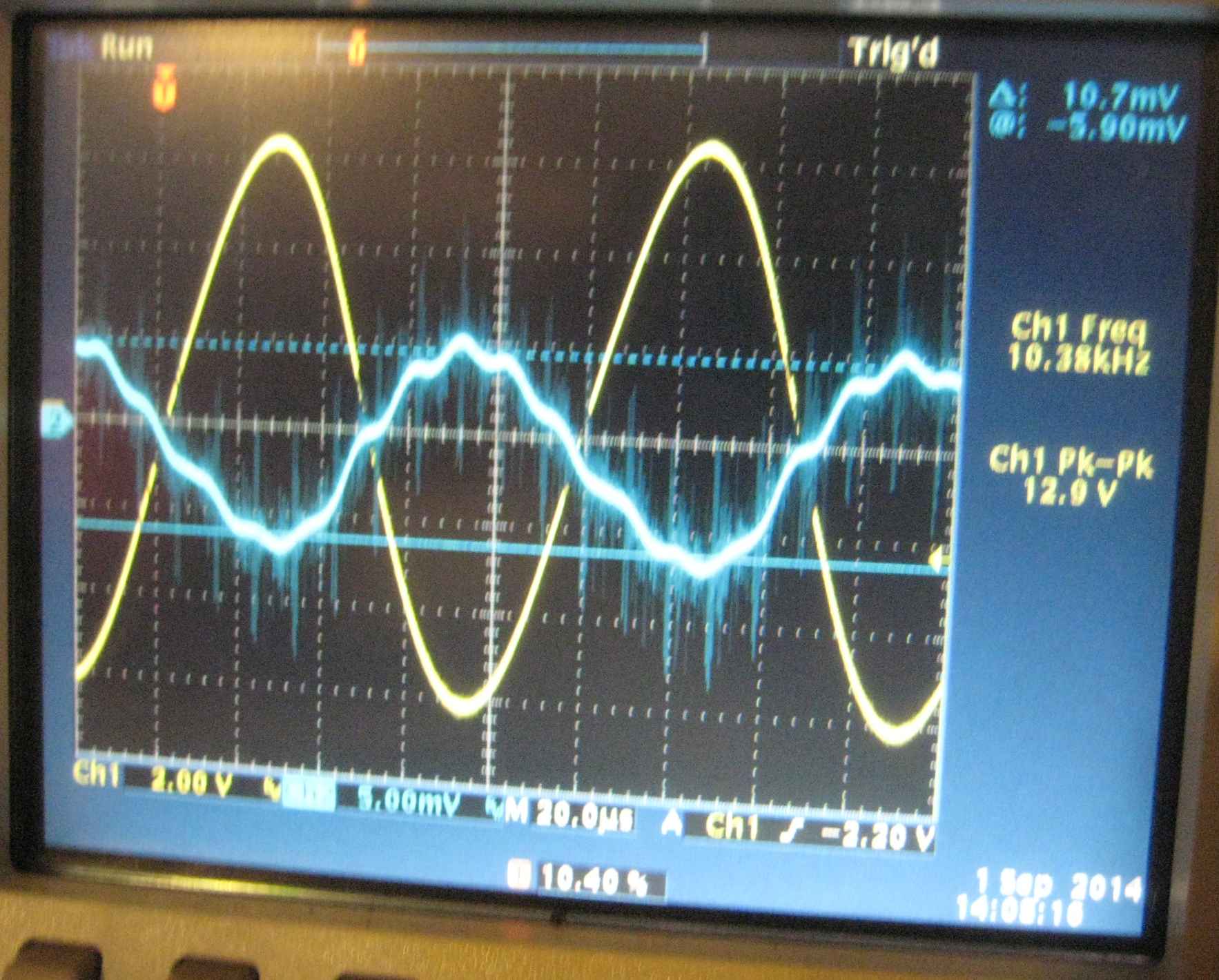

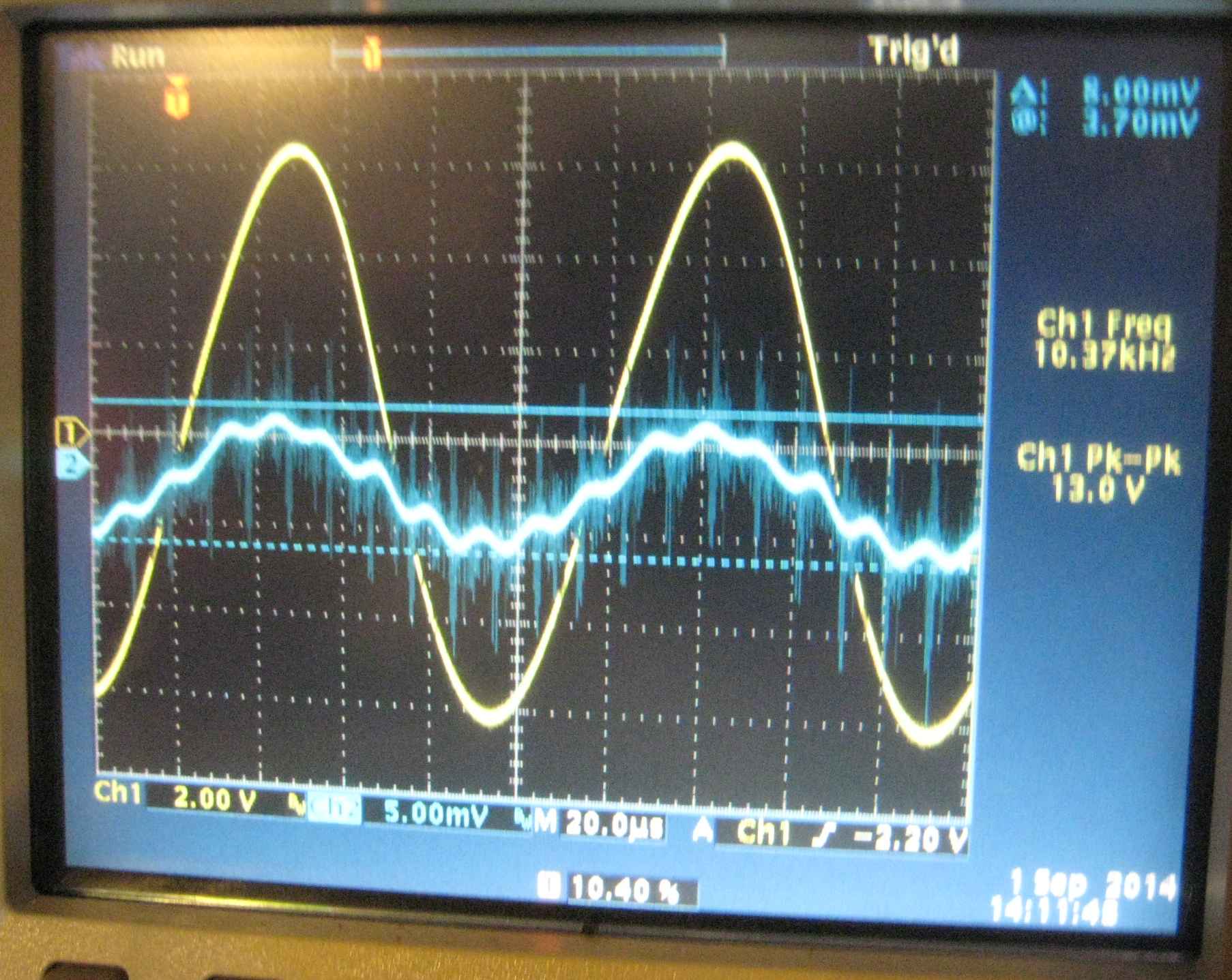

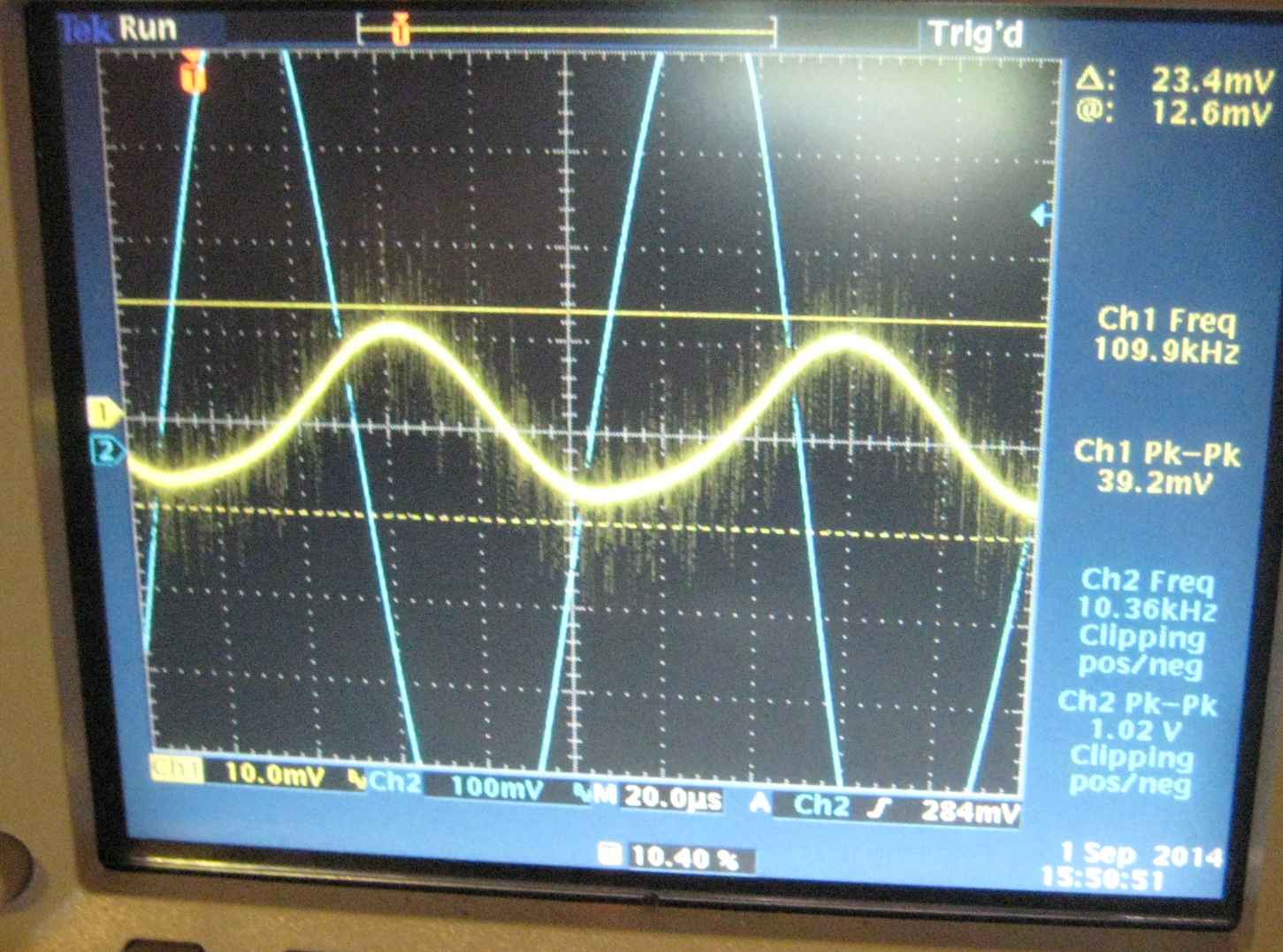

              It was very hard to tell the appropriate null point at higher frequencies. I connected the
              TFT to the TX and Buck coils and attached the second channel scope probe directly to the
              RX leads and obtained the following waveforms;
              10 khz (7mv p/p RX - Assume Nulled)

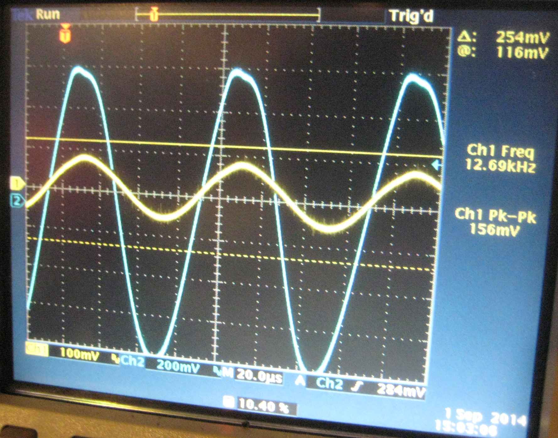

              12.7 khz (~20 mv???) - How to tell where the RX wave is?

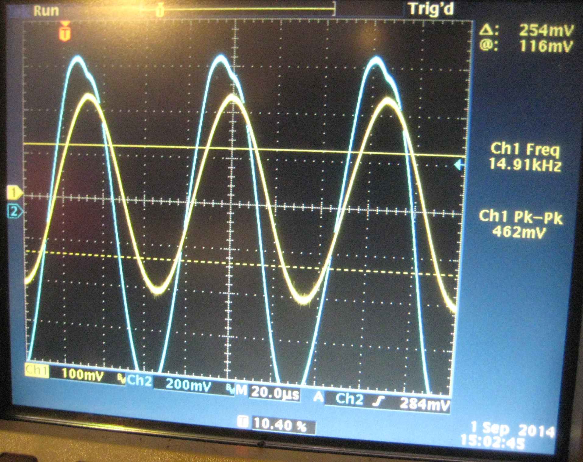

              14.8 khz Again how to tell how big the RX is?
              Maybe the scope probe is causing some ringing?

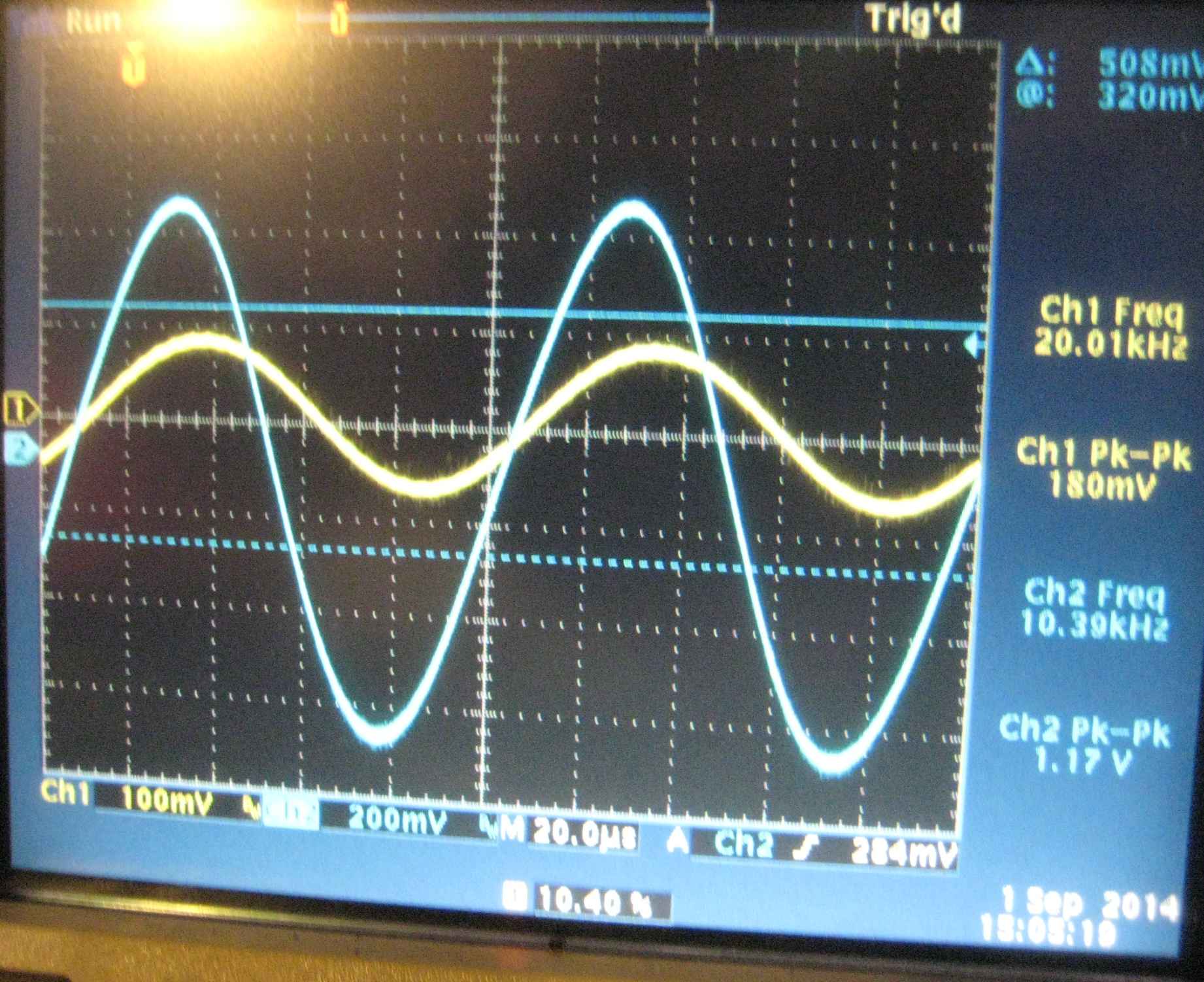

                  Well now I'm really confused. I remembered my second scope probe broke
                  so the scope thinks it is a 1:1 when it is a 10:1 so all my readings are off by 10x!

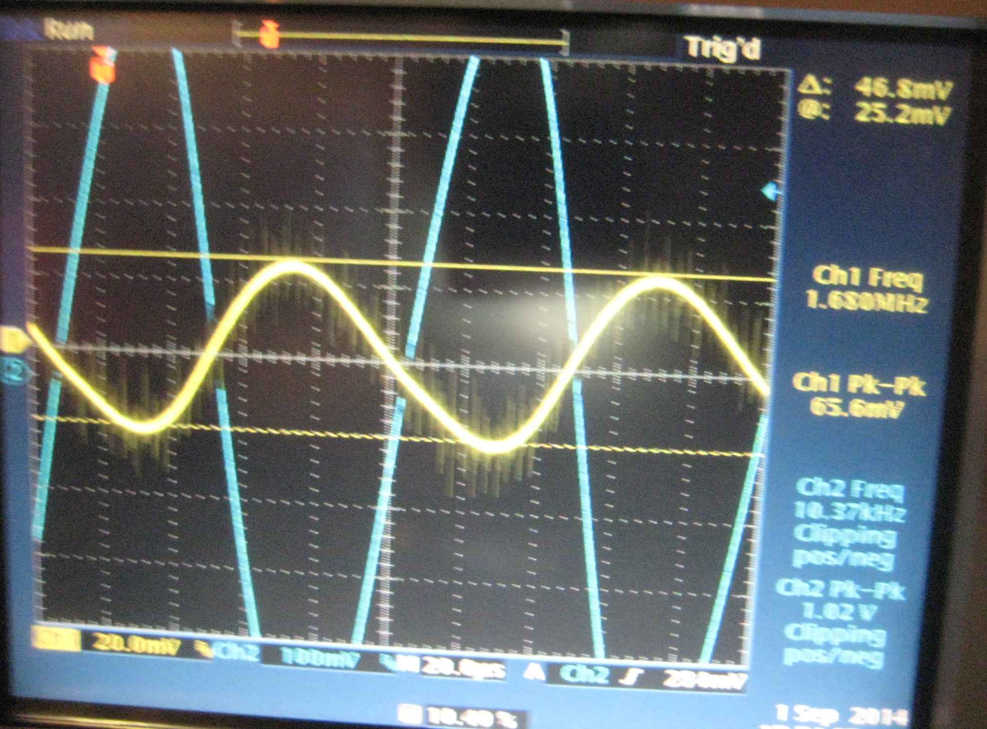

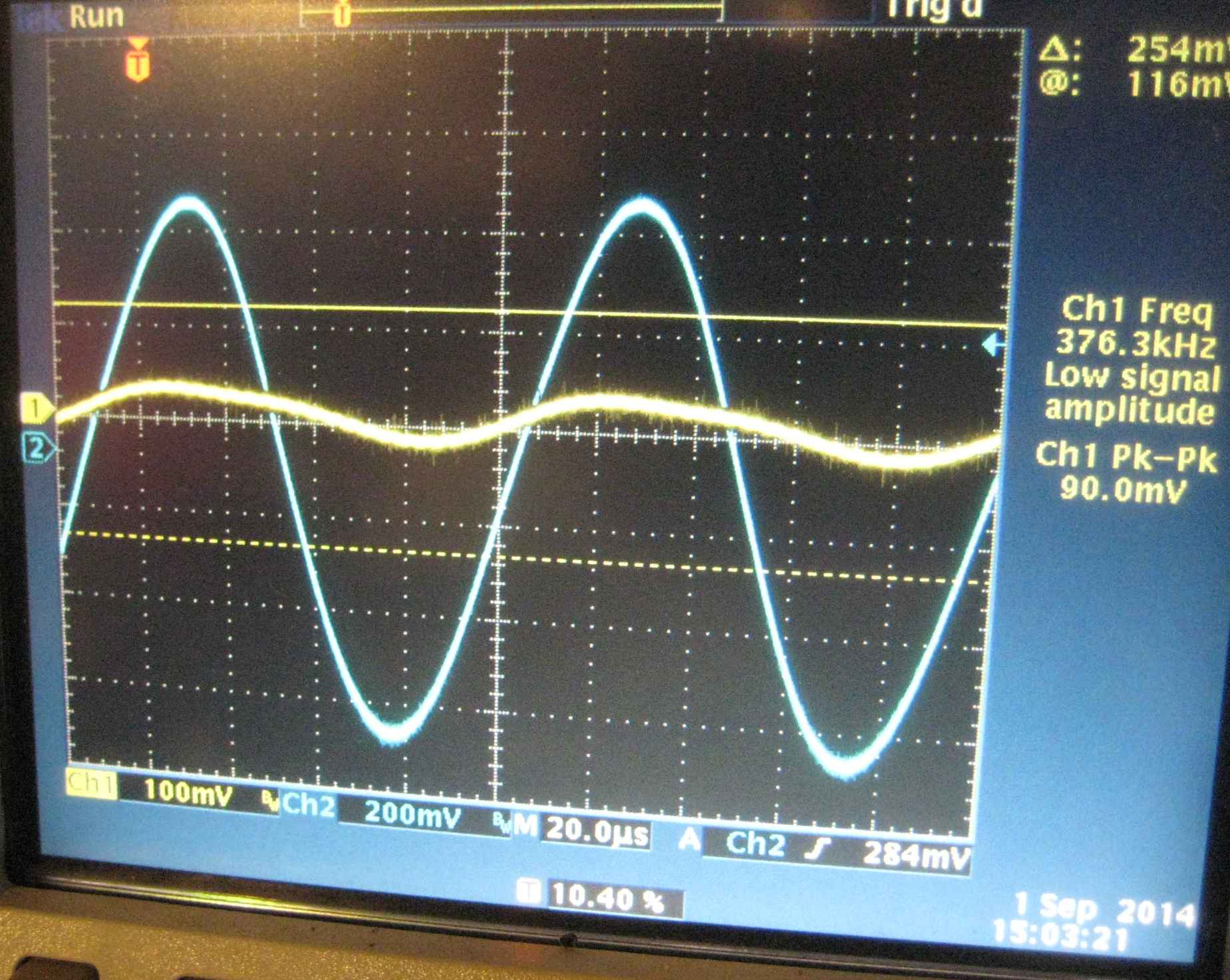

                  Also I decided to use a tuning cap to stop the ringing in the RX wave but what value
                  to use? I tried .015uf and .033uf with the following results;
Name:	10khz 015uf.jpg
Name:	12.7khz 015uf.jpg
Name:	15KHZ 015uf.jpg
Name:	10khz 033uf.jpg
Name:	12.7 khz 033uf.jpg
Name:	14.7khz 033uf.jpg

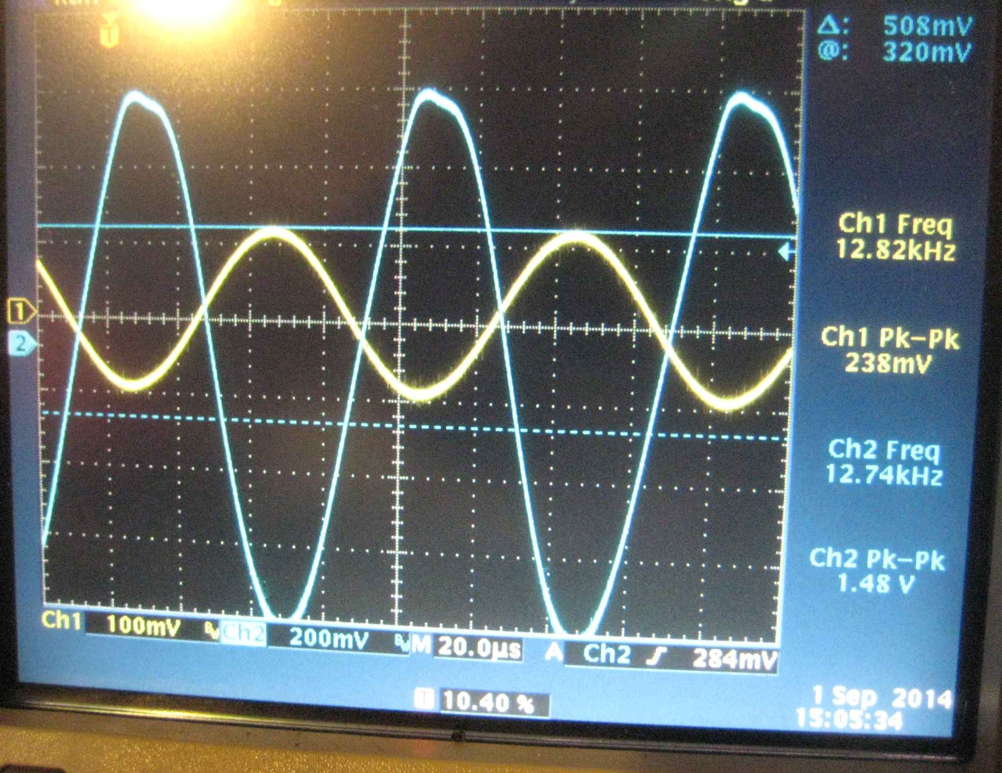

                  Channel 1 is the RX and the voltages show should be correct but remember these
                  are straight out of the coil with just a cap across it. I thought we were aiming for 4mv...

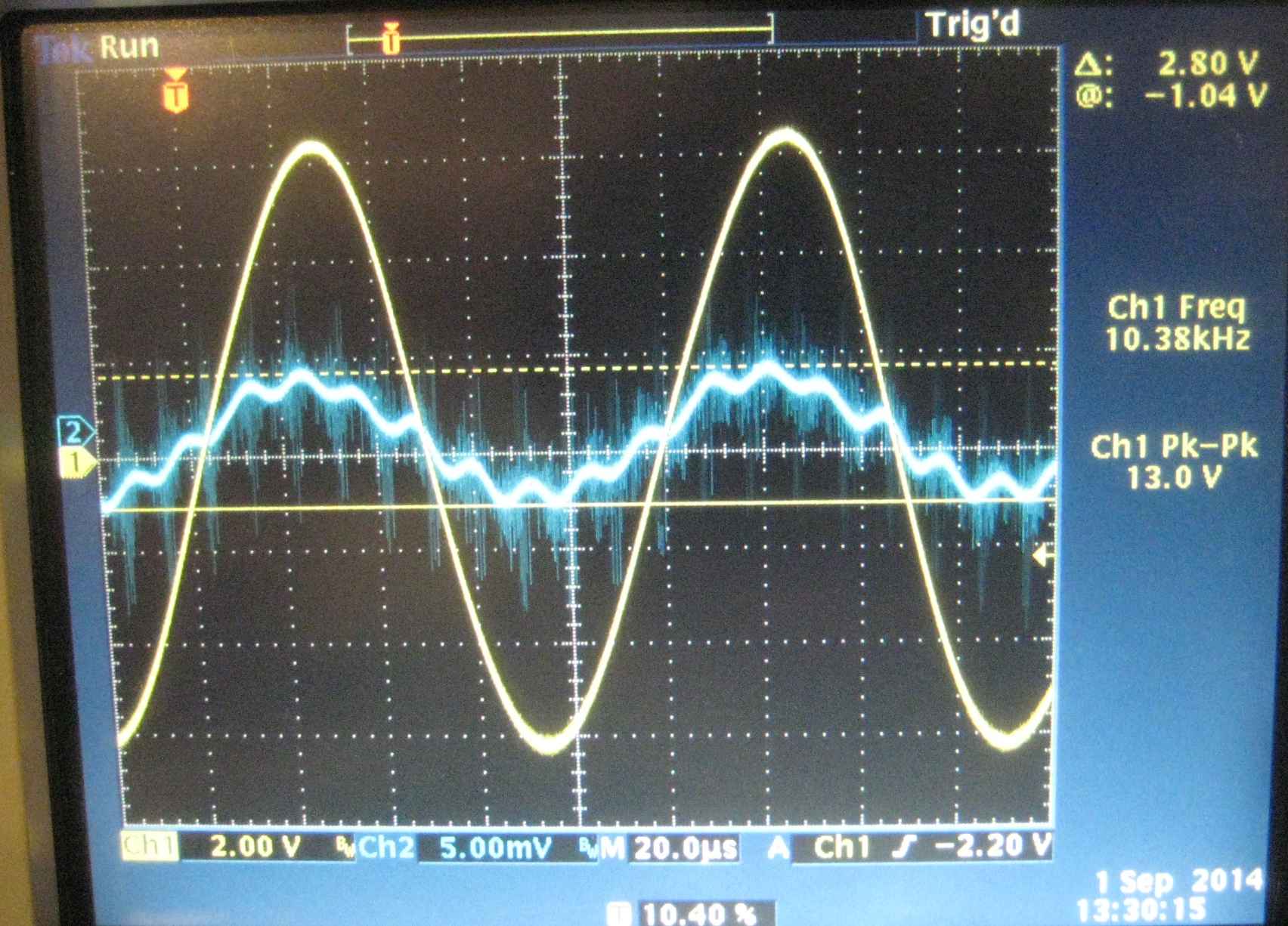

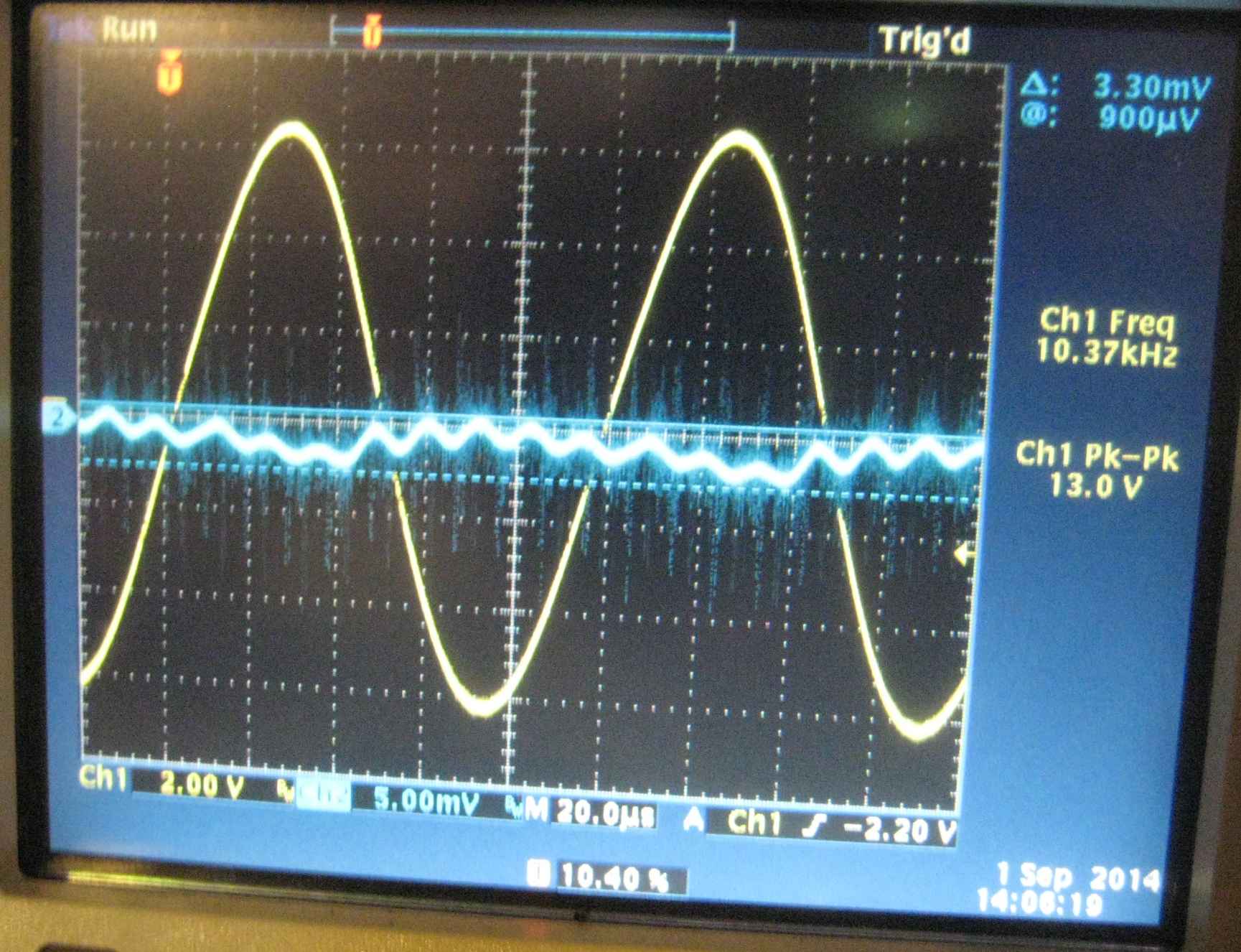

                    So now I tried tuning with a 015uf and nulling at 10k;
Name:	015 Tuned at 10k.jpg
                    Then checking at 15k;
Name:	015 Tuned at 10K Check at 15K.jpg
                    The null voltage doubled! So I tried changing the cap to 033;
Name:	Tuned at 10K Changed Cap to 033.jpg
                    Then renulling at 15k;
Name:	Tuned at 15k with 033.jpg
                    Then dropped the freq to 10k;
Name:	Tuned at 15k 033 then dropped to 10k.jpg
                    There is less change this way but I'm still concerned the null is never very low amplitude.
                    40mv x 44 gain of input = 1.7V...
                      Well I found a thread here that said to load the coil with 10k and .1uf so I tried that.
                      I also found that if you have the correct phase when you wave a piece of ferrite at
                      the coil the amplitude will increase but if the phase is wrong the signal will shift before
                      the amplitude increases. So I'm going with that for now. I still don't know why my null
                      is not very deep...
                        Well I got to thinking and realized I have a know good working coil in the original
                        brown Tesoro that came with my Bandito so I decided to see how it performs
                        using the 3 different frequencies.

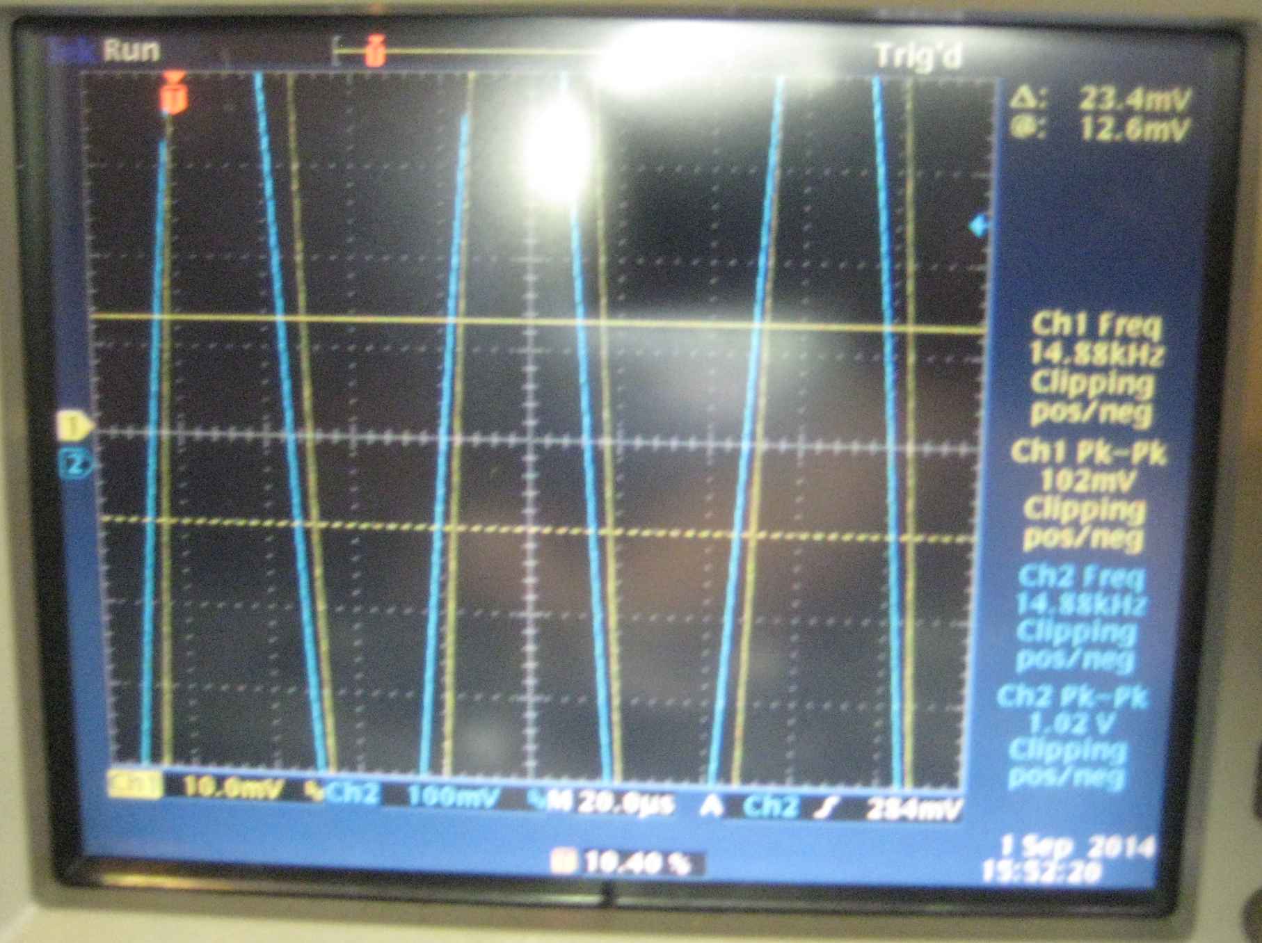

                        I used the 10K .1UF load but also tied the grounds together as they are in the
                        brown coil. I found that the Tesoro coil sits at low amplitude (2.25mv - 1.2mv
                        RMS AC) on the "other" side of the zero crossing. That is to say if you bring a
                        ferrite rod down to the coil you see the RX (in phase with TX) shrink and then
                        grow in amplitude with 180 degree shift passing through zero if you will.
                        TX - 10.4 khz 17.4V P/P
                        RX - 2.25 mv RMS - Clipped 46 mv RMS - Clipped is with the ferrite fully centered in the open hole in the coil. Max Amplitude if you will.
                        TX - 12.7 khz 19.1V P/P
                        RX - 1.7 mv RMS - Clipped 42 mv RMS
                        TX - 14.9 khz 20.2V P/P
                        RX - 1.2 mv RMS - Clipped 32.4 mv RMS
                        With the Fisher 440 11" coil I could not get all 3 to the "other" side and a low amplitude. Also the clipped amplitude was around 7mv
                        though the coil didn't allow the ferrite to be centered as no center hole...

                          Well I found if you null to the highest frequency you can get 14 mv p/p at 10 khz
                          and 4 mv at 12.5 khz. I've seen these numbers quoted for the residual volts on some
                          factory Tesoro's so it seems they are in the same boat.
                          I still do not know which side I should be on. I was thinking I should be where a ferrite
                          brought into the center of the coil causes the RX voltage to go through zero then gain
                          amplitude but if I wave a gold ring at the coil I see increasing amplitude with no phase
                          shift.
                          Some claim that the residual RX voltage doesn't matter as long as it doesn't saturate the
                          preamp. The factory Tesoro does shift through zero but what frequency was it tuned too?
                          And is it the best tuning for a coil at a fixed frequency?
