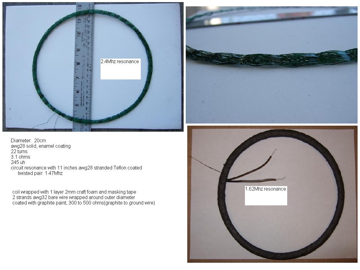

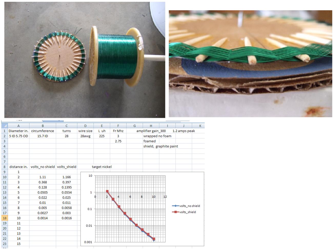

    I'm still trying to use my spool of 28awg magnet wire I purchased probably 40 years ago. I tried a coil today. Don't know what the winding is called. I think I've seen it on the site somewhere. Mostly I've seen spiral, basket and bundled winding. Are there negatives to winding this way? The coil inductance is lower than I was trying for. Including some test data. I had to redo the shield and need to test for shielded resonance and do a little more testing. So far I think it looks alright.

          Thanks for the reply. As you can see from the photo I have enough wire if I can make the magnet wire work. The shielded coil resonance for the test coil is 2.14 Mhz. Reading "Making a Fast Coil" a 300 uh, 10.5 inch diameter coil made with Teflon coated wire would have a resonance near 1.25 Mhz not shielded and 1 Mhz shielded, coax not connected. Are those good numbers or should the resonances be higher? Think I need to try a 10.5 inch diameter, 300 uh coil and would like resonance numbers to try for.

                      Hi Green, your coil is similar to a spiderweb coil which was normally wound on a 9, 11, or 13 slot form which gave it a flat coil appearance. I wound a few of these in my crystal radio days. You wound yours on a 31 pin form then removed the pins. This was then referred to as a diamond weave coil as viewed from the edge it shows the diamond shaped openings. The idea is to reduce the self capacitance by having less paralleled wire surfaces and no form material supporting the winding. Here is an interesting website on old radio coil types;

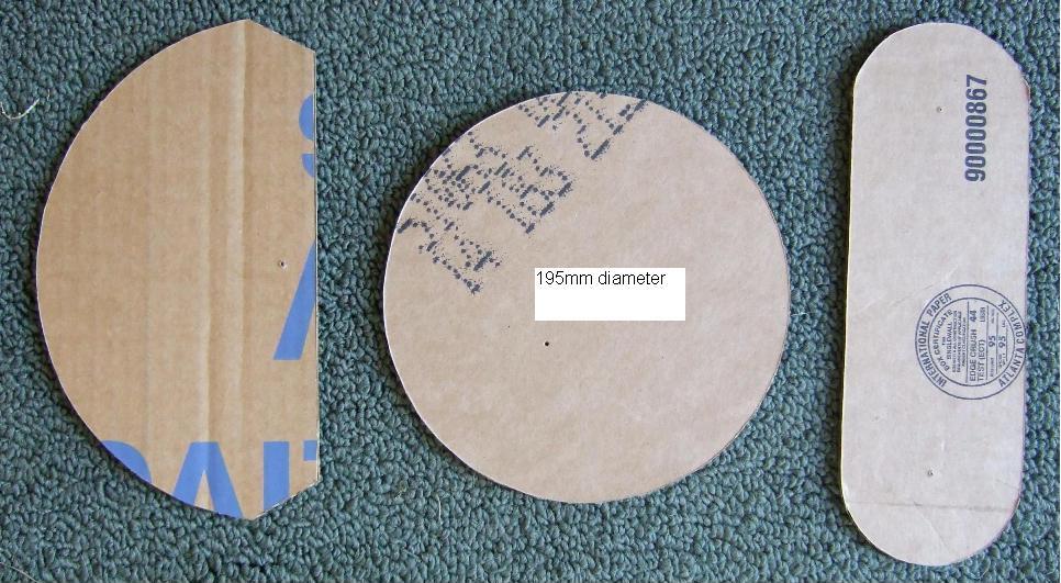

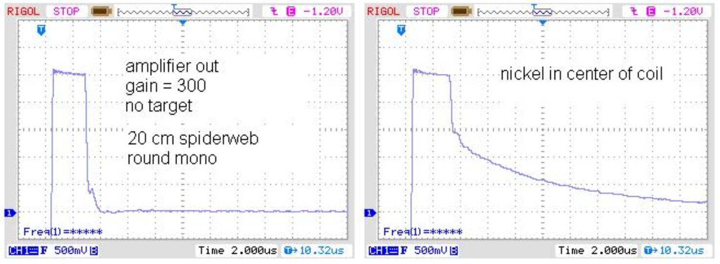

                          scope picture of 20 cm spiderweb round coil. R damping 1000 ohms

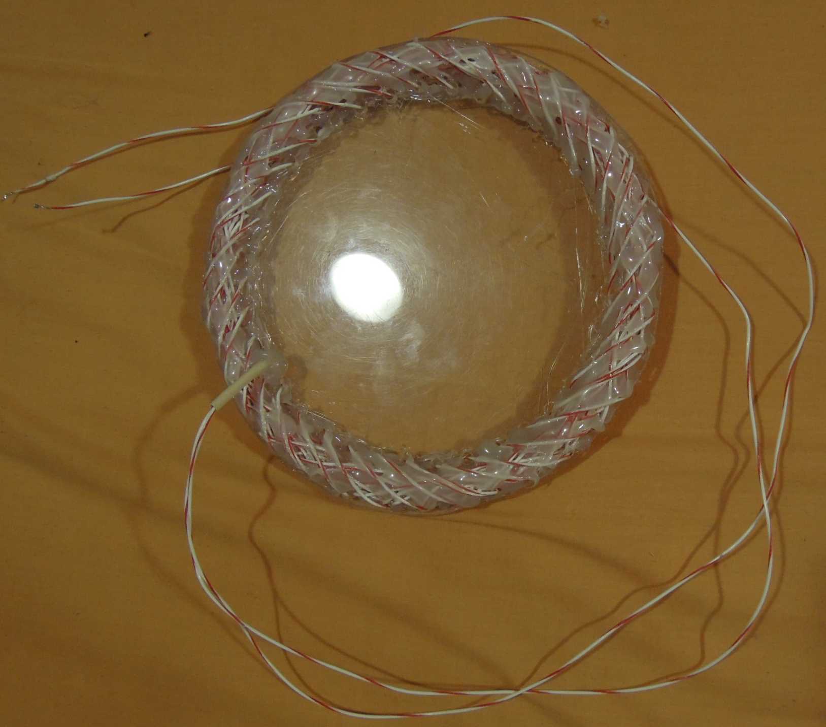

                            Silver Dollar, how to make basketweave coil?
                              I followed this guide but used two rows of holes. It should have been enough room but I had to
                              add some more in a third row to finish the wind;
