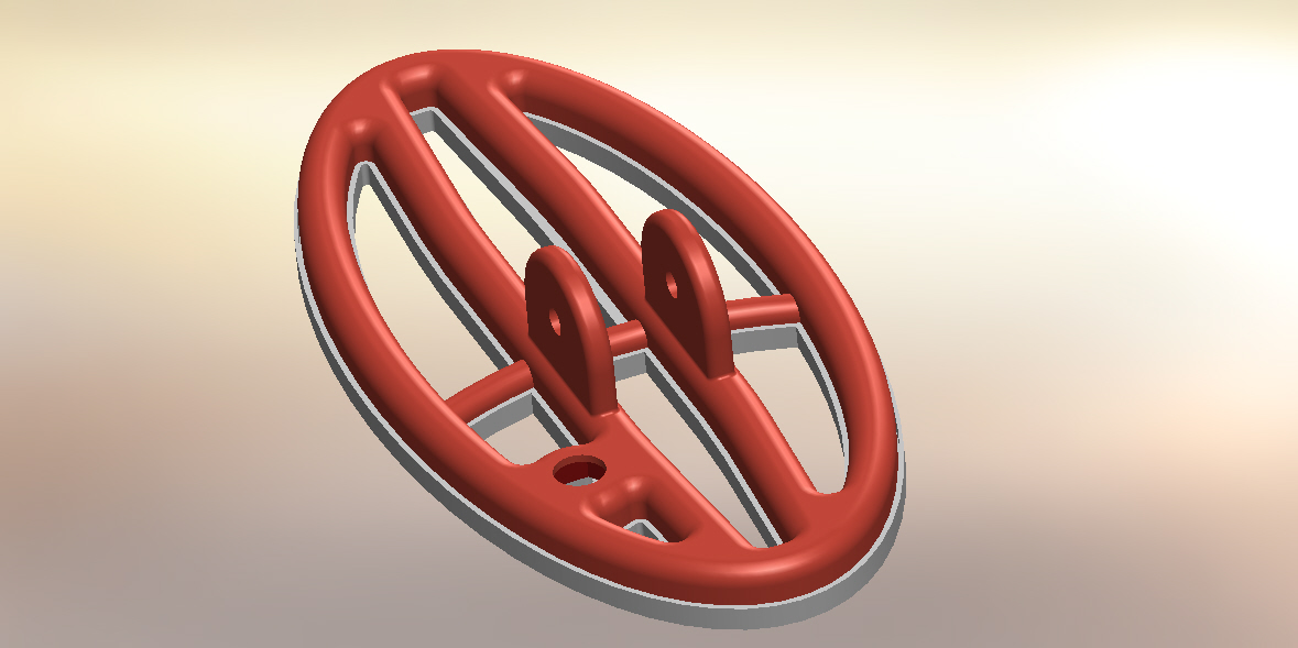

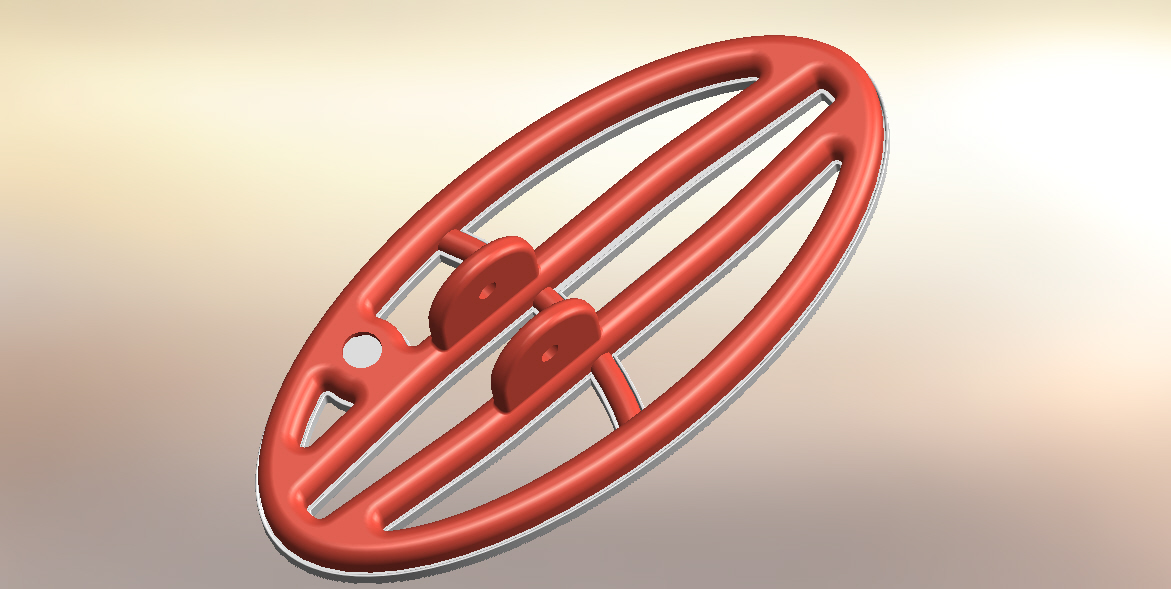

      Here is a pic of my latest coil Housing, conventional slim line design for thin enameled wire coil only, clip on skid plate similar to Coiltek coils, minimal plastic, designed to be epoxy filled for maximum strength and water proofing, fast print times, great strength in ABS, narrow design for small nuggets and trashy area picking, hollowed through center with a strengthening bar that stops at the exact center point for accurate pinpointing, ultra light weight, 240mm x 115mm x 12mm thick with skid plate, looks good to, here is a 2 pics, note in these pics the skid plate is not actually clipped on so it's thinner than this when clipped together, skid plate is just sitting below housing at the point where it starts to clip on, I have printed this model in these colors and in ABS and its looks really good so far, print times upper housing 5 hours, skid plate 1hr50mins @ 80mm per minute print speed, 0.2mm Z increments, 0.5 mm nozzle. I am about to put a coil in this, epoxy fill it and then try some beach tests in water.
