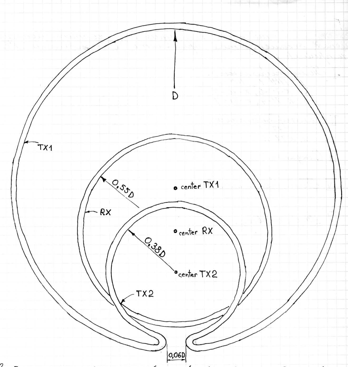

    I'm planning on making a "DD" coil for a PI detector and can figure the inductance for a circle
    but how much will it change when formed into a "D". I saw that info one time but cannot find
    it now.
    I'm also thinking of making an Omega coil for the IDX. How much will the TX change when
    bent into the Omega shape?
    For the D-shape, the best result is obtained by finding the average of the two radii and taking the mean value. In other words, take the length of the straight edge and add it to the distance across the middle, then divide by 4. Use that as the radius value to enter into the coil calculator.
    The omega coil is more tricky, since the folded-back section subtracts inductance from the larger loop. Without knowing the mutual inductance between the two, it's difficult to estimate.

        Maybe you're thinking of Henrikras' experimental small Deus coil thread, where I suggested some adjustment factors.
        I would say that the 'semi-circular' shaped coil (that makes up the common circular coil assembly) gives only a modest drop in inductance from the circular shape. A figure to work with is: about 97 - 98% of the inductance of a circular shaped coil of the same circumference.
          You´ll see more change by compacting a coil than squeezing it into a D shape. The closest you can get by inductance estimation is by mere wire length for an equivalent circular coil.
