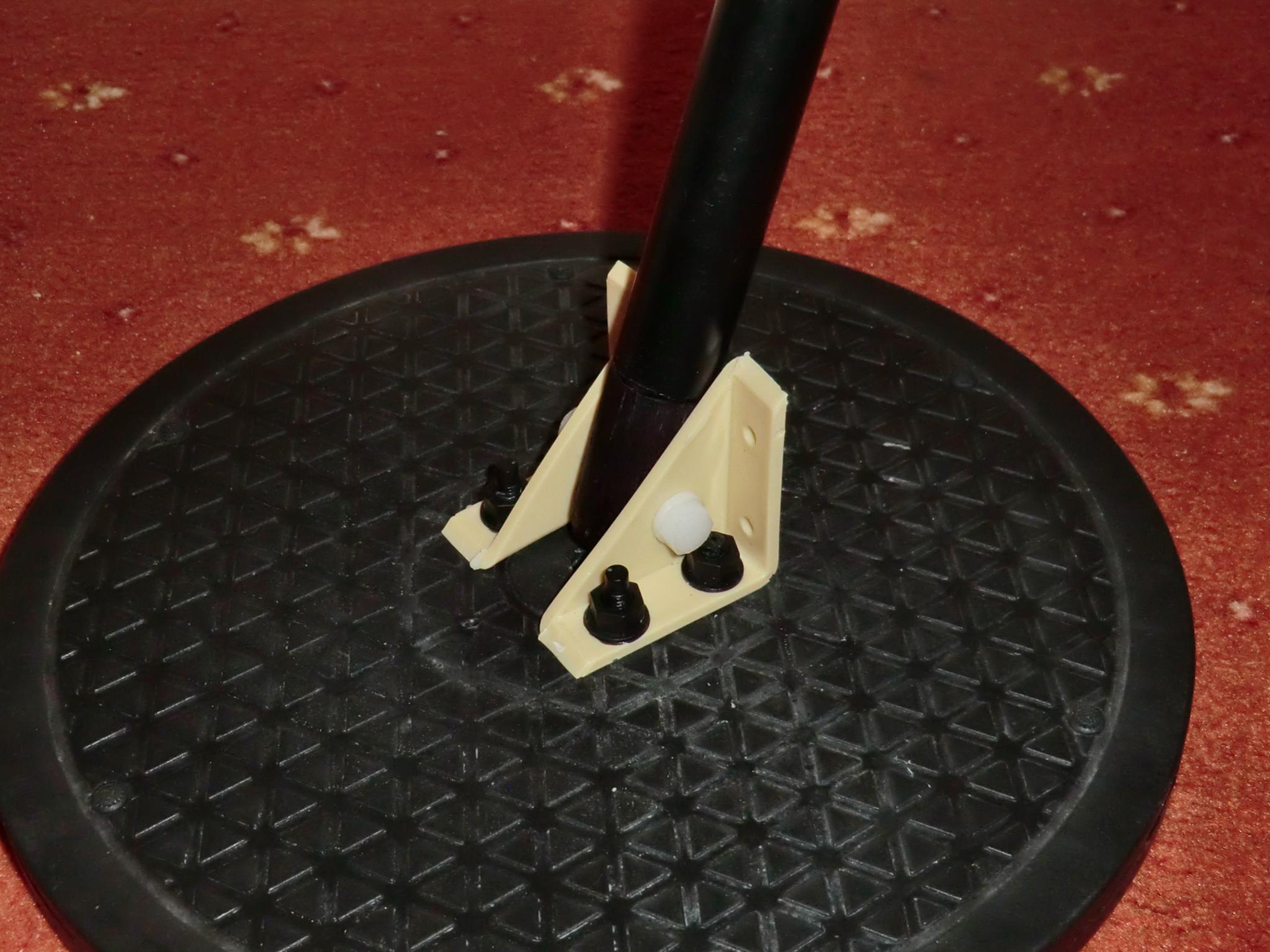

    Hello to you all, having worked my way through building the PI detector and having built a coil or two for testing purposes I was left with a coil housing dilema so here is my present solution. It is a cake decorating turntable, it came with some form of bearing ring inside which was discarded, there is plenty of room inside for an 8" coil and it just pops open when gently splayed. I got some number plate fastenings and some 90 degree shelf brackets. The finished result is here. Click image for larger version
ID:	369168 inside and outClick image for larger version
ID:	369167 I hope this is found to be useful.

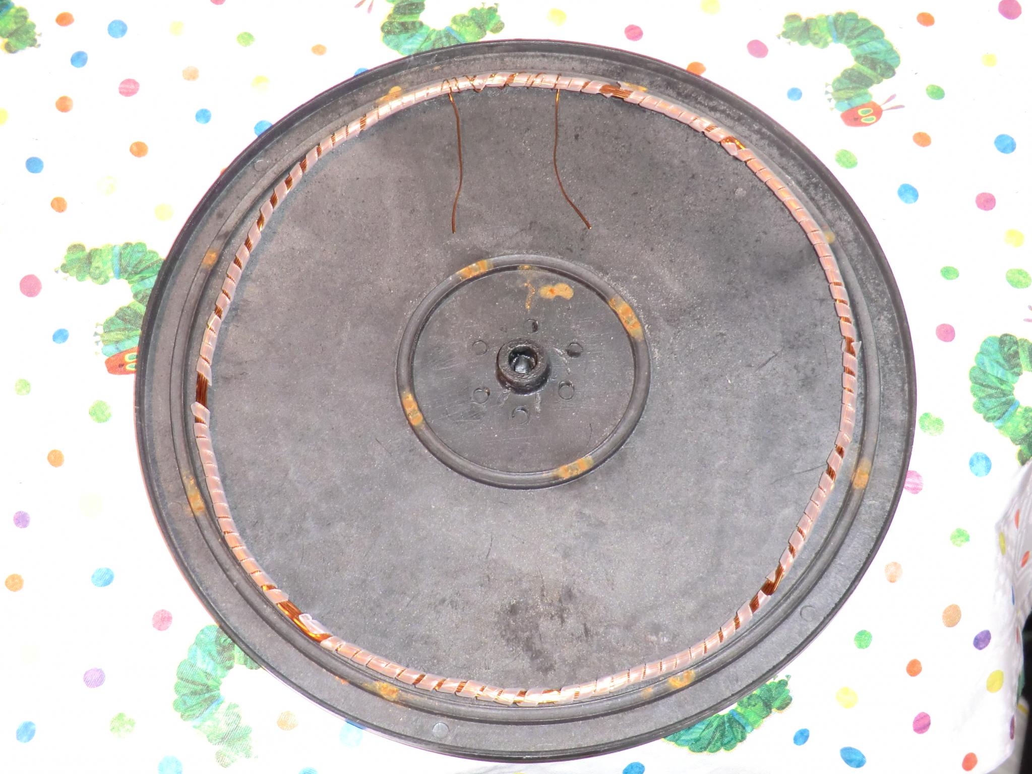

    What did the cake decorating turntable look like before you modified it ?.
      Hello it is just 2 flat disc's, joined in the middle, all I have done is take out the bearing ring, it is a plastic/flexible material, it should be unbreakable in normal use. Click image for larger version
ID:	342245 it is about 1.5cm thick and 25cm wide. Bought via "E by gum Bay"

          Hello Smugwimp, My knowledge of coil building is just mine and what I have read on the forum. I have based my coils on low inductance and kept them to a reasonable size, because of an unsure housing plan. I have wound 4 coils all with .5mm enamelled copper one was scrapped because of my poor technique on coil number one. I have 16 turns, 24 turns both about 200mm and a 24 turn coil which is about 240mm. The size was decided on by the cake icing turntable that I bought to house the final coil. I have only done indoor air tests and the interference I have is not good, I did a single outside test to check the interference went away and left it at that. I have as yet have not completed the build fully as I am undecided as to what the best feed cable will be. Screening has proved a complete mystery to me as each time I screened the coils they stopped working and only continued after removed the screening. As far as I know a large coil makes a bigger field and should provide more depth (I am NOT an expert and could be completely wrong) What is the coil resistance? is your coil an ohm or two? what is the calculated or measured inductance? (I am waiting for an LCR meter as I write) I assume you are using a Surf PI 1.2? Is your feed cable high capacitance? can you replace it with a tested pair? have you tried twin screened audio cable. It may (this is me talking now and could be rubbish) be that a small capacitor inline with the feed cable may improve the signal (or stop it completely), as capacitors in serise reduce the overall value, it is the opposite of resistors in parallel. I hope this gives you something to point you in the general direction of success. Regards.

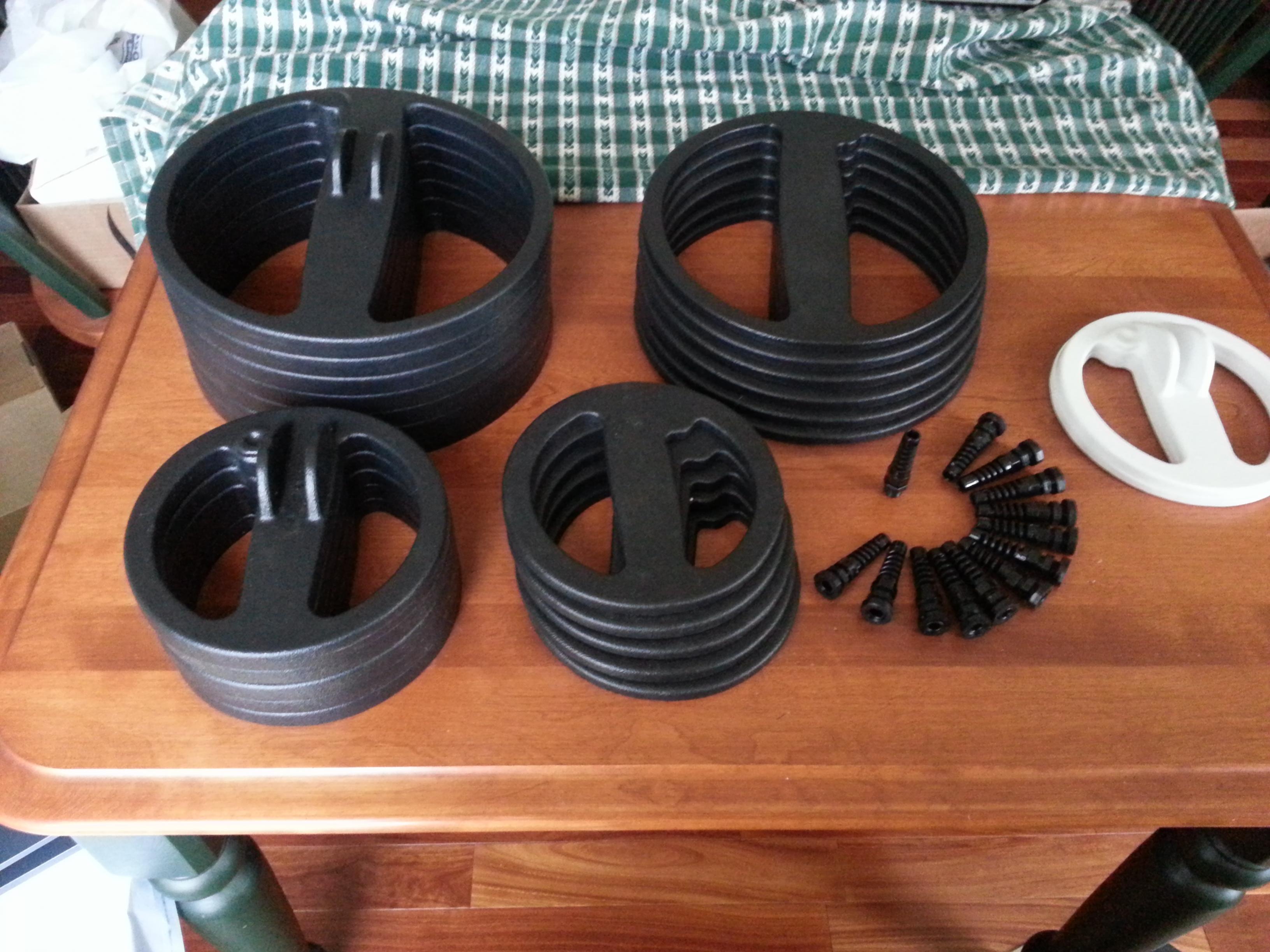

                        I have about 1/2 dozen each, 7" and 10" shells with or without covers ready to mail if anyone is interested. It would make a nice finish to all those Surf PIs. They are great in the surf when epoxy filled! See link below for details.
                        Don
                        https://sites.google.com/site/dbcoilshells/
