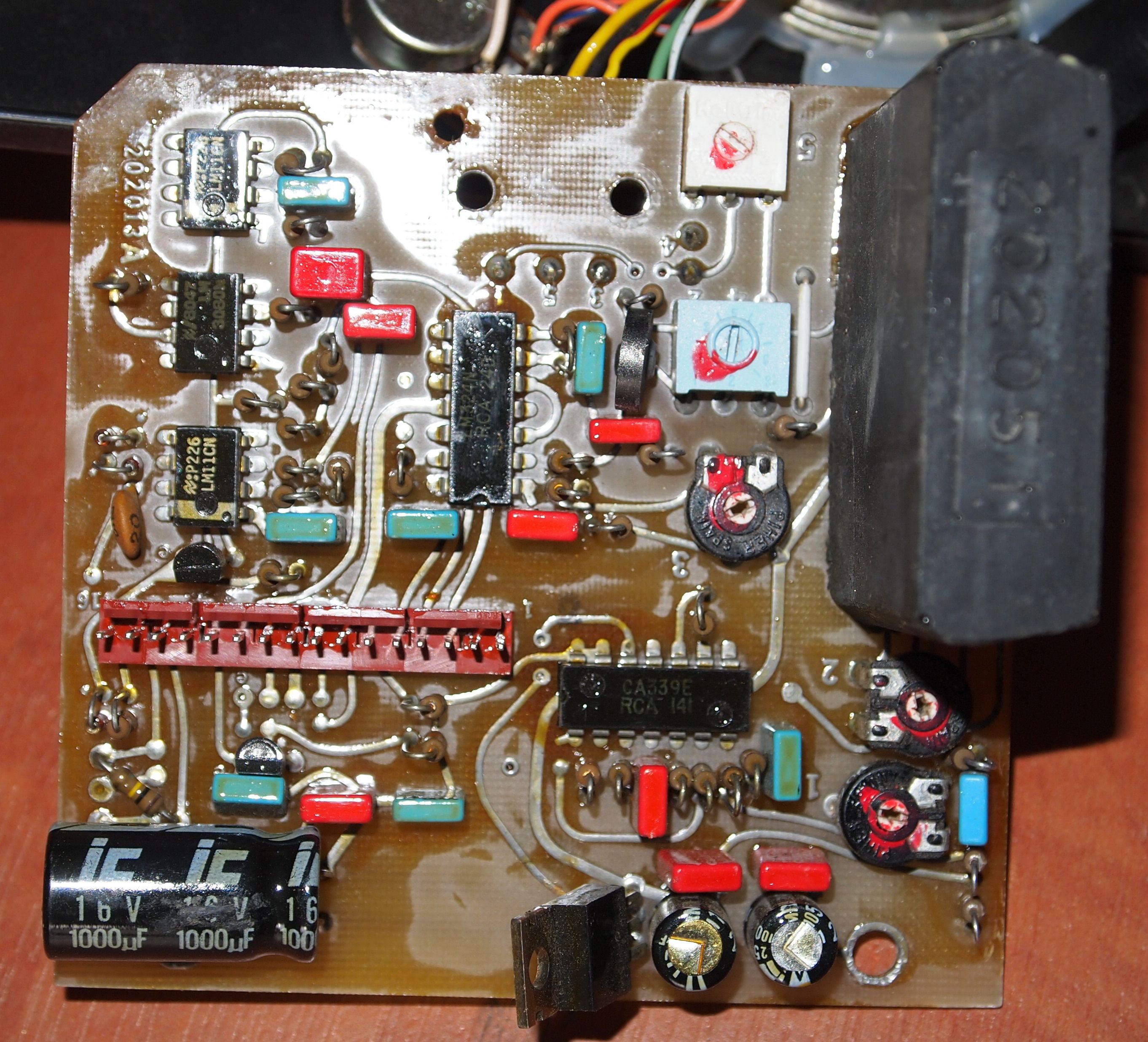

              Few pictures:
                I have a 1220X as above which coupled to a 3 and a half inch coil is now what converted to use as a discriminating probe. What is the large black component on the right of the first picture. I've never seen it anywhere else.
                  I wish to know that as well. I though it's just a piece of plastic protecting whatever is inside. But it can not be removed. So, you mean you don't have this in yours?

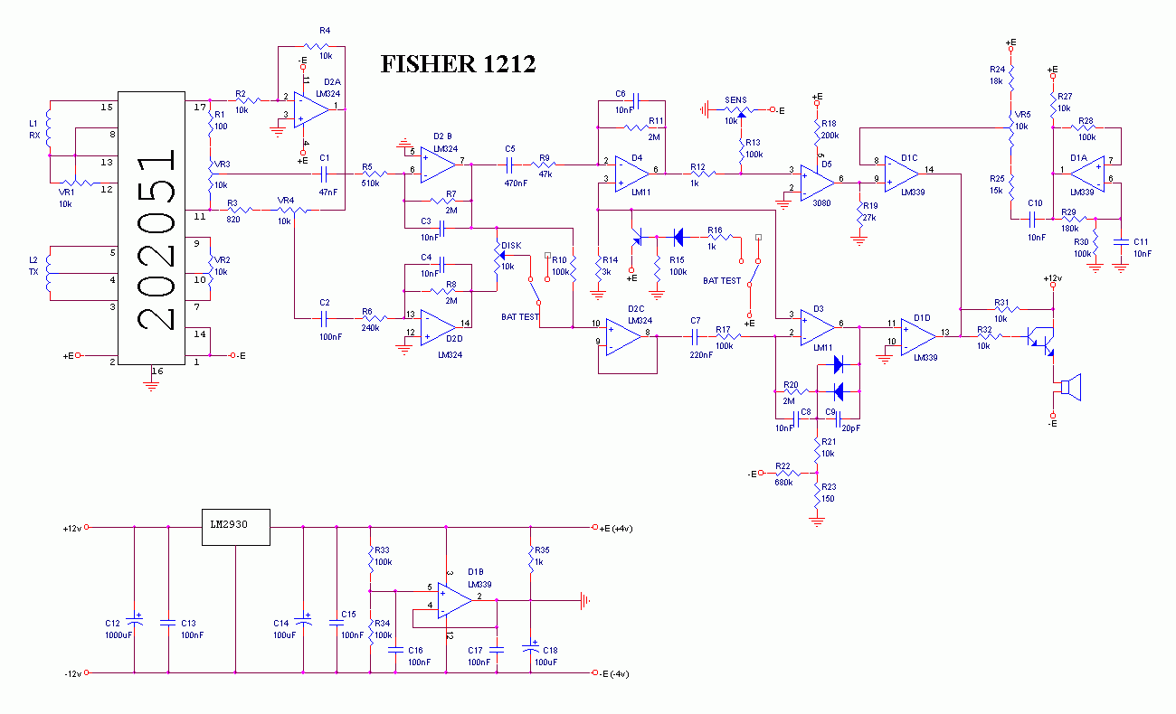

                    thank you much m23785 for the nice hi res pics. large black block is some kinda a protection from coping, IMO. it has a part of schematic. I see the similar block in 1212x schematic.
Name:	Fisher 1212_sch.gif
                      Yes, my 1220 has this huge component inside, roughly 2" width X 1 and a half inches high. Looks as though it is an IC judging by the schematic. Is it an op amp which is now obselete. Originally made by Texas Instruments part 3606 BG. I meant that I've never seen it in any other detector or anywhere. My 1220 had a piece of wood inside of it as well, I remember. I was the first one in my club to get one of these new "motion" machines and I cleaned out the site of hammered coins the first time I used it. By the second week though, loads of members had bought similar, so my advantage was short lived.
                        The "huge component" is the front end board, which contained what we regarded at that time as trade secrets so we potted it in epoxy to keep it from prying eyes. It was eventually dissected anyhow and the schematic published, probably here.

                          Think it helps if you replace the old electrolyte condensers with fresh ones.
                          Especially those with the yellowish shine nearby the large transistor or what it is looks bad.
