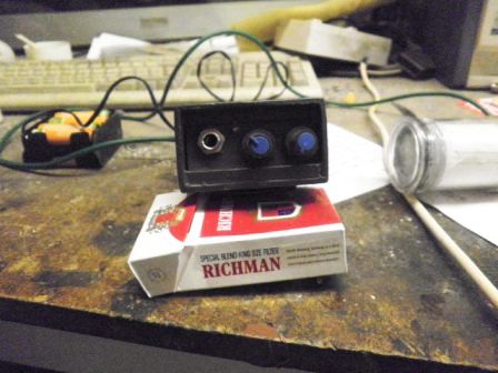

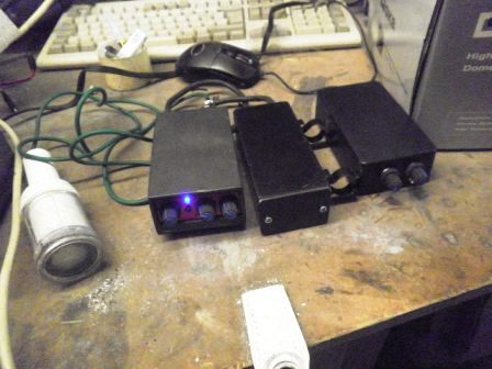

    This set-up would fit the bill for your job, Have constructed 7 to date, 5 of which have been sold to customers, so proved repeatable construction keeping to tight specifications hence performance.
    This design is PI format, non motion, with hi/bright blue visual led that mimics adjustable threshold output as like the audio.
    Working voltage 9V-12V DC with built in reverse polarity protection.
    one set of 8 AA or battery Pk full charge will give 2 days life on typical use.
    The actual coil shown is 1.5" O/D which is, installed into the coil housing then sealed.
    The stem is standard small bore waste pipe, stem length up to 2.5meters/ 9FT long, the coil cable feeds through the stem so as not to get damaged and plugs into the belt hip mounted detector housing via standard type whites 5 pin plug/socket.
    Metal presents indication is via standard HI-FI headphones or LED or both.
    Power is via either Rechargeable Battery pack or dry cells which are also hip mounted and connected via a lead terminated into DC plug/socket
    My tests were done using 1.5" coil as described on typical pasture land here in the UK which showed good indication at 6.5" with a buried 22ct solid gold ring. Second test was with a 1929 solid silver 6d coin which came in at 6" loud and clear.
    Its PI design cloned from original Barracuda design , constructed with precision value components.
    The main project was posted here in the early days but since added enhancements such as delay fine tune etc.
    I normally use this particular design for finding and tracing underground electrical cables although with the 8" coil connected it makes a good deep seeking relic detector.
    Pictures shown are pro types one of which was built into a housing built from cut up and glued scrap plastic, second and battery housing was bought from Farnell
