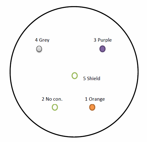

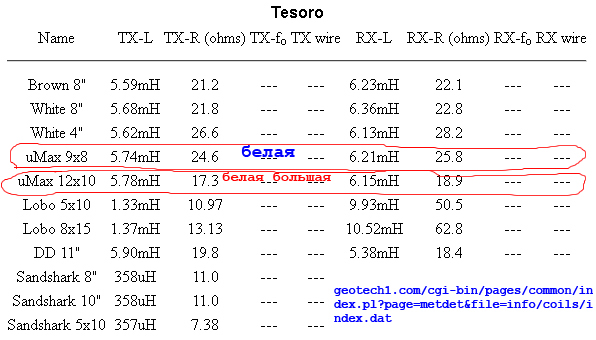

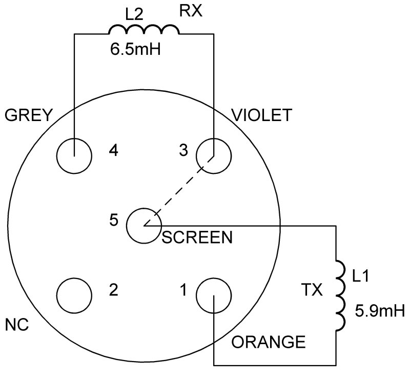

    I want to buy a new coil for my kc but tesoro sells two types D and E type what coils work I don't know what modern detectors work at the older ones we are building frequencies like in the future I want to build a tgsl and right now I have a king cobra. I have a 8.5 concentric that works but I bought it used and its inductance is not on any list I seen I think because its older then dirt.anyway what coil type D or E. Sorry if this was already answered i have looked for a long time and never found anything.

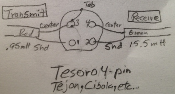

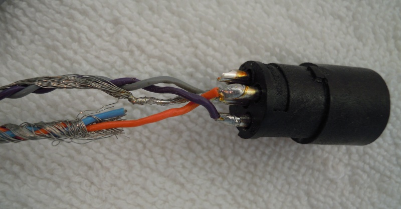

    Well the E is the 5 pin which is for the older models (TGSL Cobra)
    The D is the 4 pin for the newer models...

      tesoro_coil_data.txt
        That was the info I was looking I have seen that but not all together like this that helps...because its totally been answered silver thanks kt thanks for all the help.
          reading in md4u forum Cibola and Tejon have same coils, despite its frequencies are different. one did learn 3 coil of tejon...
