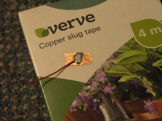

              if i use just bare wire (for example 5cm of bare wire ) , next i use graphite spray on all the coil , then put the bare wire on it then winding vinyl electrical tape on bare wire and graphite spray.
              just 1cm of bare wire for solder the shied of rg58 cable together. i say tell you complete an it is true or no ?
              or just i use like same method as in 101 part 1.
              and frequency 500hz and 120 hz so need 1cm shield gap on coil.
                just 1cm of bare wire for solder the shied of rg58 cable together. i say tell you complete an it is true or no ? ""I would do a bit more 5cm""
                so need 1cm shield gap on coil ""safer to leave gap""
                Just used this method on my latest build. Small square of copper tap and solder directly to it the covered in shielding.
