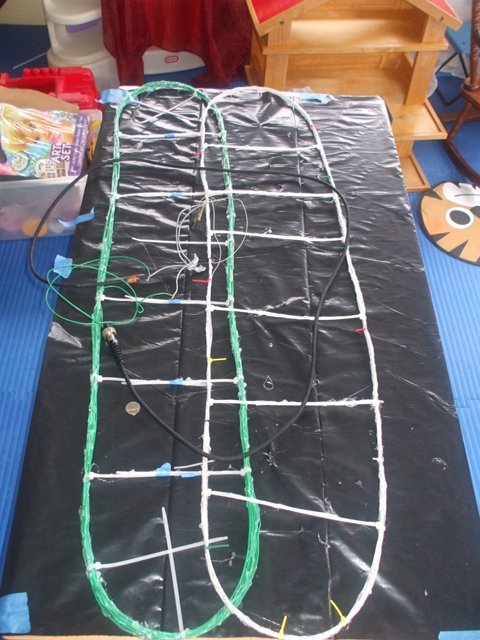

    I got some new wire and wound a new RX and TX coil. Today, for the first time, I got a response from my coil when I tested it. I did this several times with different objects. Because my coils are quite large, i wanted to test them before I stiffened them up. After the successful test, I set them to the perfect shape for the proper inductance and hot glued them (individual) so that they would hold their shape. Now I get zero response. I was so happy to finally get it working and now nothing. The only measurement slightly off is the resistance of the RX. It is at 9.3 instead of 8.9, and this has to do with the coax cable hookup, but this did not change from the successful test.
    So, is there any way the hot glue did something to the coil? Still has same resistance and inductance. As a last resort I will wind new coils tomorrow and see if they work with out hot glue again. Damn!

    When you got your coil to respond did you have coax attached? How much coax? Keep it as short as possible. Coax adds a lot of capacitance that slows coils down. Did you flood your entire coil with hot glue ? If so then yes that too can slow a coil down. Is this for a PI detector?
    Dan
      Yes, my coax was attached. It is the original coax for my PI. I did try to coat all sides of my coil in order to stiffen it up. Is hot glue different than resin? My plan, if I can get this to work, is to eventually coat it in epoxy. Would that cause the same problem?Click image for larger version

        Flooding any coil with hot glue, wax, resin, anything that replaces air will slow it down. Air is the best and that is why spider wound coils with their air spaces are so good. By the way adding the shielding also slows coils down significantly. Spiral coils while very fast must be shielded and because of their broad geometry are among the most difficult to shield and even then they are slowed way down by the shielding.

            The key word here is 'Flood' and just securing the coil with a dots of hot glue won't have the negative effect of filling between the windings.

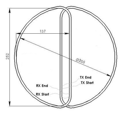

                            Radius of my coil is 255 mm. I used this template:Click image for larger version
                            • Tx - 0,6 mm 34 turns, 1uF,
                            • Rx - 0,2mm 260 turns, 47nF
                            I made this coils for IDX Pro. I tuned Tx to 6590 Hz and Rx to 4600 Hz. In Rx I had to unwrap a few turns to got a correct ferq. Do You think it is too low ferq?
