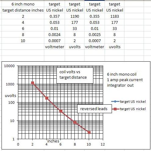

                Was wondering about my coils. Charted a 6 inch mono coil, (spiderweb, graphite paint). Wind pattern in magnet wire coil thread. Didn't see a difference in signal strength. Wondering if you can see a difference in the amplifier out scope trace with the coin on or very close to the coil. Guessing signal strength change would be about 25 percent of the higher amplitude for a two inch loss.

                    Interesting, does the amplifier out scope trace look different when you reverse the leads? Does the effect stay the same if you increase delay time.
                    The only difference in the scope trace I noticed was that there are some small noise spikes that get inverted, possibly from the clocking. Other than that, it looks the same. There has to be something else that I have not considered yet..

                      Hi Dan
                      You are correct on how it's wound. Wish there was a name difference between the way I wind and yours. Maybe there is, you called yours a spider coil in reply #7 and I've been calling mine a spiderweb. Trying to use my magnet wire and it works better than bundle wound.
                        I think I know what's going on now. Up till now, I haven't touched anything on my bench except for the coils. I may be getting a feedback loop going on with the audio section (the other coil is my speaker). I might have some kind of regen effect going on. I should have know better as I have seen this with some of my IB projects in the past.
