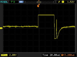

          I'm still struggling to make surf pi "see" 1 euro coin beyond 18cm. I have made 240cm diameter coil with 20 turns using magnet wire 0.5mm in diameter. I know this wire is not ideal, but other people have achieved 28-30cm using exactly this type of wire. Strange thing is that no matter how big coil i make it performs same as smaller ones...
          With my big coil connected i have tweaked damping resistor and the waveform now looks like this:

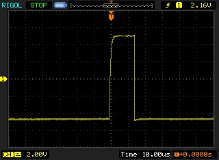

          This is the limit. If i try to tweak more this happens:

          Anyway i have no idea what else to try. No matter what type of coil i try i can't get past 18cm distance... Even smaller ones do perform the same as the bigger one.
            the first photo looks ok.

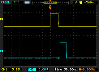

              How long is the sampling delay, and how wide is the sample pulse?
                Delay @tp1
                As for sample pulse where should i measure it? Sorry i'm a bit new to this stuff.

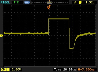

                  The main sample pulse width can be measured at pin 13 U7a (CD4066). The secondary (EFE) pulse width is on pin 5. If you trigger channel 1 of the scope from the collector of U1 (2N3906) and probe with channel 2, you will be able to determine the pulse widths and delays for both samples.
                    I hope i understood everything correctly. I have connected first channel to 2n3906 collector pin and with second channel probed pin 13 and 5 of u7a.
                    First channel 2n3906 collector second pin 13 of u7a
                    First channel 2n3906 collector second pin 5 of u7a
                      [ATTACH=CONFIG]32628[/ATTACH]
                      [ATTACH=CONFIG]32629[/ATTACH]
                      All looks good to me.
