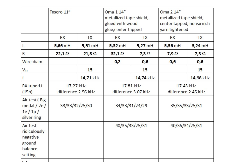

Let's try to demystify coil making by sharing our coil data (coil size, wire diameter, shielding material, inductance, resistance, frequencies, peak voltage, phase information). I'll start by posting data on 11" tesoro widescan DD and

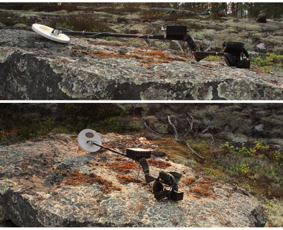

My trusty IGSL:

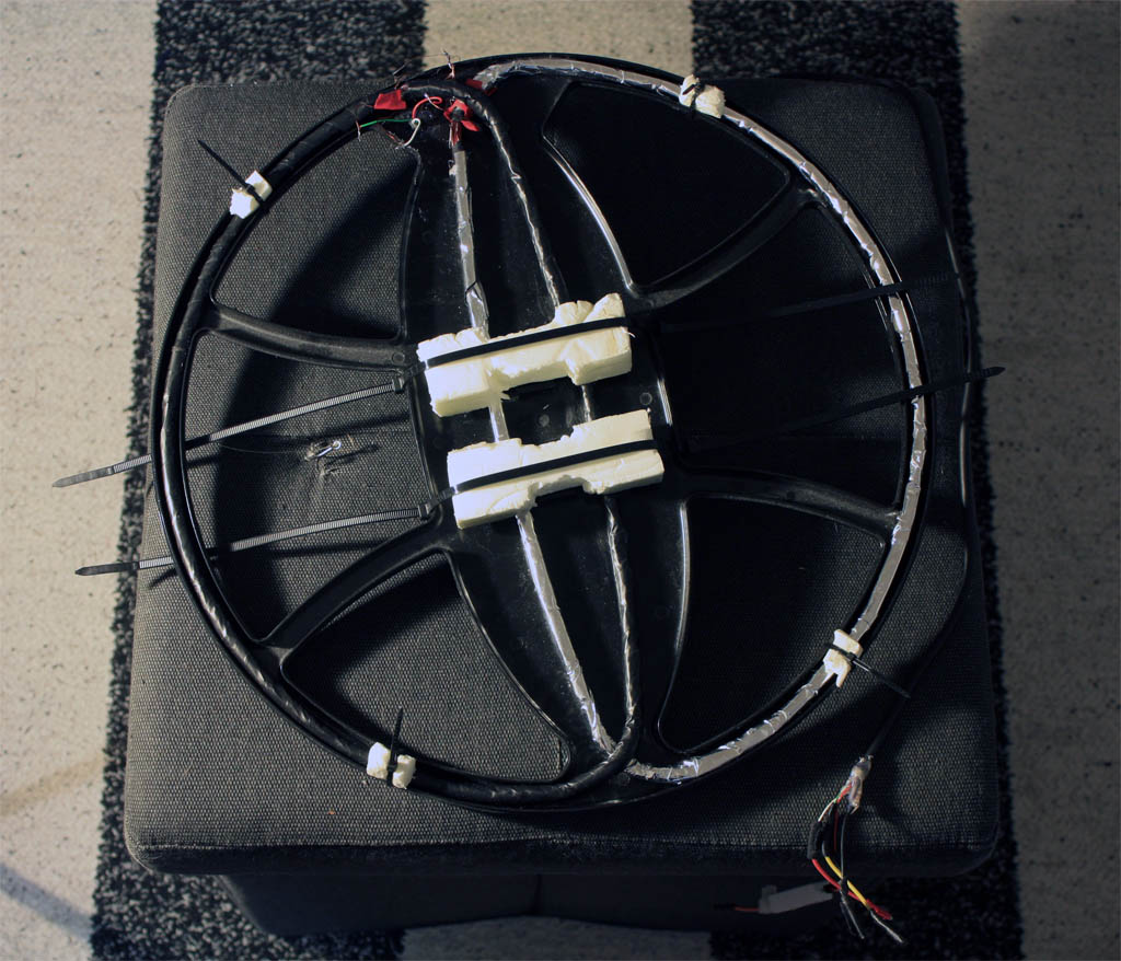

Test setup for 14" homemade coil:
Coil comparison:

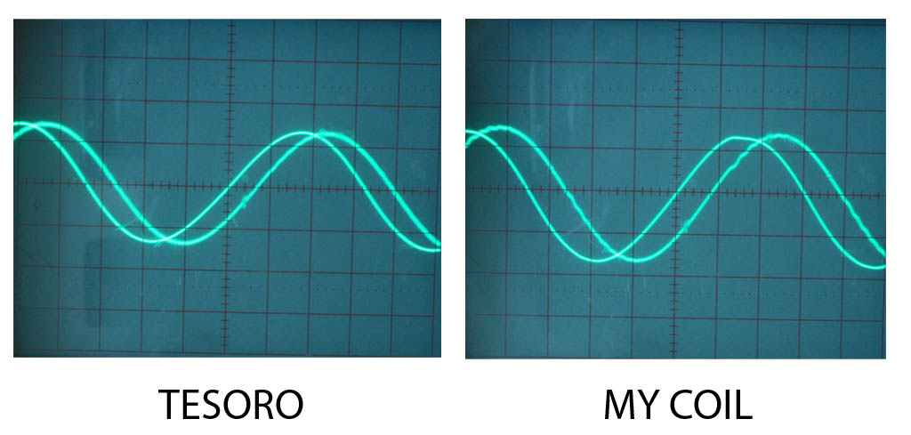

Oscilloscope screens:
TX vs RX preamplifier output
Observations I made:
- Although three inches bigger, my coil performance is only marginally better than the tesoro coil. I have no idea why. At least I'll cover more ground.
- Tried different nulling voltages: measured from rx out, best performance was found at 200-300mV, 400-500mV was good with only about one or two cm loss of depth, at 600 mV significant loss of depth. Below 200mV the phase difference
starts to rapidly grow: at 180mV the phase difference was 70 degrees with bad sensitivity.
- Earlier made TX coil with 0,2 mm wire and over 30 ohms was bad.
- Too low TX resistance resulted in imperfect sine wave as seen on scope picture. Cured with 10 ohm resistor.
- Ground balancing can take off 5cm of maximum depth
- It's very hard to desolder components from silverdog boards
- Shielding didn't noticeably affect performance. Tested spray graphite and aluminized tape. I remember I had reduced sensitivity in past with aluminum foil tape.
- Air testing is inaccurate. Results vary wildly with groundbalance settings. I used only solid beeps on every swipe.
