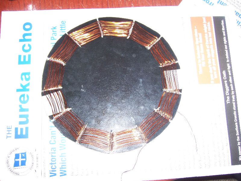

    I recently bought a kit of self surf PI 1.2, I wanted advice on the construction of a coil that gives me high performance.

      best i have done is use the coil calc aim for 350 to 400 mh, and just build a simple round coil if you have a tester even better

                  Can you explain me please how should i choose the right coil for the detector? tx pulse freq have to match coil freq?
                    Can some one tell me how inductance influence for detector depth? I now have 10,5" coil which have 460uH inductance and detection distance is about 10" for 1€ coin. Original surf pi has 230uH coil and kosacid recommed 350-400uH, so do i have to reduce inductance to get better results?
                      Yes.
                      All of this has been covered multiple times on multiple threads here. Please have a "womans look" prior to starting another thread. Search or advance search. My suggestion would be jumble wound@ 300-350uH (or less) .25-.50mm - check resistance - or basket weave (easy to make on plastic coated cardboard form) .5mm approx. Odd number of slots at 1 inch or less. (Pictured below).
