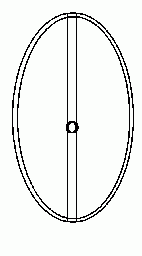

    After the idea and imagination the creation and realization can start,
    that's why I wanna suggest to you such a real great sized coil.
    Sorrily so far no single MD-producer (besides some homebrew P.I. coil makers)
    had the idea or was motivated enough to create and offer such coils
    even they have their high and special values and attributes.
    Of course they have to be built extremly lightweight like a circle
    with a small stripe from up to down - max. weight 1kg! DD technology.
    Coils of this size are very important because they close the far too high
    and expensive gap to all those 1 meter coil detectors compared with
    the not big enough 45cm coils for real deep finds.
    In other words: Either persons will be able to find real deep treasures
    with their usual detectors and with a 66cm coil or they will find it NEVER at all,
    because they will never buy a high expensive 1 meter coil detector!
    45cm coils are often just not deep enough or better said:
    A 66cm coil is up to 50% deeper as a 44cm coil!
    And for 50% more depth everyone should be happy to sweep a little bit heavier coil!
    btw. I know exactly what I'm talking about because I have two 1 meter coils -
    one for the Jeohunter and another for the DeepHunter. And an usual sweepable 66cm coil
    would be a perfect compromise between 44cm and 1meter coil and THE solution to
    reach very deep treasures most uncomplicated and without very high costs!
    Seen from the todays plastic-stability its still within the green range and up to
    medium mineralized soil the penetration power will be still very good for motion circuits.
    So I'm convinced we need it, and we will have it sooner or later anyway, because it's
    a fantastic opportunity and possibility with highly lucrative potentials!
    Especially with modern, just 500 gram outoput electronics incl. cables and batteries, its no longer
    a weight problem but just a barrier in some minds who think it's just not possible to handle.
    Wrong - its easy to handle because the weight is within the limits - and we even can make them
    hand-holdable but much more important is:
    The world with all the treasure-promising areas is huge!
    A 25cm coil many times is like peeking with a needle into a bed here and there, 5mm deep.
    Really, we need such coil-size for huge areas and for deeper treasures or the whole efforts can be useless!

                      Sorry for the answer delay, I was focused on totally other things in the last time.
                      Thank you Skippy and others for your interest, I will try to answer the questions and I drew a coil-sketch (see pic).
                      As you see, the coil is pretty narrow and therefore more stable and less heavy.
                      Neverthless the size-wave-lenght effect should guarantee higher depths.
                      The frequency will be not especially important, we can still use 3-25 kHz and I doubt
                      that 3kHz will be much deeper.
                      What mainly counts ist the coils inductivity to make it compatible enough with usual detectors
                      which are built for much smaller coils.
                      I'm already thinking about the adaption for all kind of other MDs - perhaps made by a company like
                      Detech that already has experience with larger coils for usual MDs like Garrett.
                      It is simple, no question - its just about how to reduce sensititity loss as best as possible and
                      reach far higher depths. More windings with thinner wires and additional adapter-circuit? Something like this.
                        Quote:"Its not that huge gain of EMI with a larger coil. Noise might be 15%-25% higher compared with a 40cm coil."
                        In my estimate, a 66cm coil will pick up 85% more EMI voltage than a 40cm coil.
                        Quote:"its not good if this coil is 30cm above ground-level, that's why it's more meaningful to sweep a directly connected coil as close as possible over the search fields."
                        The idea of using a coil some distance above the ground is 1) It won't pick up as much ground signal (maybe 10 - 20% of the 'close' level) and 2) it won't give triggers on small shallow (<20cm) targets. Having less ground pickup means you can proportionally increase sensitivity/gain.
                          The EMI pickup is a question of circuit stability and contrast factor
                          while the ground depends on how high is its mineralization.
                          (How you got your 85%-plus -calculation? Higher antenna gain?)
                          Detectors that still will give good find signals with low background noise output
                          should be able to handle a 66cm coil, at least if its used 15cm above ground.
                          btw. 30-50cm above ground will raise the e-smog because the closer the coil is
                          to the ground the less e-smog it will catch and also the depth will be reduce
                          far too much if the coil is too high above.
                          If we take a look per instance at the high-stable non-motion Jeohunter or DeepHunter
                          circuit there is absolutly no difference concerning e-smog or mineralization-trouble
                          no matter if using the 45cm or 1m coil.
