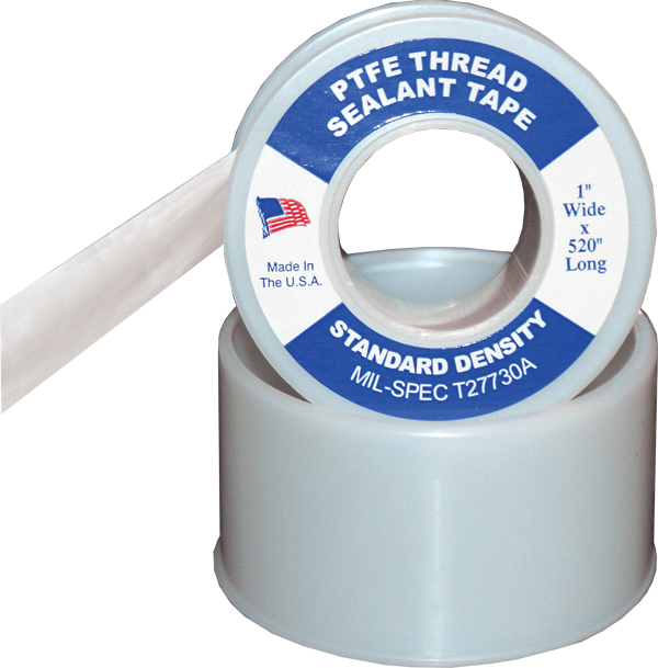

    2. What it's best to insulate the coil winding bundle from shield:
    A. Teflon tape (being used by plumbers, can be found in local shops for plumbing parts)

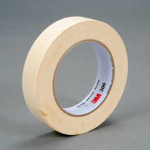

    B. Paper tape (this should be quite lightweight and paper should have pretty good dielectric properties too)
Name:	200 1 in up_D.jpg

    For coil insulation from shield a spiral wrap with good dielectric properties can be used (teflon is probably best but polyethylene should work well too). The spiral wrap provides additional space between the coil and the shield and should reduce the coil to shield capacitance.
    Teflon has 2-3 times better dielectric properties compared to PVC.
