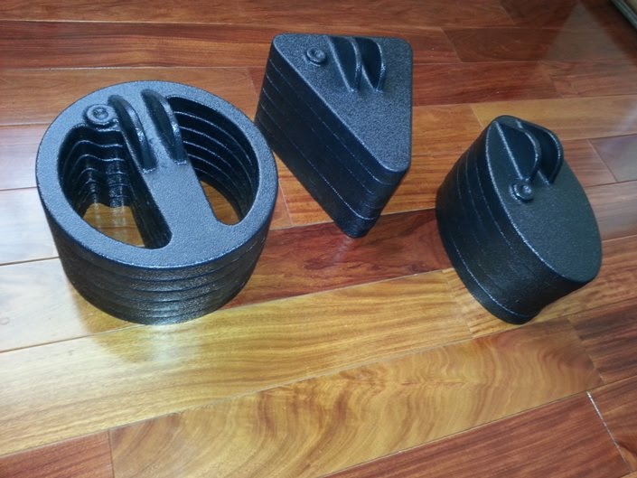

                I had Don make up some triangle shells to my specs for my PI, pictured on his website. They were a good novelty item but the round coils had much better performance.

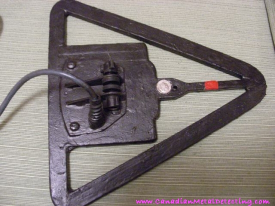

                      I got the idea of building a triangle coil from a post post on a forum about a guys friend who made a detector and used the triangle coil. A much larger size that he used to help prospect and hunt in-between rocks and crevices.

                      Built my coil in a much smaller size something like a 5x7" for my PI. The tip was nice for pinpointing within a hole after digging a plug. Comparing my 5 and 7" round mono coils to it, I concluded the 5 and 7" round coils had much better overall performance.
                      These are the shells I had Don make for me, the round is the 7".
