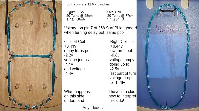

How to interpret pin 7 lm358 voltage on my surf pi testing oval & figure 8 coils, delay pot
  • How to interpret pin 7 lm358 voltage on my surf pi testing oval & figure 8 coils, delay pot
    I am not sure how to describe my question only in writing,
    so I have made a picture. Hope it's comprehendable to you.
    Both coils were connected to the same Surf Pi longboard for testing.
    Any ideas of what is going on? Thank You!
