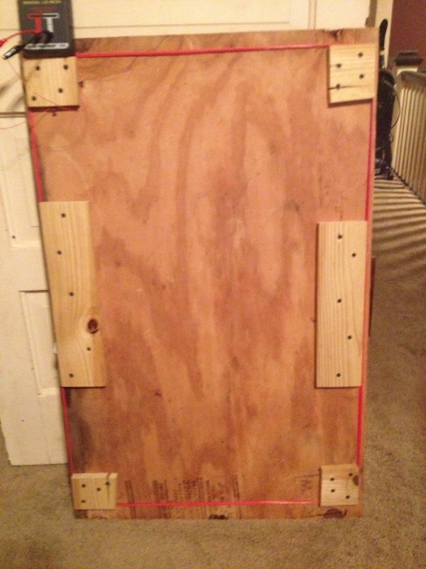

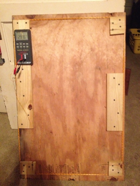

    I am making two 2x3 foot (61cm x 91.5 cm) coils that will overlap about 1 foot (30.5 cm) to make a 3x3 foot (91.5 x91.5 cm) Double D coil for my Whites TDI-SL.
    My research on this forum has shown that separate TX and RX coils will reduced (null, balance, quiet) the ground matrix better than a mono-coil. I am looking for buckle size and bigger items. I am looking for hut sites, trash pits, privies and general large disturbances in the soil.
    Coil/pix 1 (yellow) coil:
    20 AWG (.81 mm) is 19 strands of 32 AWG silver plated copper wire.
    10 loops gives me:
    5.0 ohm
    313 uH
    Coil/pix 2 (red) coil:
    26 AWG (.40 mm) is 7 strands of 34 AWG silver plated copper wire.
    12 or 13 loops gives me:
    5.0 ohm
    396 uH
    Neither coil is spiraled, shielded or coaxed yet. I thought coil #2 would have less resistance and I would use it as the receive coil but now I will test them for lowest delay. Whichever coil can be used with the lowest delay will be my receive coil.
    Any suggestions before I spiral wrap these loops?
    Should or can I build a better/faster receive coil with smaller/better wire?
    Can a damping resistor be used to reduce the resistance with a TDI?
    For additional info - I plan on using an old electric lawnmower deck (plastic) for a platform. I am interfacing the TDI to a data logger and computer all mounted on the lawnmower deck. This will allow me to save the data from the site survey and manipulate the data with data logger provided software for 2D and 3D imaging. Kind of a poor mans GPR.
    Fred

            I have a couple of questions about the TX and RX coils?
            Should the TX coil be low inductance,(300-400 uH), and low resistance to make it a fast coil?
            Should the RX coil be mid inductance(400-500 uH), I guess resistance is not as critical but I might as well try for low resistance?
            The two silver plated wire coils 20 and 26 awg I wrapped with spiral wrap. uH went up a little and resistance stayed around 5 ohms.
            How thick (mm) should the spiral wrap be? I have one wrap of 3 mm wrap. I have Scotch 24 but am saving it for the best coils.
            I measured my small coil that came with theTDI-SL and it measured at the connector 4.7 ohms and 347 uH. I'm hoping to at least meet these specs.

              Inductance 300 to 350uH for Tx and 400 to 500 uH for Rx is OK.
              You can use 2 spiral wraps so the distance between wire and shield to be bigger.
              No need Rx and Tx coils to be very good balanced.
              Good luck.
