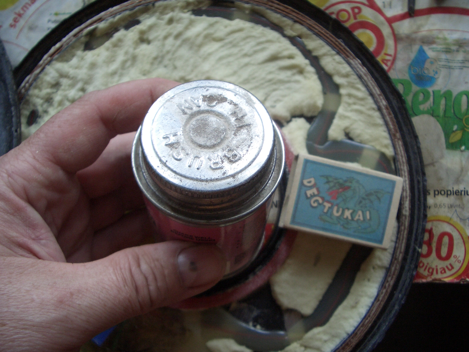

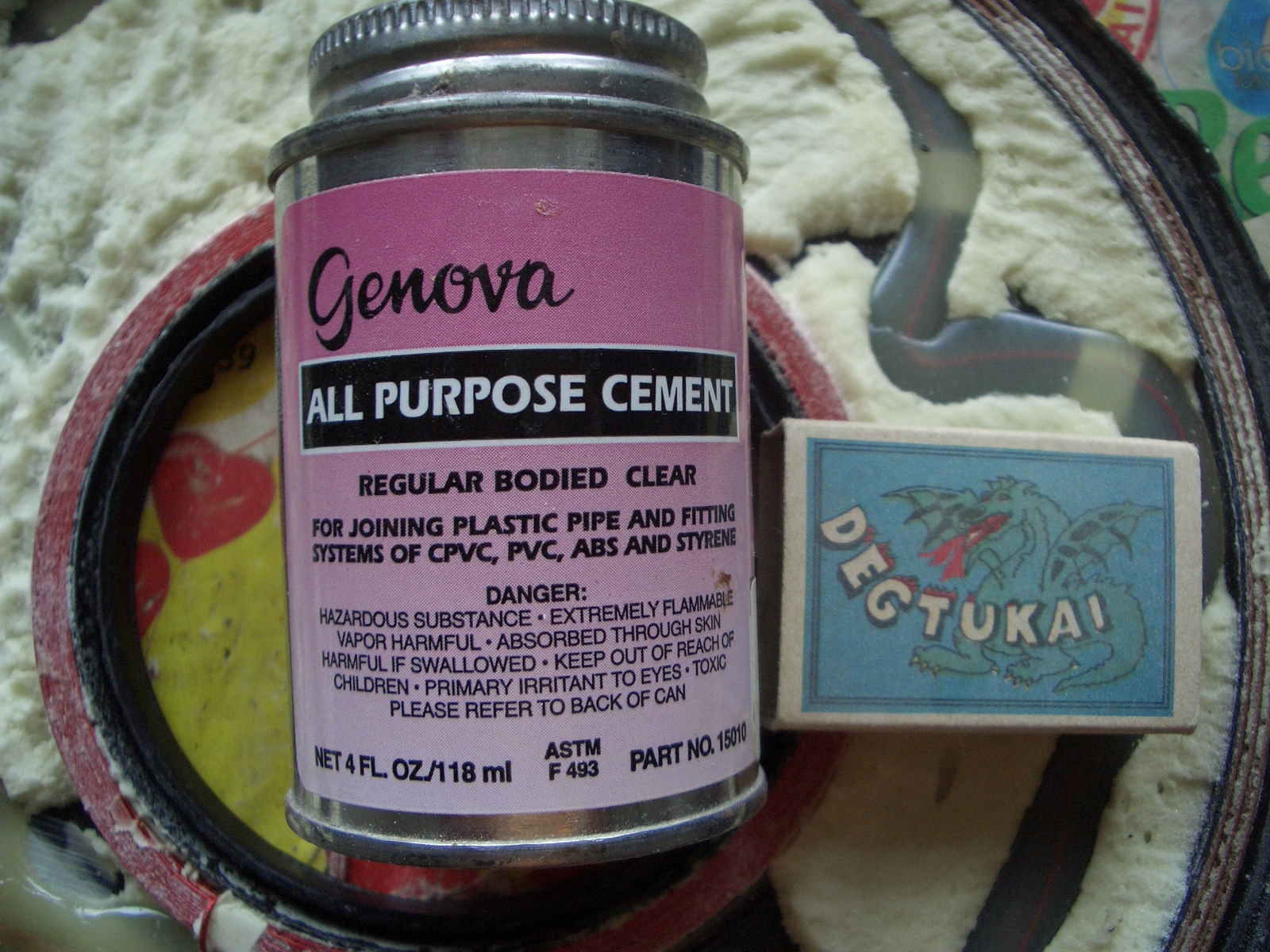

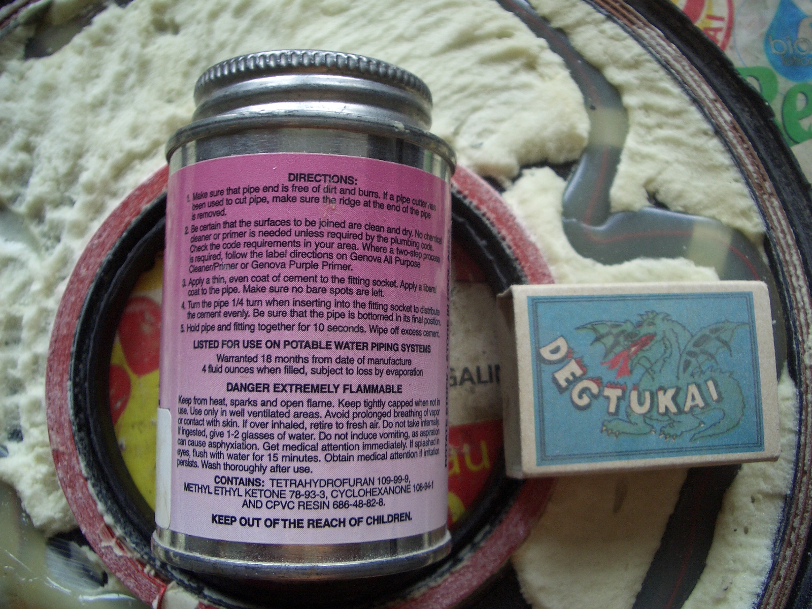

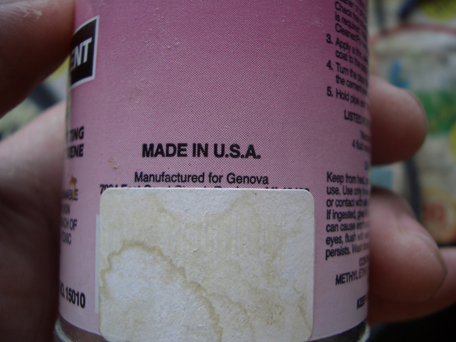

                  if you are in USA (I believe) so you have to be looking over around USA made glue, be cause best quality.
                  pics say more. I used it much years ago.

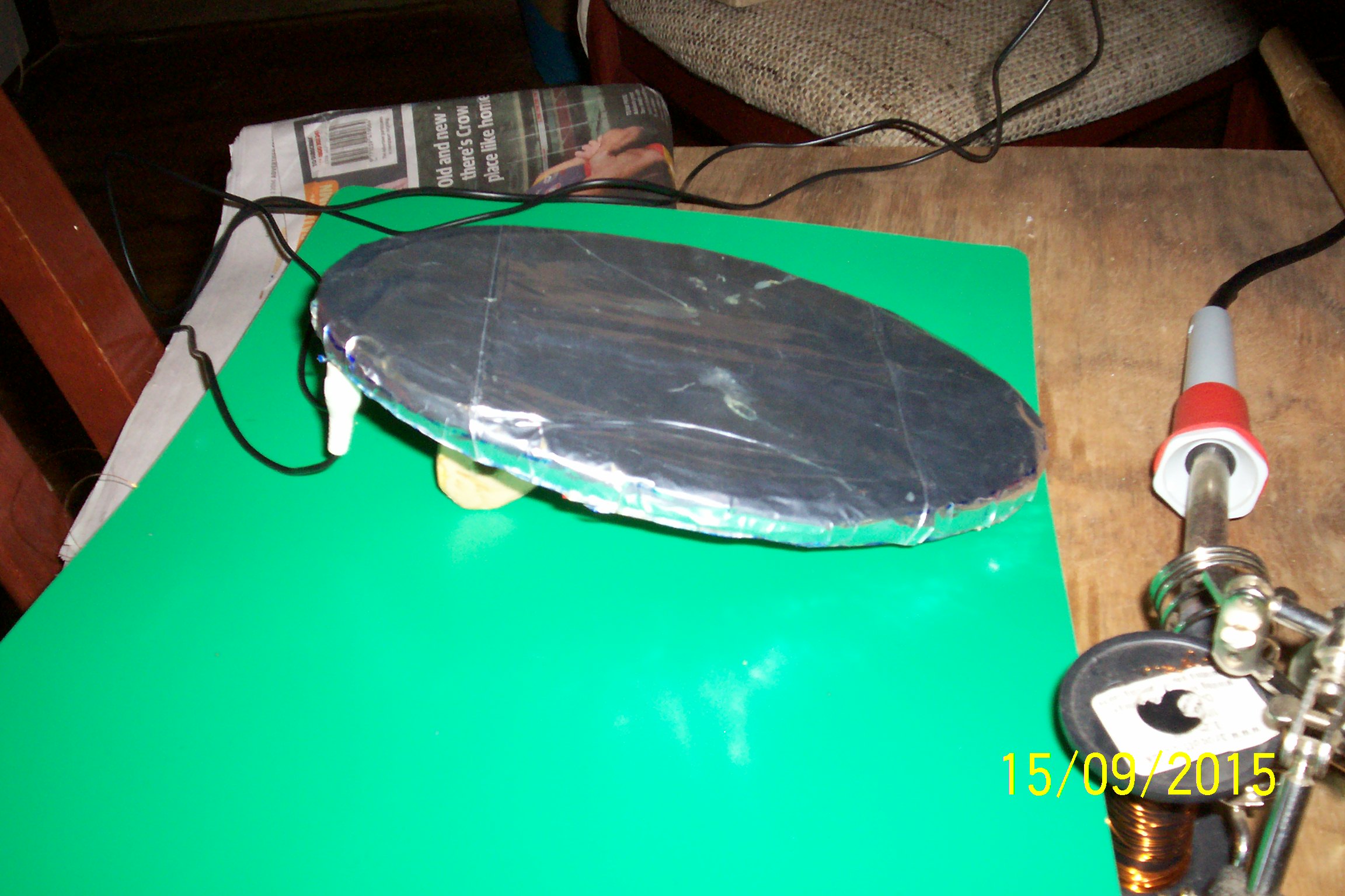

                    Hi. I just made my first coil. It's 12mm plywood. The coils are 40 winds, 6 1/2 inch dia. .25mm enamelled. I used Exterior PVA(Aquadhere) for setting the coils( a bit of supa-glue to position).
                    The shielding I used was mylar(I think) powdered milk bags. I tried sticking that with PVA to no avail. But the resultant seal of PVA on wood made an excellent base for the Chloroprene glue I used for the mylar.
                    I don't know if this is any help for plastic housings, but may be helpful to someone.

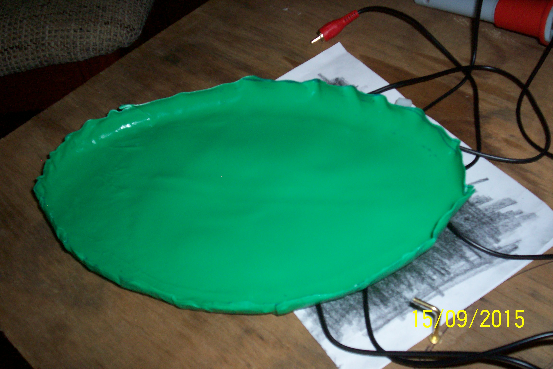

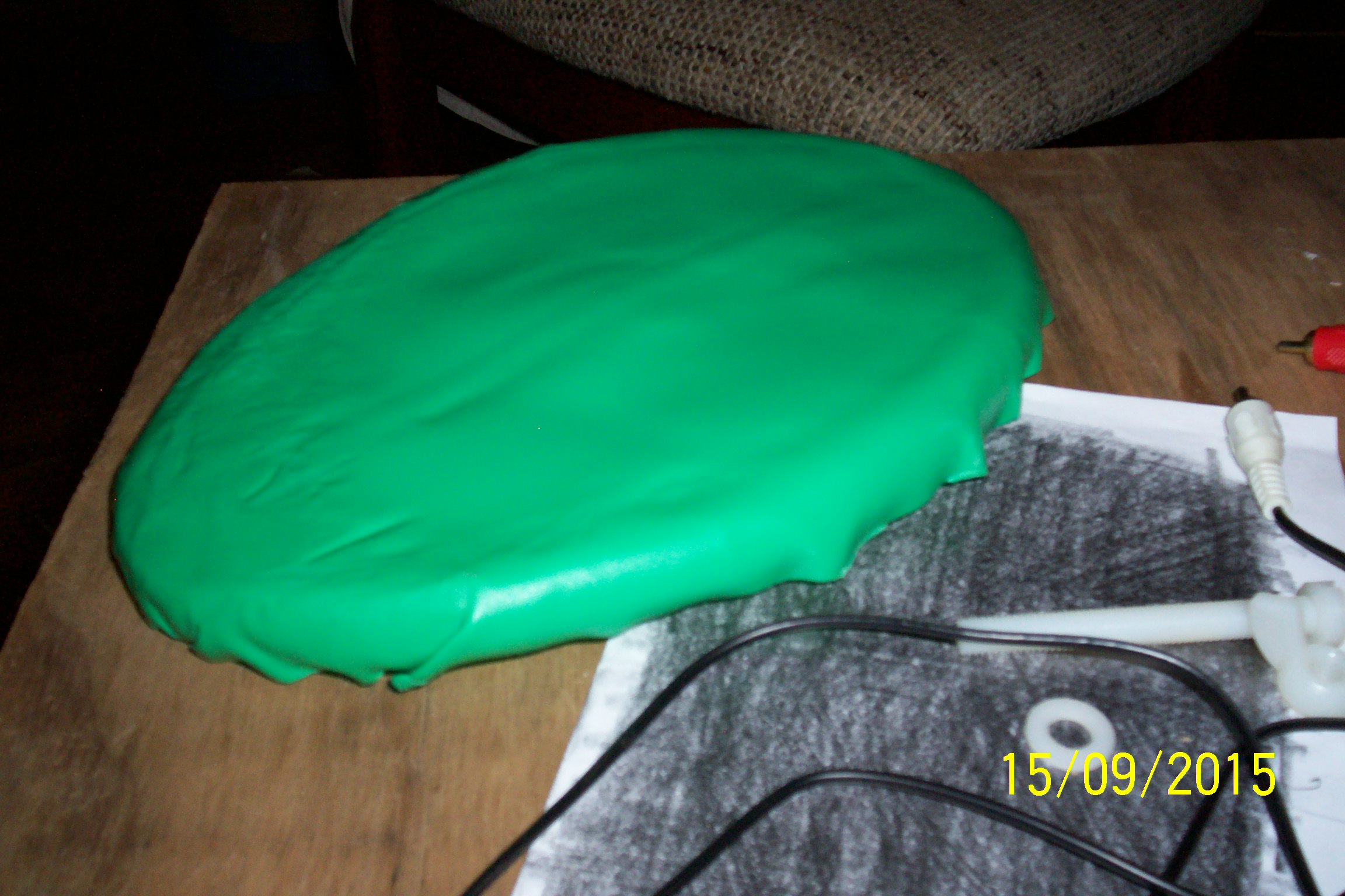

                        Thanks 6666, got it now. This is my first dd coil. I will attempt to make a cover from the thin plastic cutting board. Hopefully it will melt before the rest of the coil...
                          Well the plastic cutting board has potential. I tried making this one in the oven(200C). I laid it on a tray. First without baking paper underneath,whoops! then this attempt. When I get a heat gun I will have another go. I wasn't game to put the whole coil in the oven for fear of melting the enamel.(?) By heating and smoothing each area I should be able to get a respectable shape and finish.
                            This is super-slick stuff, so I can't imagine what glue would stick it ?? Any ideas?

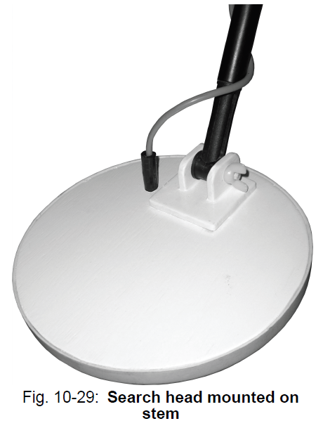

                              I fail to understand why more people don't employ the technique used in "Inside the METAL DETECTOR" from Chapter 10 - IB Coil Experiments.
                              This allows you to use any cheap coil cover to make a good looking and functional coil relatively easily.
