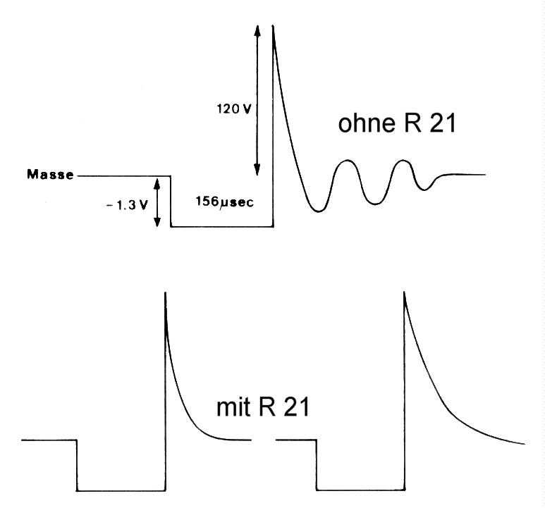

        The best way to adjust the damping resistor for critical damping is to attach a scope to the output of the preamp. Then use a damping resistor tool to find the optimum value. The damping resistor tool consists of a 10k pot in series with a 200 ohm resistor, and both in parallel with a 2k resistor. After adjustment, measure the resistance of the network and replace it with a fixed resistor of the same value. See page 155 of "Inside the METAL DETECTOR - Edition 2".

            pic the.

              OK, I assume that he bottom trace 'mit R21' means without damping and the top one with oscillations means 'without R21'.
              Is the value of the resistance when the oscillations just disappear called the critically damped point? Or is some other measurement more relevant?
                  Those "mit R21" mean: with proper selected damping resistor.
                  When damping resistor is correctly selected, then you need to hold decay time (depending on the characteristics of the coil) as short as possible and decay curve as straight as possible (without oscillations).
                  Observed without target.

                        Originally posted by pebe View Post
                        What indication is there that the optimum value has been reached?
                        Indication is detecting distance of selected target sample (1 euro coin par example). Greater achieved distance mean better (more optimal) tunning.
                        Using scope, you do not need testing sample to check how damping resistor is tuned. In this case, you observe decay slope (curve) as per answer in post #9. Be sure no metal particle near to tested coil (at least 3 diameters of coil). For every coil, damping resistor should be selected/tuned separate, if you go for optimal.
