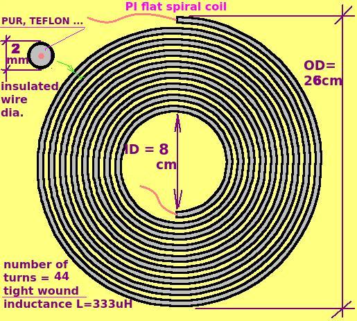

    You can build fast flat spiral coil out of cheap TV coaxial cable (with removed outer insulation and shielding before) and inner (ptfe or something like this) insulation left, then you winding coil tight turn to turn, to get about 330uH:

          As stated above the coil speed is dependent on the inductance and total circuit capacitances. A smaller coil wound with the same #26 AWG wire with a lower inductance might be a better choice.
          The circuit time constant (TC) for charging the 360uH coil is determined by the MOSFET resistance = approximately 0.7 ohms, the MOSFET series resistor = 3.3 ohms and the coil resistance of 3.1 ohms; TC = L/R = 360 uH / 7.1 ohms = 50.7 usec. If you wind a new coil and reduce the coil resistance to 0.5 ohms the TC will = 360 uh / 4.5 ohms = 80 usec.
          The time constant for coil discharge is mostly determined by the circuit resonant frequency as determined by the coil inductance and total circuit capacitance. The capacitance is a combination of coil capacitance, MOSFET/series diode capacitance, and coil cable capacitance. The discharge TC = L/R; R is the damping resistor value in parallel with the 1000 ohm input resistor. The internal 3.1 ohm coil resistance has insignificant effect on the discharge time constant. One TC is approximately 63% down the discharge slope. It takes close to 5 TCs to reach the bottom of the damped discharge curve.

          Using the values listed in example 4 versus example 1 reduces the decay time in half. There will be some signal strength lost from having fewer turns in the coil. This loss could be compensated for by reducing the coil diameter.
          Teflon #26 AWG wire is a good choice for a new coil. It can carry an average current of 7 amperes which is much higher than required. And it has low capacitance characteristics which is very important. Since you are trying to detect very small gold nuggets it might be worthwhile to reduce the new coil size to 4-6 inches similar to Gold Master or Gold Bug detector sizes. This would increase the intensity of the magnetic field and reduce the amount of ground mineralization in view around tiny nuggets.

                    Ok thx all & especially Chet for that excellent analysis of the factors that influence the speed of the coil. That will be very useful in lowering the overall TC my MPP is capable of detecting. So I should have been more clear - I'm focusing specifically on how to make the coil itself as fast as possible - separate from the electronics & the coil's interaction with the electronics (separately I will also work on the electronics aspect). I'm thinking that ultimately for the coil's magnetic field to collapse and recover as fast as possible the electrons must flow out of the coil field as fast as possible, & the coil's impedance is going to slow down the flow. This is why I'm focused on lowering the coil impedance. I am under the impression that Minelab & Coiltek coils are sub ohm for the same inductance and I am trying to achieve this. This is why I'm looking at finding the optimum wire for the balance between impedance and capacitance for a given inductance. Many thanks! - Kyle
