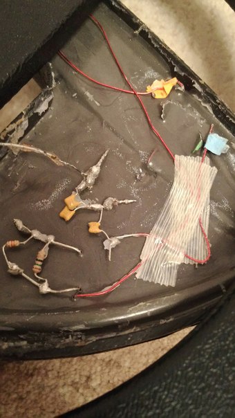

                  Oh ****... there are two capacitors in the coils. I'll have to remove them somehow.
                  But then again that's the 300, perhaps not the case of my coil.
                    Anyone knows whether White's DD coils are induction balanced?
                      There are no capacitors in coils made for the DFX and MXT. The DD coils are induction balanced
                      for all the VLF and multi-frequency.

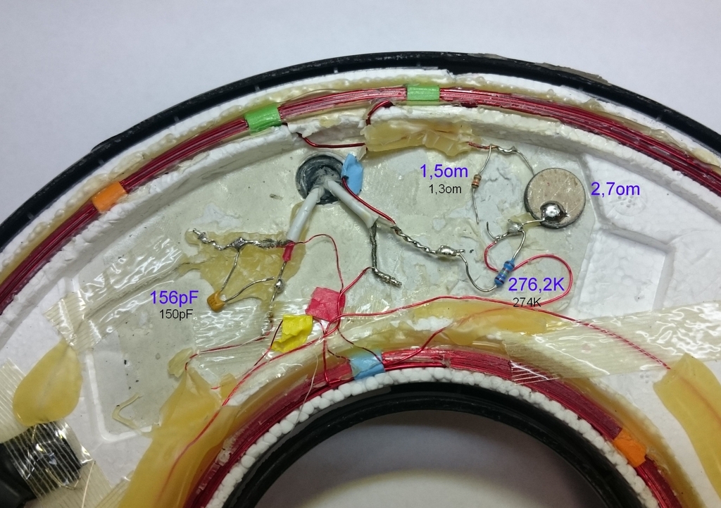

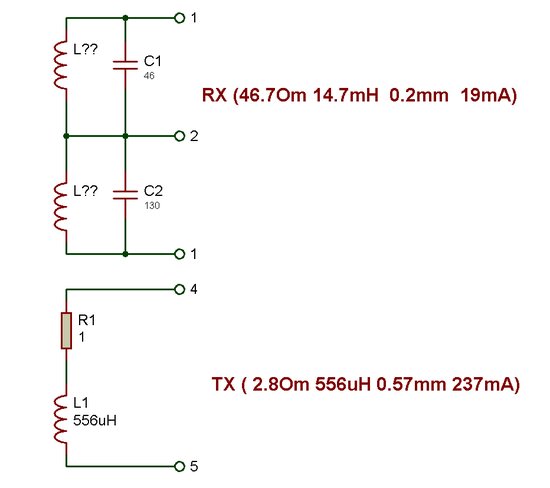

                        i have not good pics on MXT coil inside, but yet found on Vision, a schematic and see a pic of coil from ru forum.
                        there are some capacitors with low value and some resistors. guess those are some kinda an antinoise filter,
                        no another mission. resistors are for accurate phase tuning.

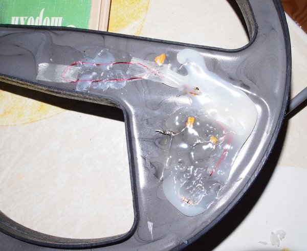

                          The one I opened years ago was a concentric. It only had a fixed resistor and a ntc(negative temperature coefficient) resistor in series with the TX coil and nothing on the RX coil.
                          The DD looks different
                            nothing on RX side be cause a transmitter signal is square form and you can not simply to set a noise filter there be cause getting smoothing besides a clear form.
                            some people stubbornly is proving that RX coil has the resonance if seeing a capacitor parallel in IDF/XLT coils. NOthing of resonance there to be.
                              i asked a RU forum and one gave me a clear pic with markings and measured values.
