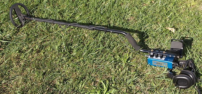

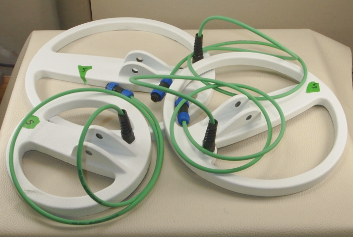

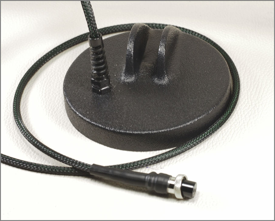

                I have made a couple PI's for really tall guys with long arms. 33-35" was too short.
                So I bumped up the cable length to 44". That satisfies the tall people.
                I saw no performance difference from 33-35 and 44 inches.
                For under the armcuff control boxes, 44" length seems ideal without binding.
                All my fast PI mono coil cables are now 44" long.
Name:	ULTRA 1 BLUE DONE2.JPG
