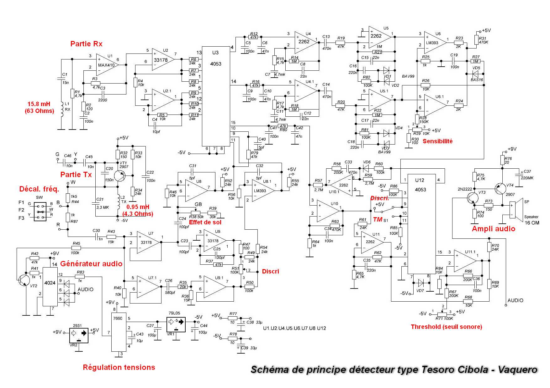

    OK, i find out how to add files. I share the layout file and the shematic.
    I don't understand why there is no pinpoint button on the sheme ?
    There is one on the VAQUERO and CIBOLA ...
      but i don't know how to add it on the forum

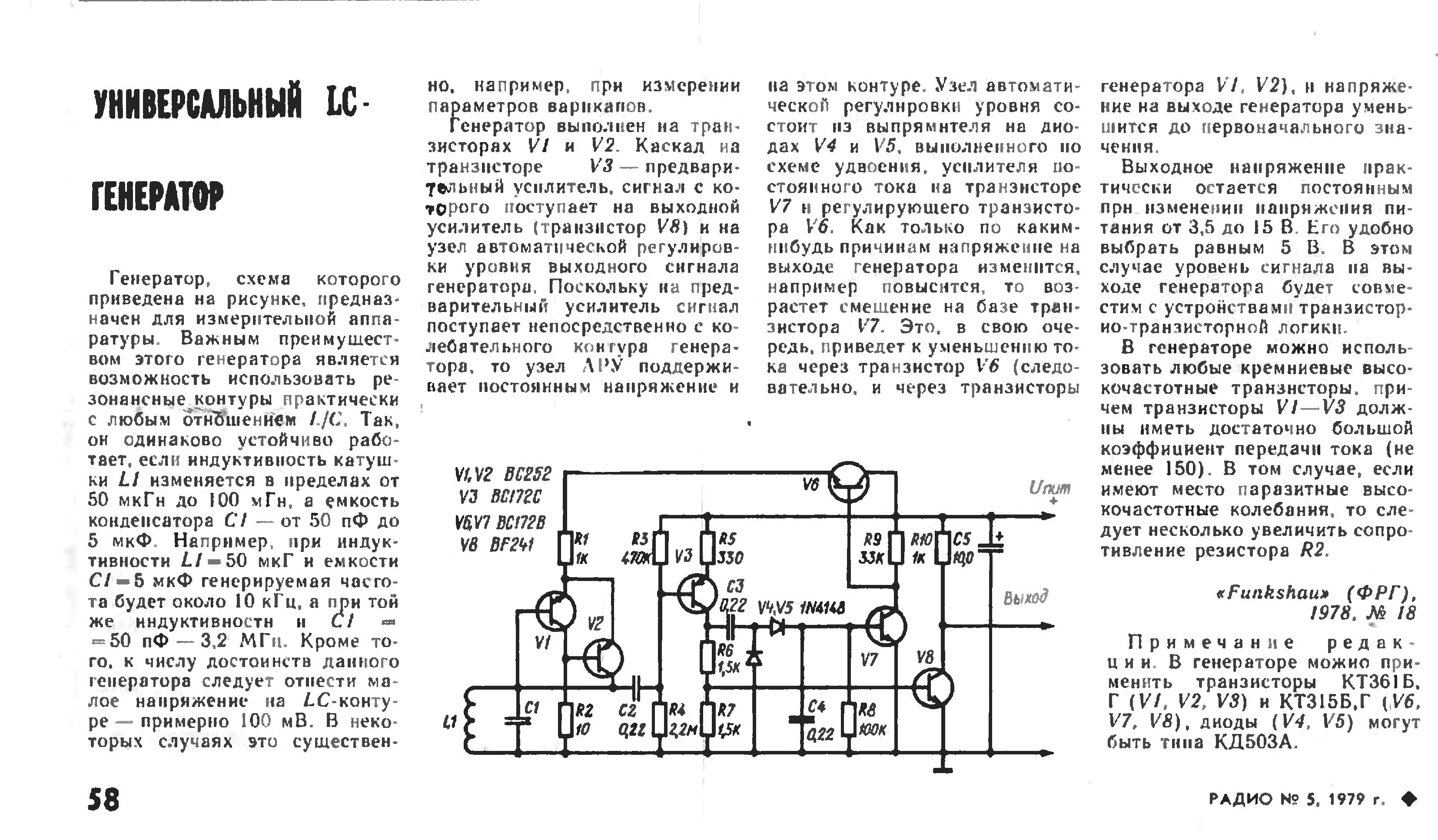

      a generator for a coil tuning freq measurement with LAY file.

ID:	344337ГЕНЕРАТОР ДЛЯ К&#1.rar

            Thanks for the reply.
            Could you have a look at the scheme on my second post cause it don't use pic or avr chip.
            It's all analogic.
            So, can i wire the rx coil with awg30 and add a resistor to fit the requirement ?
            I also have awg26 wire, i could do the same for the tx coil with a resistor.
                It's all analogic.
                ok. but the scheme being remade now is yet NOT Vaquero. do you agree with that? BTW you could make TGSL, any tesoro,
                and to call it Vaquero with this success. http://www.findmall.com/read.php?22,1998928

                    I understand that the original design has been changed by a russian guy.
                    But, the original pic don't have much things do deal with the functionning, no? I mean, CIBOLA is an analogic detector?
                    PIC is just there to add some improvements, probably on the audio generation.
                    Do you think this design will not work better than TGSL ?
                    And what do you think of the KPOT3 project which seems easyer to build ? The videos i've seen on this model are impressives !!
