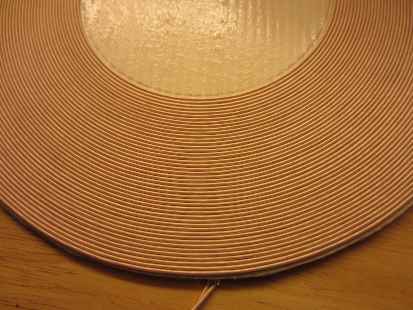

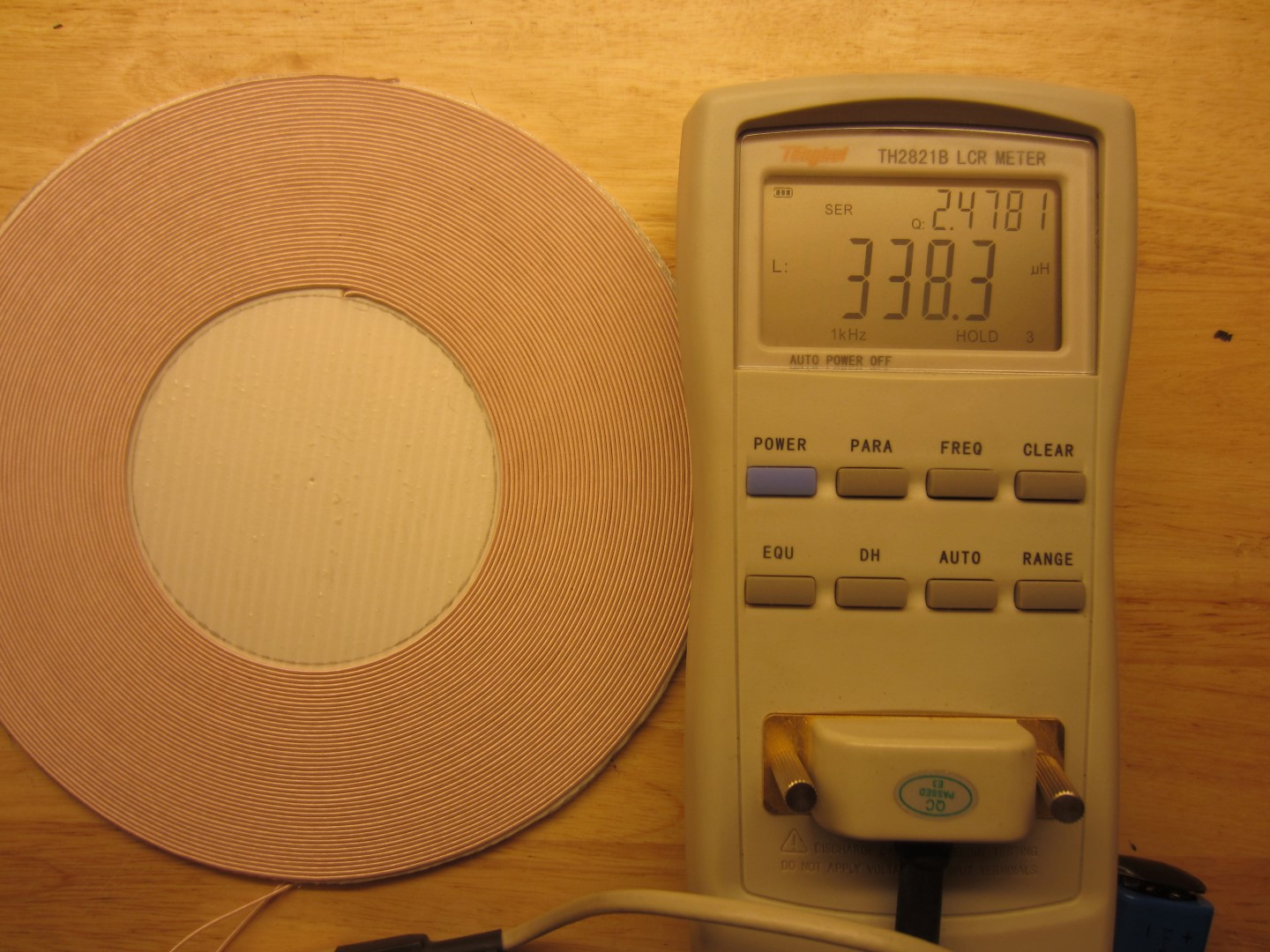

    Hi all, been a while. I decided to build a flat spiral wound (nugget hunting) coil for my TDI.
    I am hoping to get some input regarding the construction method I am using.

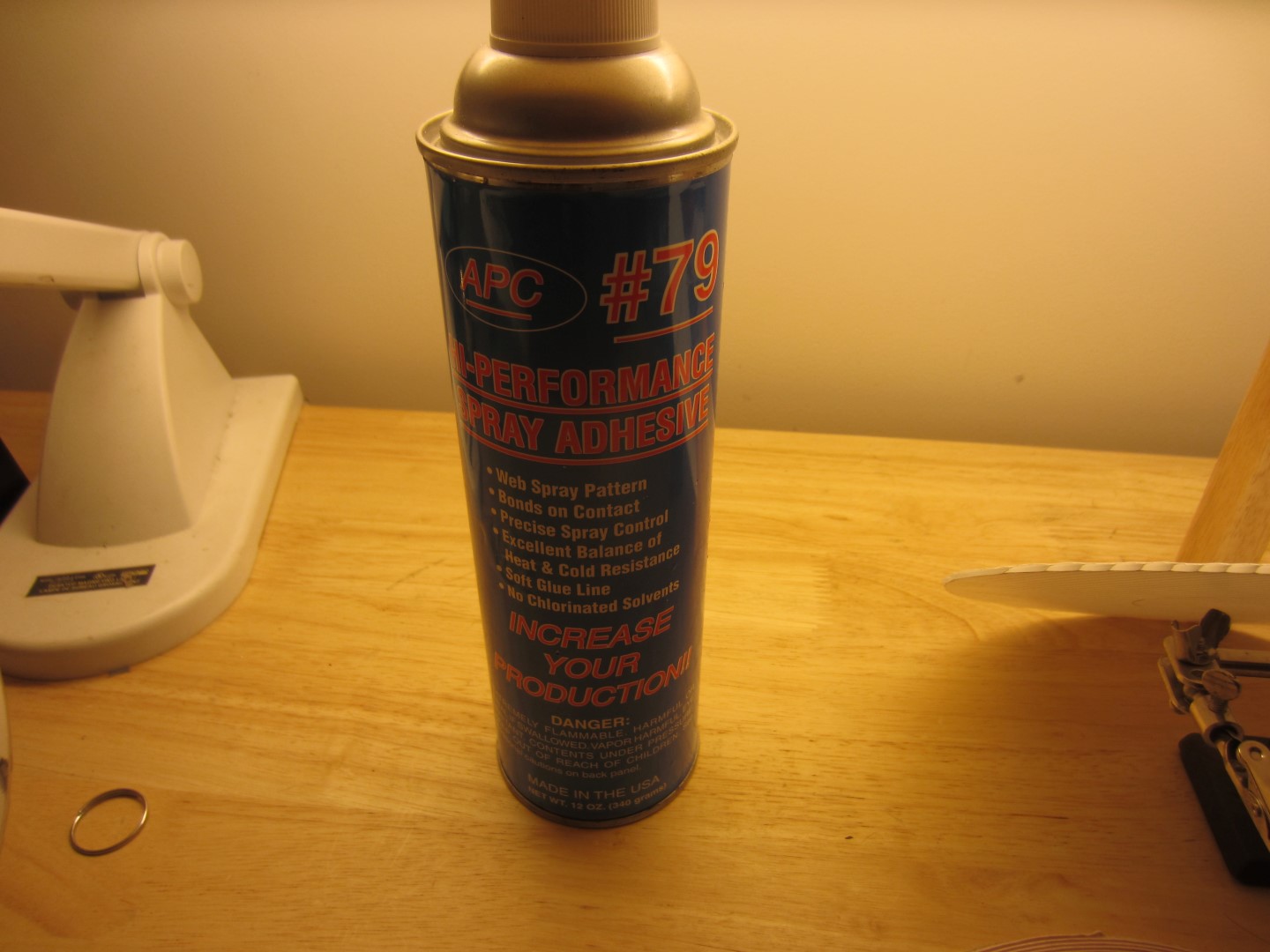

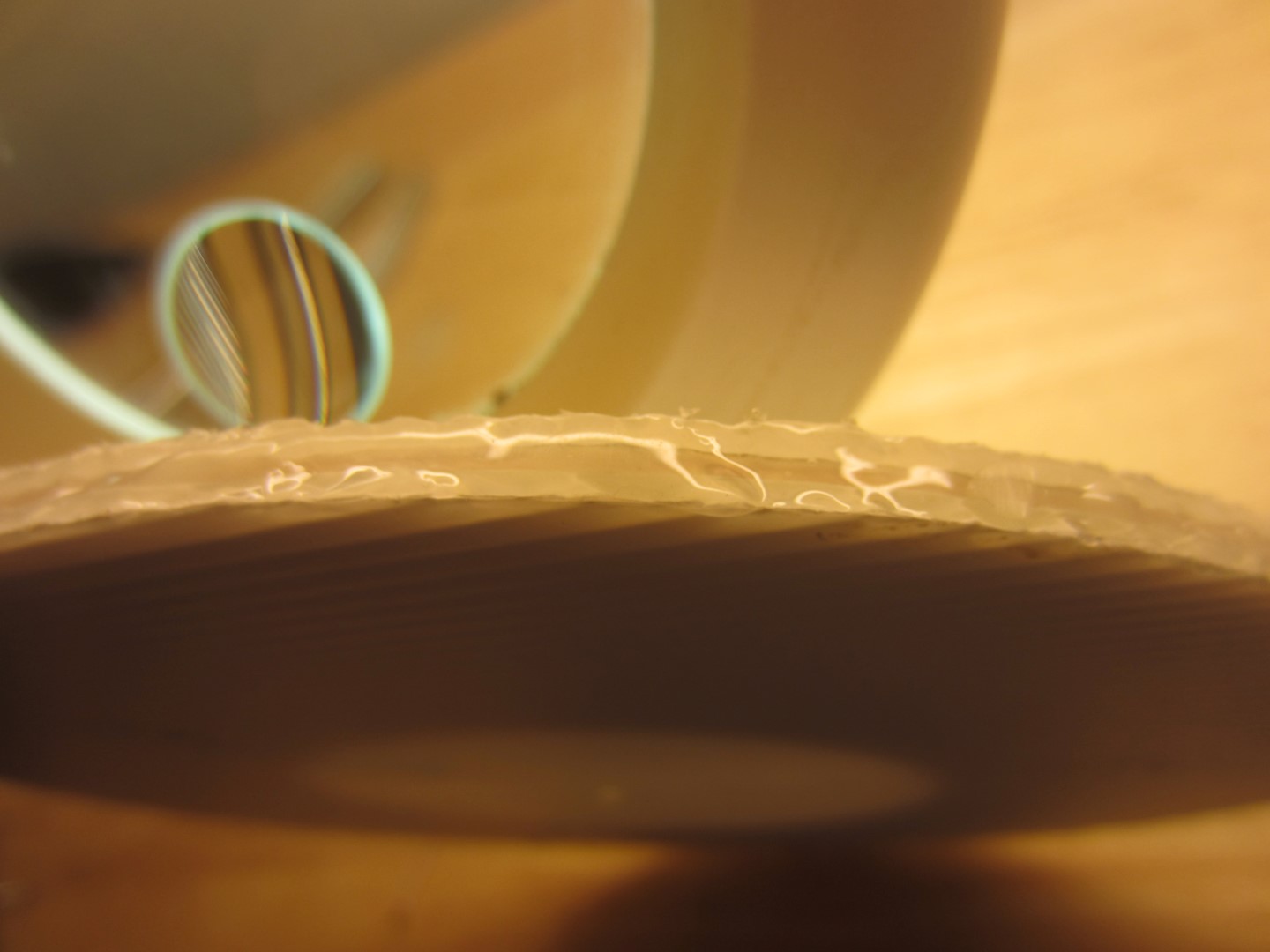

    Using 330/46 Litz wire, and spray adhesive (like contact cement), I wound my coil on a 2mm thick corrugated plastic disc to fit an 8" Hayes housing.
    Then I sprayed the coil and another disk of corrugated plastic. Sandwiched the windings and sealed the ends with hot glue.

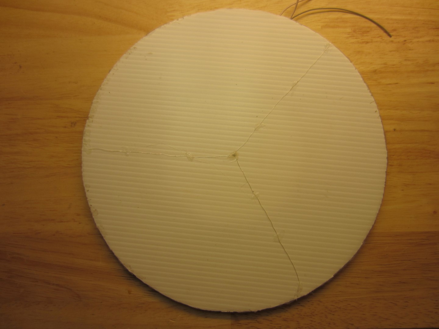

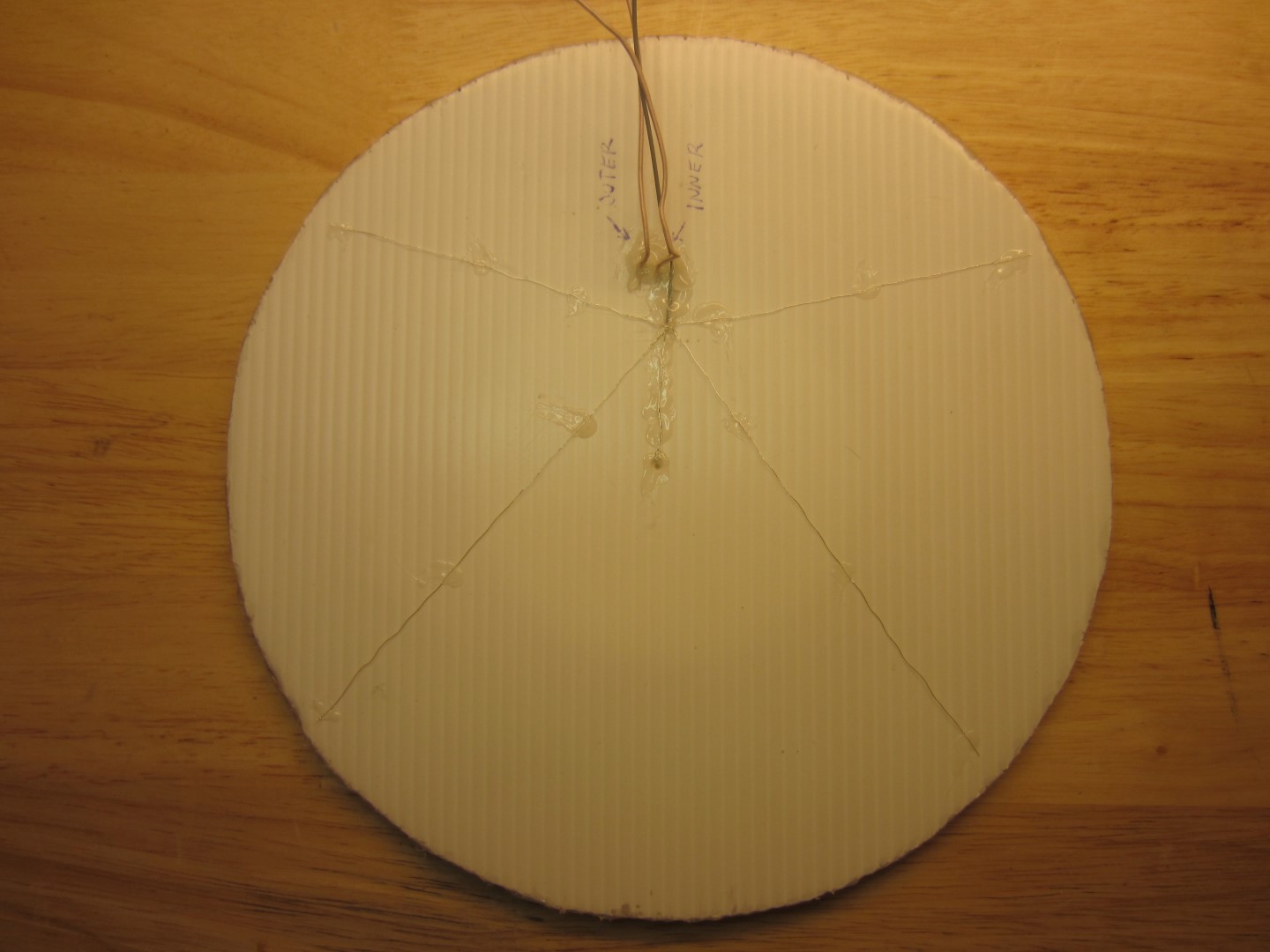

    Next I arrayed wire filaments from some 7 strand #28 silver plated wire on both top and bottom of the coil assembly.
    I know most people use one or maybe 2 filaments, but I chose not to cut any strands and array them as to get the most contact both top and bottom.
    I will be covering the entire coil assembly with graphite spray.
    At this point I am wondering if my shield filaments are acceptable or if I have too much. I have built a number of standard bundled wire coils, but not a flat spiral.
    Any advice is appreciated.

    As long as the filaments do not form any loops in the coil normal plane it should be a good way of connecting to the shield. Maybe not painting the litz wire itself with graphite but having some sort of cover such as a paper circle over them to minimize the amount of graphite that gets in direct touch with the coil proper. Sprays are still liquid, and they tend to soak into bundled things (like litz wire) by capillary effect and create a large surface area.
    One thing to consider is solder blob size when connecting litz wire. In a previous thread about the minelab patent on masking large solder joints with ferrite beads it was also determined that having multiple smaller solder joints would be one method of getting around large solder joints with litz wire.
    What about cable type, and the method of connecting the coil and screen to your detector? Where are you planning on connecting your screen, do you have a braided litz screen for your coil lead? Connecting a coax or other cable that generally has a thick circular continuous shield can add a false target for your coil. Minelab's litz coils have a proprietary cable type that has a litz-arranged shield to avoid picking the shield up as a false target.
