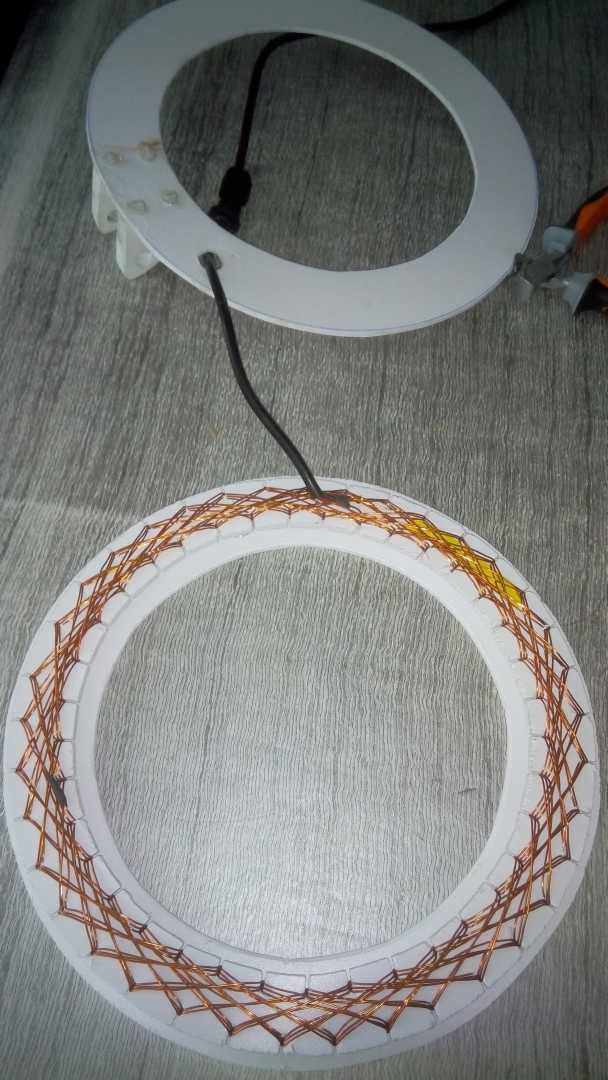

    Hi everyone,

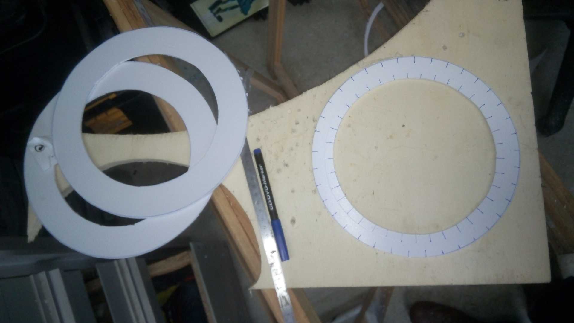

    i would like to share my coil building process which result to a very light coil.
    For this, i used 3mm foam, a small piece of 10mm foam or plastic for the fixing harms.

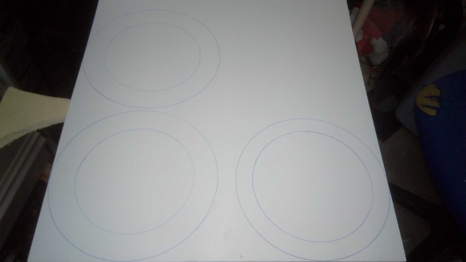

    So, the fist step is to draw 3 circles on the foam (2 of the same size and one 10mm les in outer diameter an 10mm mor in inner diameter).

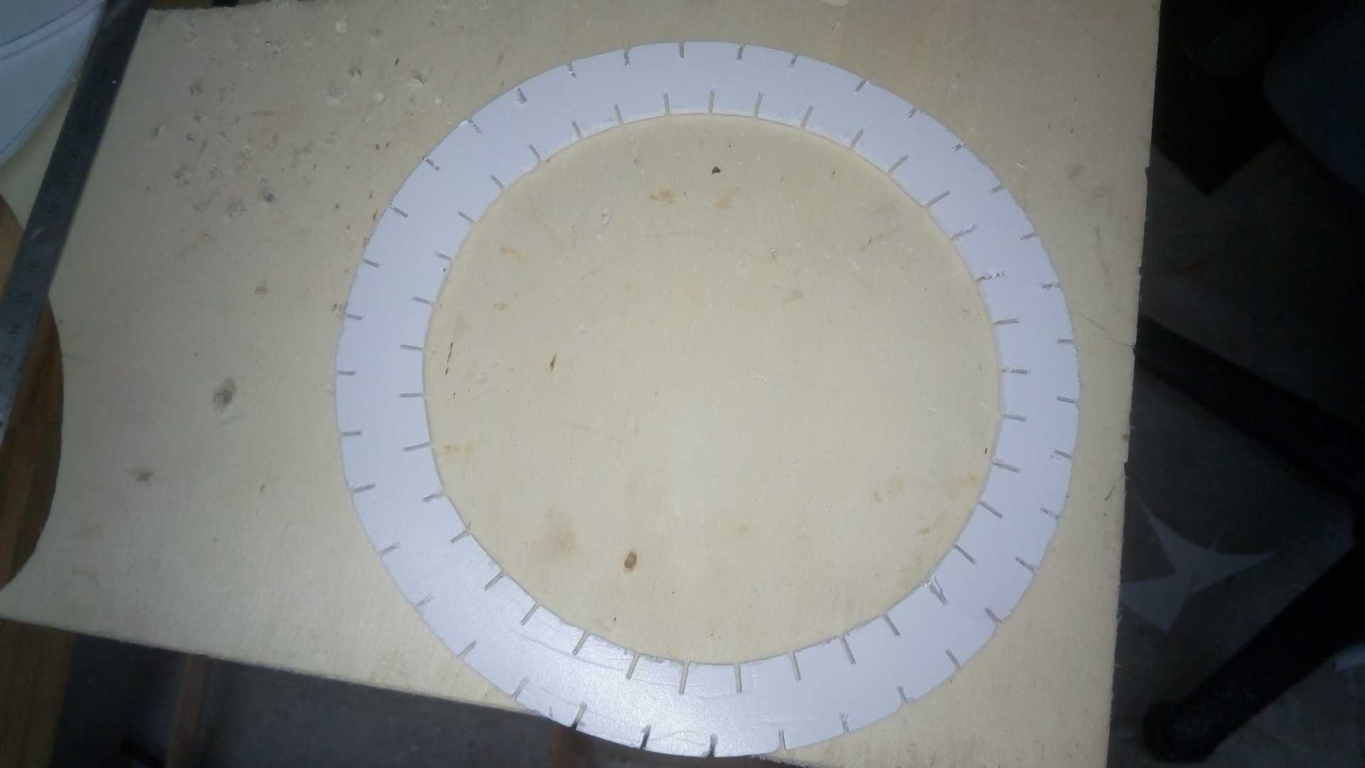

    Then, you have to cut the three circles
    You can now cut 37 notchs on the inner circle and 37 on the outer (to calculate the space between 2 marks : d=(3.14148Xdiameter)/37

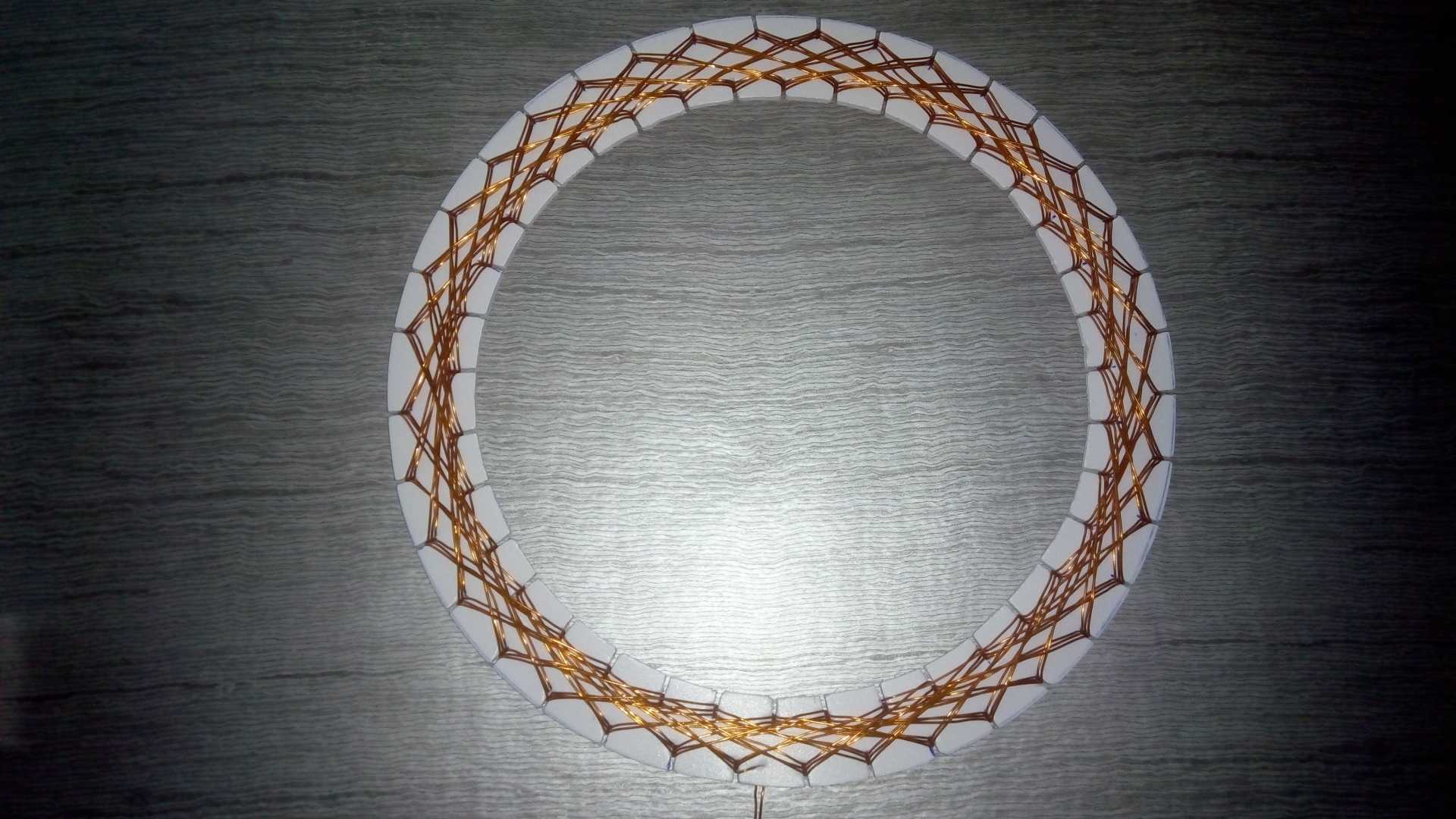

    Now, it's time to wind the coil. My first one was bad cause i did not find any explanation on this. I'll to explain it in english : if you wind all the turns in the same way, you won't have the same result as expected. When you finish a turn (i mean, just before your wire goes into your first mark), you have to shift the winding of one mark.
    When the winding is done, you should have 6 layers in each notch.

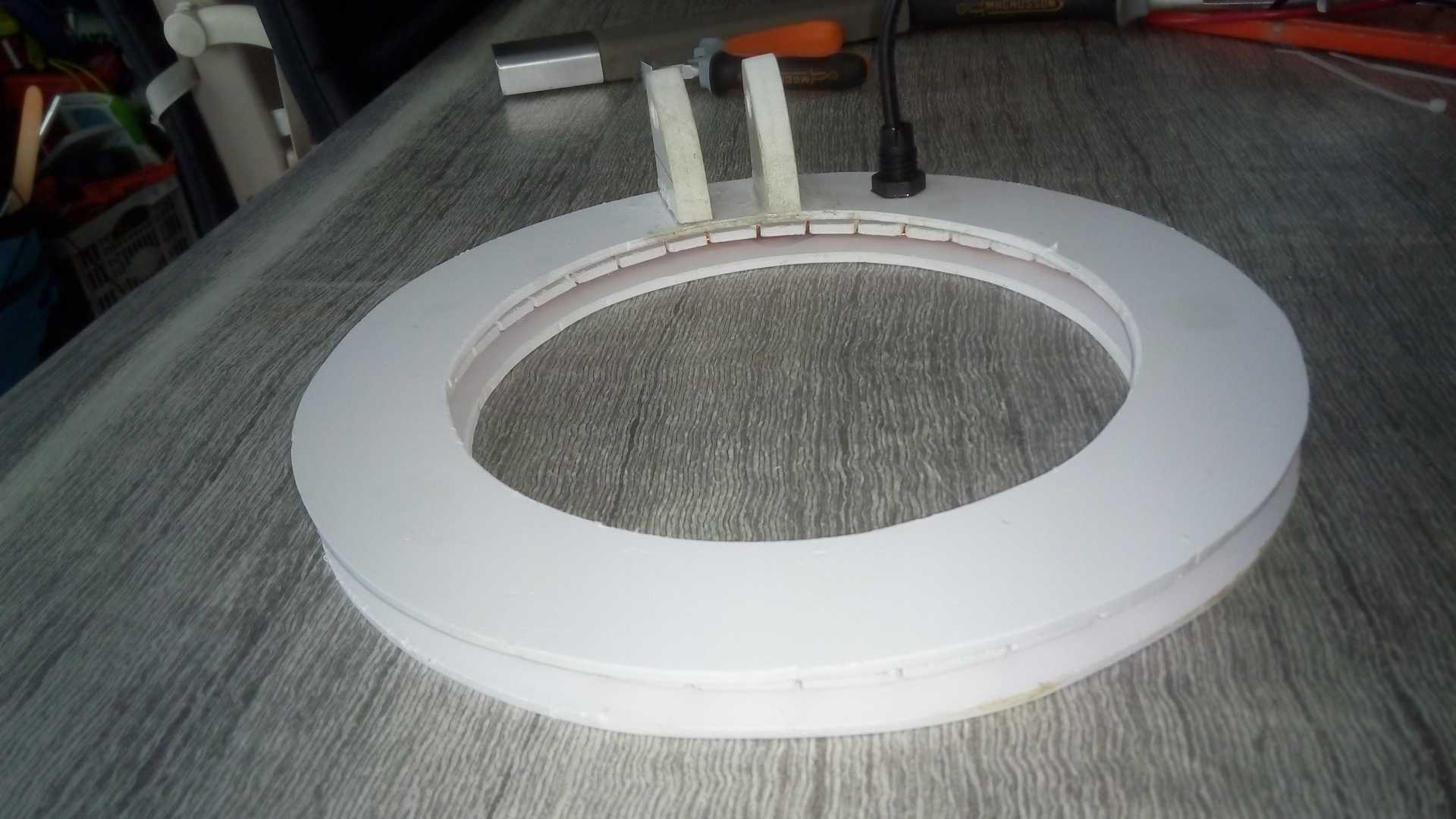

    You are now ready for the assembly. You'l need epoxy glue, plastic screws, coaxial wire, jointing compound and for the finish, epoxy paint and spray black paint.
    I first make the top layer, assemble and solder the cable
    Then, i glued the three parts together :

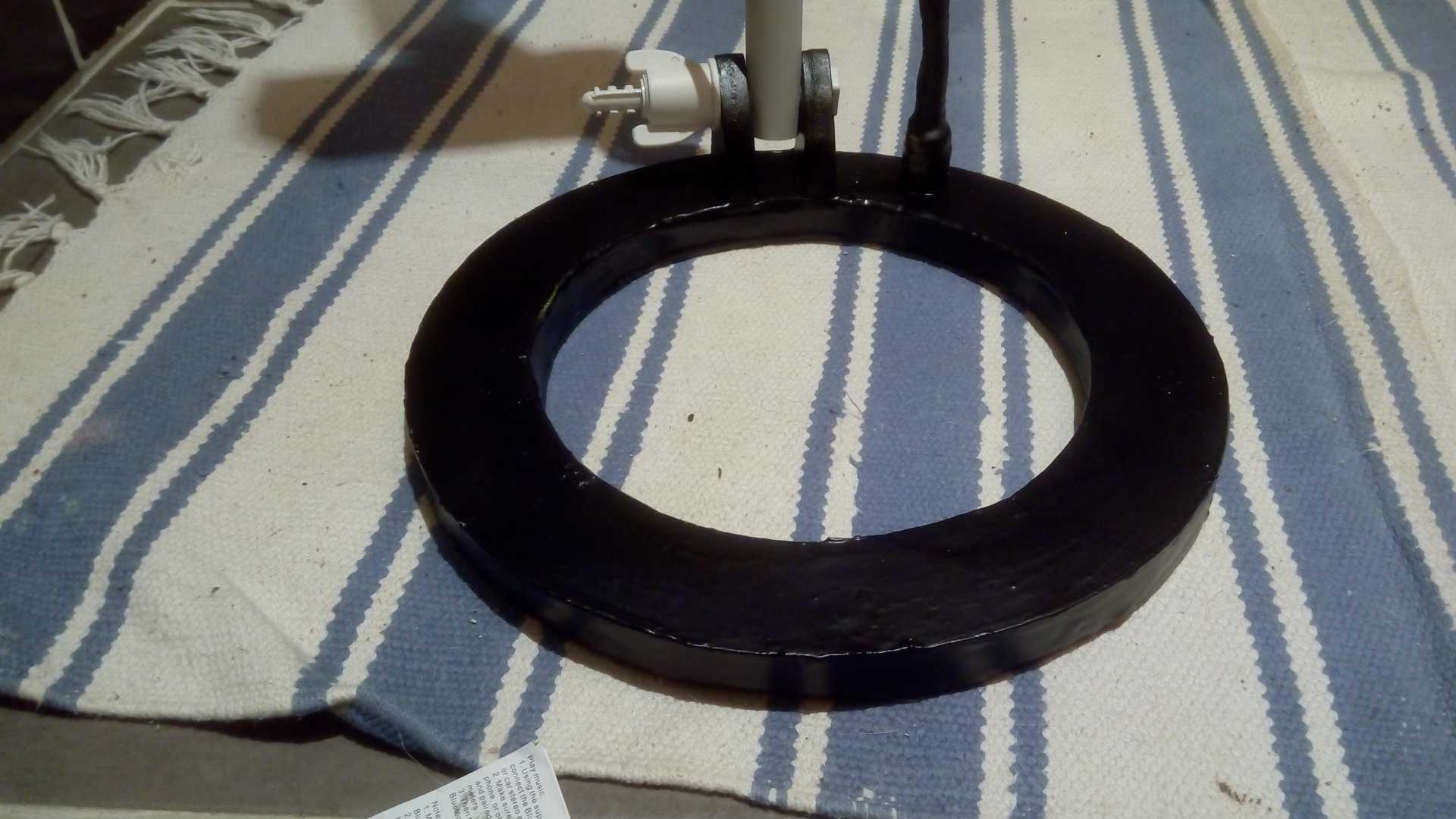

    and, to finish, black spray paint

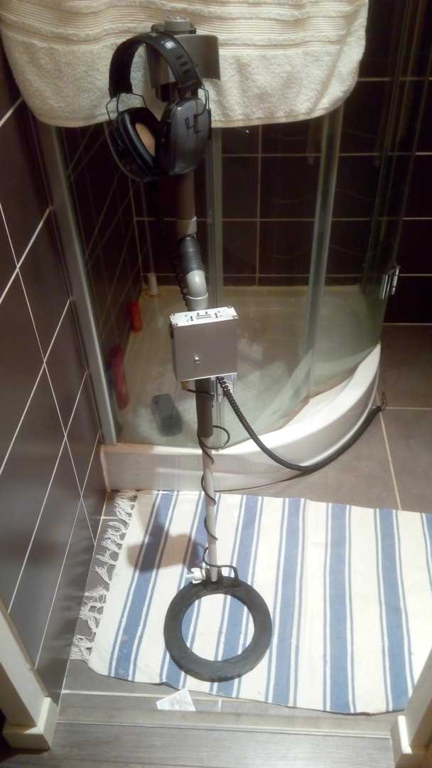

    Her is the whole detector :
    My coil has an exterior diameter of 23cm, 1.1ohm and 318µH.
    The delay is short int clone menu (about 5 to 8µs).

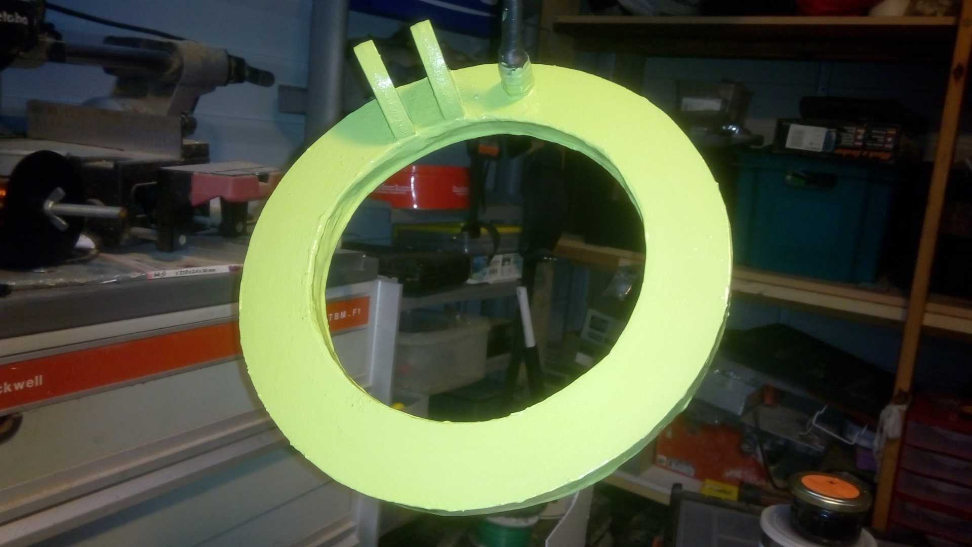

        By the way, how do you make the casing and the hook to attach the stick?
          3DSS Coil Construction Explanation
          Hi Teleno,
          The easiest durable method for bridging the 3DSS is using fiberglass to provide a surface for the mounting tabs or lugs. The mounting tabs can also be formed out of fiberglass. However, I use heat formed LEXAN as the core for the bridge and tabs and then cement the tabs to the bridge. This assembly is attached to the already fiberglassed coil with polyester lacing before fiberglassing. All of this is photo documented and described in the Chance PI Coil thread on the last few pages of its postings.
          By the way I am thinking of making a vertical coil with this same 3DSS winding pattern to see how it performs. While the horizontal coil windings are low capacitance in air, and near the ground they are unavoidably higher capacitance, it is not nearly as high of capacitance as a bunch, spider, basket, or spiral wound coil with the required separate shield. My 328uh coil runs quiet set at 7us sample delay over damp soil with only the occasional beep that is not repeatable like a true target does. It is completely usable in its present form. Still I am interested in how the vertical 3DSS wind will perform. I already have the vertical coil form specs designed and the insulated PTFE wire has arrived. It should be interesting.
