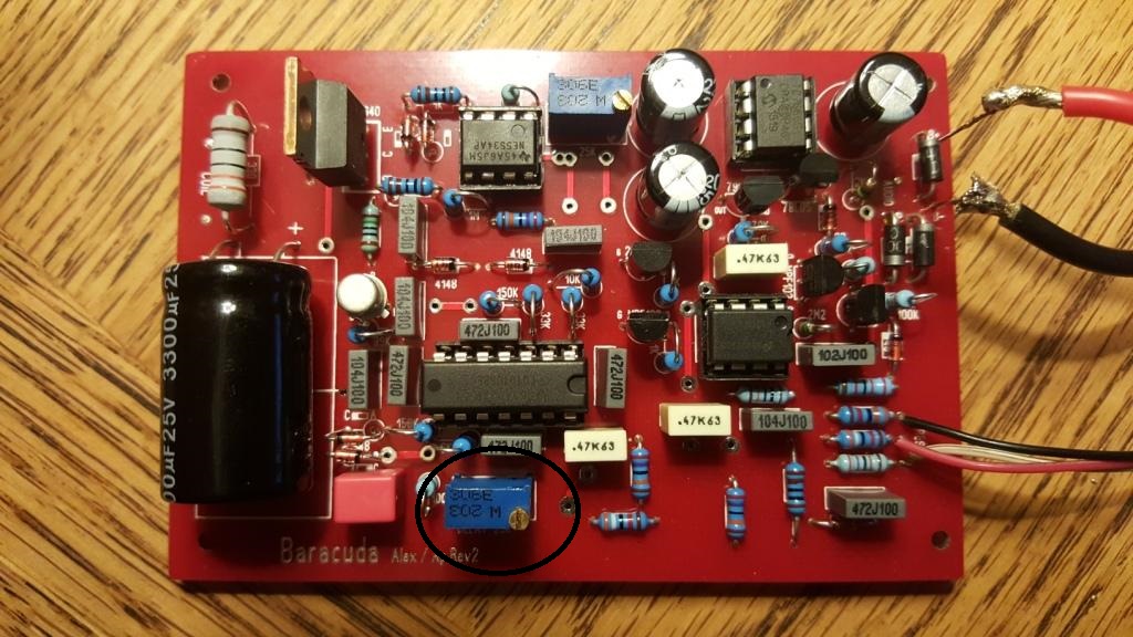

    Hi guys i have a barracuda pi and i want to set the damping resistor just right i have a spare 10k pot (i will put i 330ohm in to prevent a short) and i have a Hantek 6022be scope basic i know but its what i have. How do i connect the scope to the board and coil, in the correct place to adjust the resistance live so i can asertain the correct value? and what am i looking for either under damped vs over damped?
    i am very new to this but want to learn that is why i am asking the guys in the know.

    this is a pic of my board (as my skill runs out after the soldering and connecting the battery) if i dont get/understand what you mean please feel free to draw and point out locations as im no expert.
    Thank you in advance for any help

    I know I have a vested interest, but this is one case where getting a copy of ITMD would definitely pay dividends.
    Inside the METAL DETECTOR - Second Edition - Published 2015

      Your damping resistor look like 33 ohms..it must be 330 ohms or as good value after tuning.
