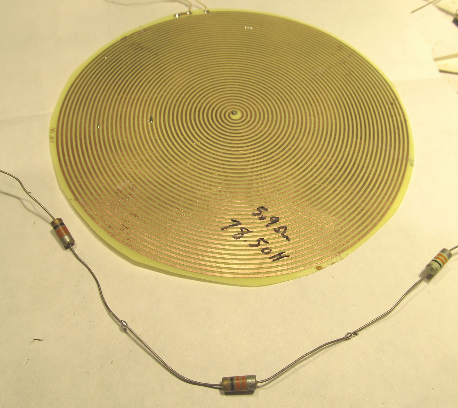

    Years ago, I got some "Paper Thin" PCB Material. (0.008 inch Thick.)
    So I thought I would make a 6 inch diameter, Spiral Coil using this PCB.
    Turned out Fairly Good, except of a couple of Tiny Breaks, which I Repaired with a Dab of Solder.
    Coil inductance is 78.5uH with a DC Resistance of 5.9 Ohms.
    So I Connected it to my Detector and It Won't Detect Anything??????????
    Than I Thought maybe the Inductance was Too Low or the DC Resistance was Too High.
    So I connected a Series String of Small Inductors Together and connected it to the Detector.
    These Three Inductors I Series Measure 91uH and 7.2 Ohms.
    Connected to my Detector, Each of these 3 Coils, Detects Metal.
    Even 3 of a lower inductance and Higher Resistance, also Detects Metal.
    SO, Why won't the PCB Coil Detect Anything?
    ANY SUGGESTIONS?

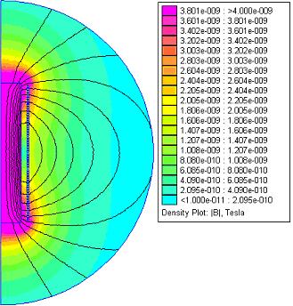

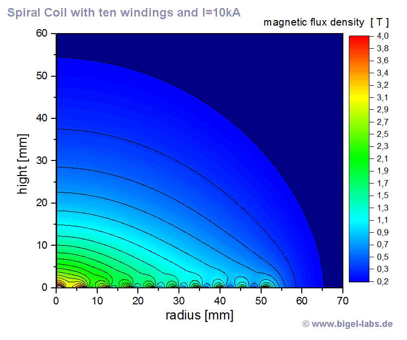

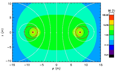

    I'd imagine the field shape for that flat coil will be highly focused in the center of it, while the wound inductors probably have a ferrite core that extends their field notably outside of the solenoid winding.
    Flat coil field:
    Cored solenoid field:
    Traditional loop field:

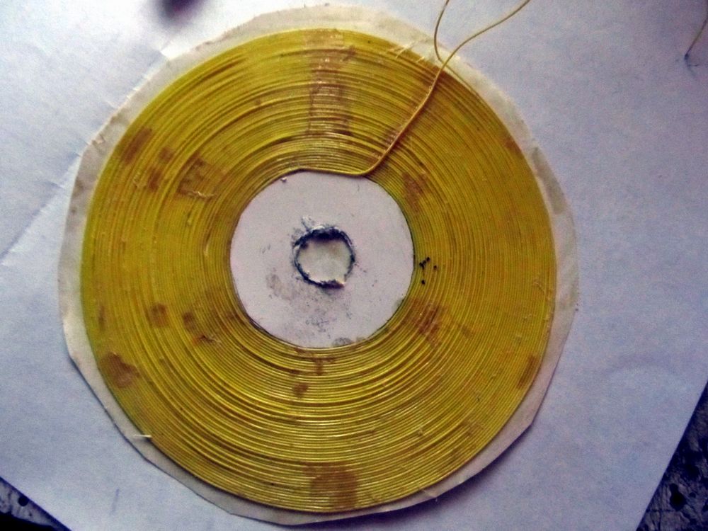

      Previously I wound this 4 inch coil and it works OK.
      (Teflon coated wire.)
      But too difficult to wind the start point with a Smaller diameter.
      That Previous Coil Detects NOTHING, Not even a Large PLATE of Steel.

            Problem Solved, I was trying this coil on my Original Proto-type unit on my workbench.
            Think this one must have a Bad Solder Connection Somewhere.
            Because I Connected it to my Normal PI Detector and No Problem.
            Coil Works pretty good.
