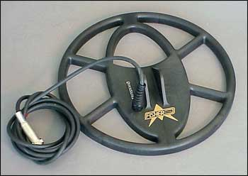

        Oops it's the stock 10.5" coil. There is no other components inside (as I read Dave J. saying in another thread).

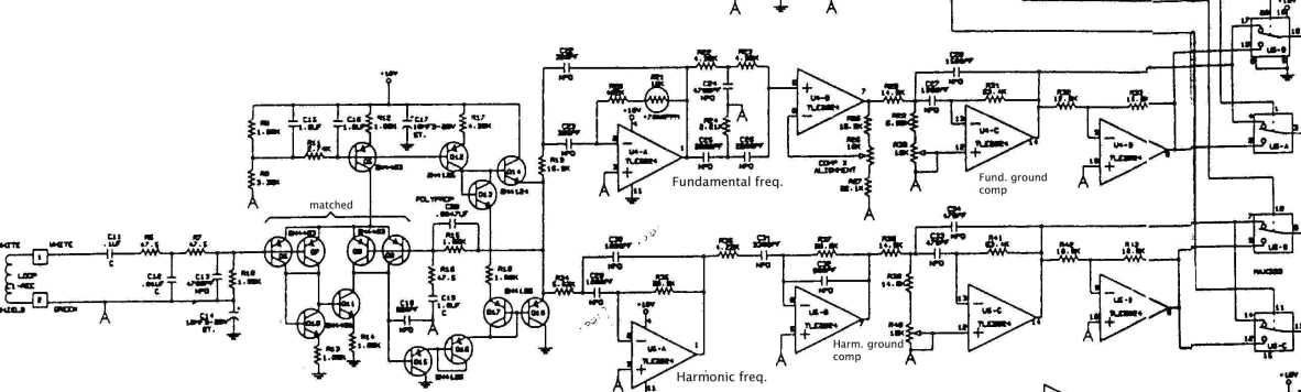

        I believe the dual freqs come from transmitting a square wave and receiving 2 frequency bands using filters.

        There's not a lot of coils available for it. I only know of the stock 10.5" a Fisher 8" and 5". I haven't found any
        aftermarket ones yet...
