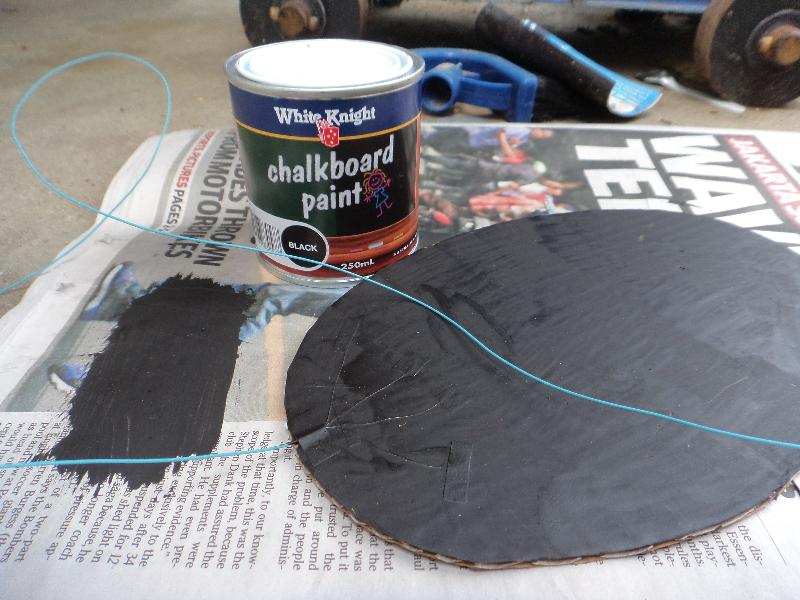

                Just doing a chalkboard paint test, waiting for it to dry 4-6 hrs, did not dilute it just painted on to thick cardboard, ground wire included.
                  Well the first test with the black chalk board paint is a failure not conductive at all.

                        Hi Nupi, thanks for that info I tried this paint very disappointed it did not work must be different recipe
                        http://www.bunnings.com.au/white-kni...paint_p1566487

                            Hi Nupi its not your fault, just different manufacture, there is one more brand in my town that I could try, I tried looking for your brand, but it looks like they do not export outside Europe.
