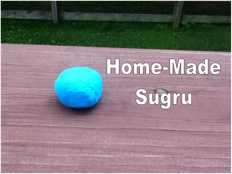

                      One problem with using RTV silicone sealant is it cures from the surface, only to a shallow depth, so you can't fill the space beween coil and cover, for example. That GOOP product may have similar issues.
                      It's possible products like Sugru may be useful, or there's 'home-made Sugru' for those who like experimenting.
                      https://sugru.com/
                      http://www.instructables.com/id/How-...ru-Substitute/
                      http://www.instructables.com/id/Home-Made-Sugru/
                      I personally use electrical insulating tape to fix a home-made polypropylene cover to my hard-working 5 inch round coil. It seems to last reasonably well, though I was going to try the 'sugru-substitute' some time. Polypropylene is slippery stuff, which is why I chose it for a cover, but that makes it harder to fix, too.....
