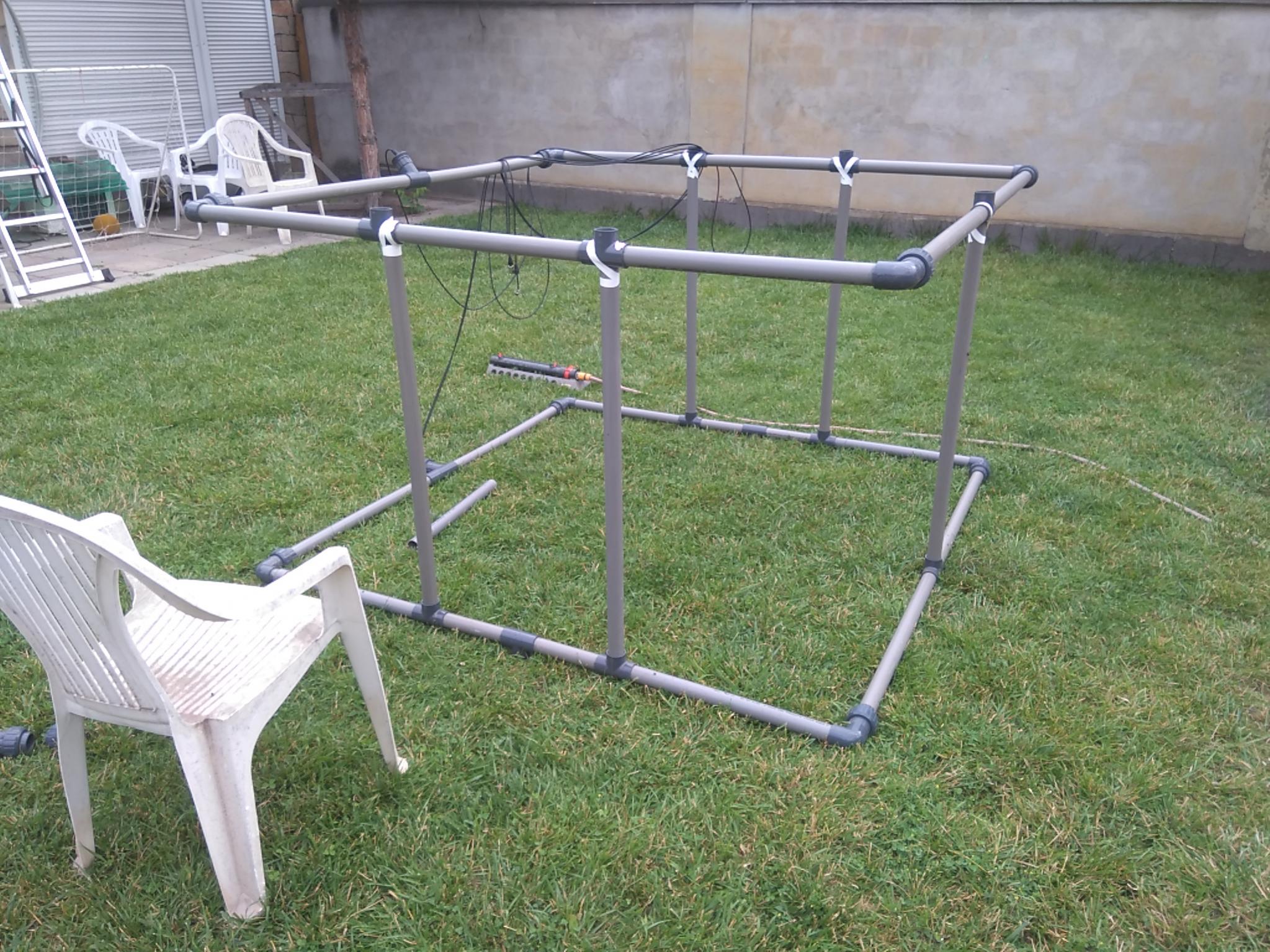

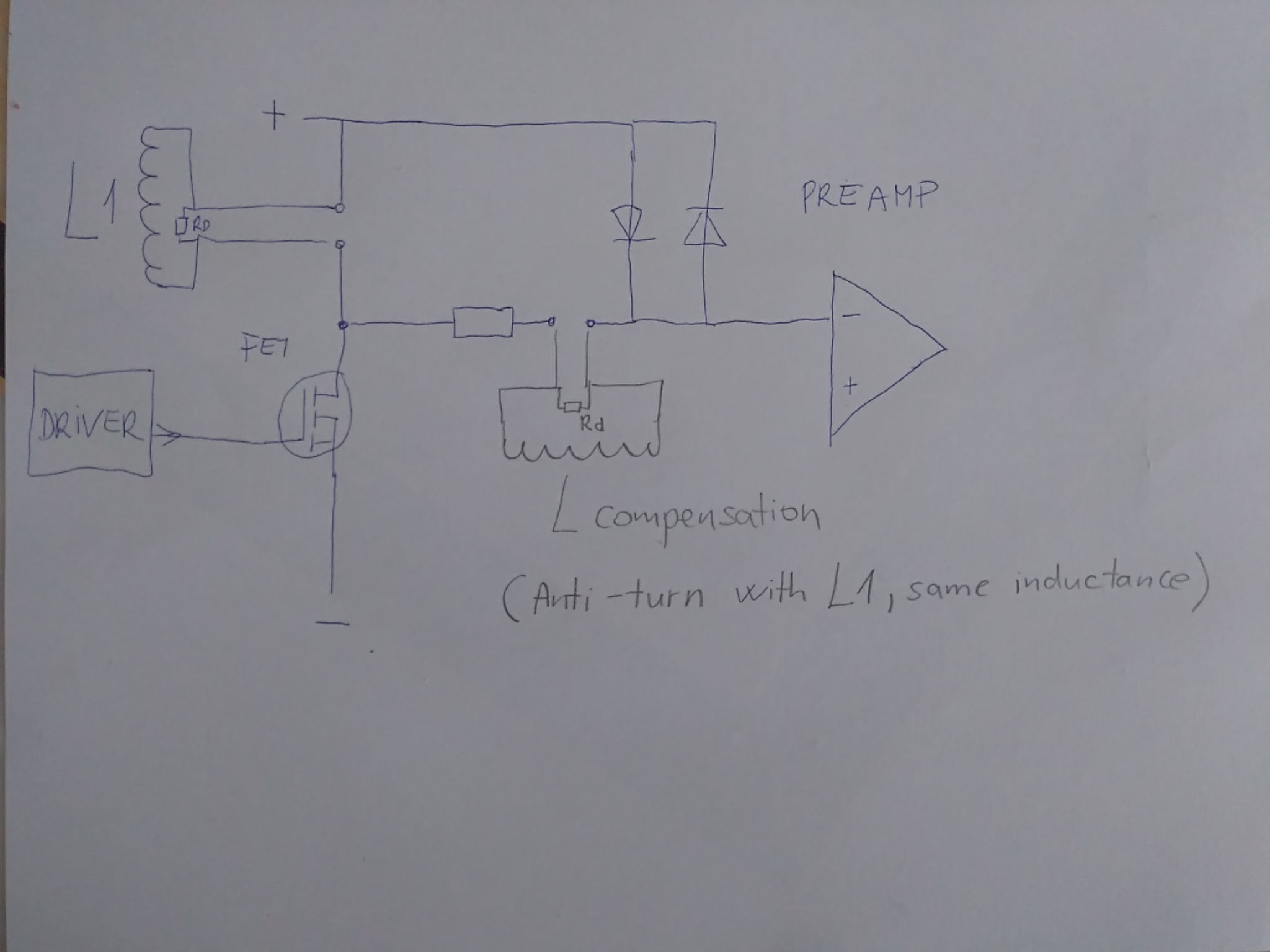

                            Hello!
                            I have a 2×2 meters double frame: lower transmitter-receiver. upper counter turn compensation coil - connect inline to preamp.
                            I use it with PulseStar2pro and homemade Delta Pulse - and it works well, reduce powerline noise.
                            But!
                            I try it with my new homemade Superscan clone, and make more noise!
                            This compensation coil not works with differencial opamp system detector, like Superscan, Minipulse, Hammerhead?
                              Hello sirbedevir !
                              What are the inductance coils on the picture ?
