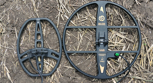

I will study some basic 3D printing in a few weeks and i was hoping to print a coil housing for a dd-coil. i have ordered a kit for TGSL from silverdog and was going to make the "standard" double d coil shown in PDF-files here at geotech (http://www.geotech1.com/forums/showt...mplete-Details). problem is, the coil is 27x27 cm. i will have access to a printer capable of printing items of a size up to 270x230x195 mm. this means i will have to change the size/shape of the coil, or print 2 pieces and then put them together (I still want the coil to be waterproof, so it might be a bit harder than printing a single piece)
i was thinking of waterproofing the coil with Marine Silicone Sealant (http://www.ebay.com/itm/HA6-Marine-A...UAAOSwWnFV8uLG) anyone got experience with this?
should i attempt to distort the shape and make it more oval, similar to the one on the left in this picture?
or should i go with the circular shaped (on the right) but just make it smaller, 23x23cm rather than the default 27x27?
any advice for a beginner?
