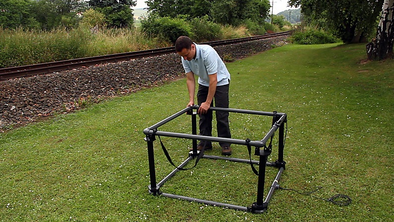

    hi everyone ..
    i need to made a coil like this coil :
    Universal cable coil 8 m perimeter
    This extremely lightweight and easy to transport universal cable offers a variety of different search coils for different search applications. The cable coil has to be fixed with tape on a frame which can be made of PVC-tubes for example. The following search coil configurations are mainly useful for the location of metal objects with a surface of at least 6cm x 6cm or hand sized metal objects for example. Small metal pieces like single coins or nails will be indicated with poor sensitivity or will even be eliminated in some cases because they are out of the range of these frame coils. It is very easy to cover a large area with frame coils in a short time. This is especially useful when looking for bigger deeply buried metal objects while ignoring those smaller metal pieces at the surface. The following frame mounted search coils have to be carried by two persons with adjustable carrying straps. The search coil should be hold in parallel to the ground at a constant distance of 10 to 60 cm. The electronics control box should always be carried far away from the field of the search coil. It is also necessary not to wear any clothes, belts or shoes with metal when operating the detector to avoid false signals.
    thanks for all
    thats very easy
    look for a wire which hast 6 or 8 inner core wire with separated insulation
    at the t -connector solder all inner wire in serie only left one beginning and one end
    the two which are over conect to coil connector

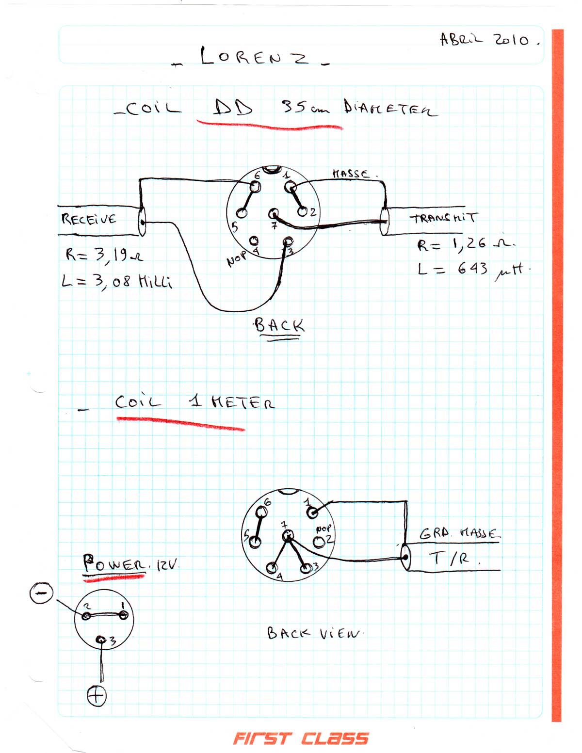

      do you have a schematique ?
      becaus i caer to the detecteur . its now
          thank you Mr Kt315
            inside Click image for larger version
ID:	359176Click image for larger version
ID:	359177Click image for larger version
ID:	359178Click image for larger version
