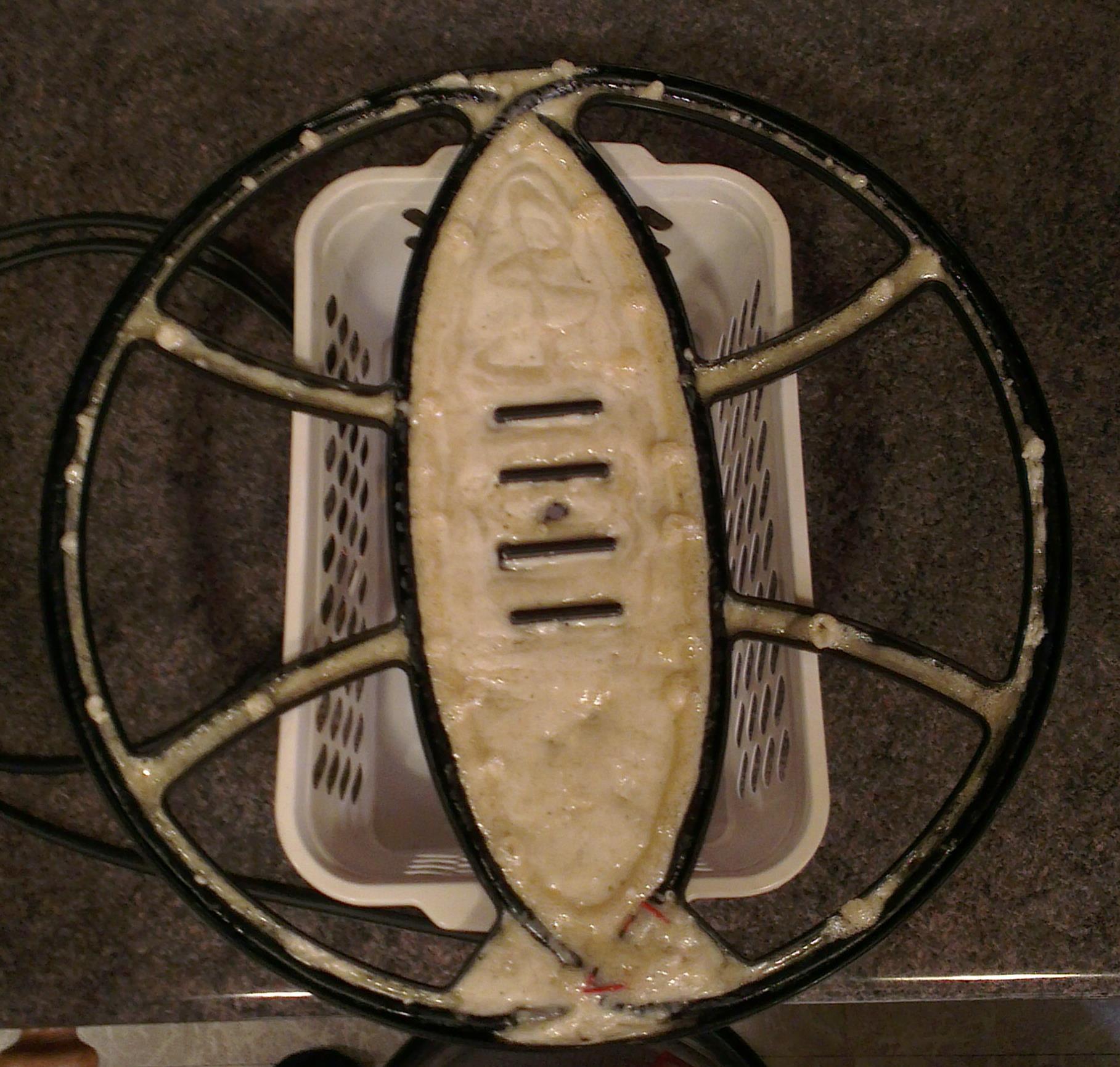

    i have a 14" land craft two piece coil shell...whats the best way to seal the two halves so water proof.
    also what lower rod do i need as my whites lower rod is too narrow to fit the coil bracket.

    i've used many landcraft 14" coil shells for my projects.
    here's what i do :
    i set the coils in the "upper" shell with superglue,
    once it's tacked into place,
    do a complete run round with superglue to stop any movement.
    then clip on the lower cover and hold in place gently with many cheap G clamps.
    using pure acetone in a syringe ,
    ( nail varnish remover-pound shop-the small bottled one)
    (not the big one-that's diluted)
    run around the joining groove gently applying a drop at a time and watch it
    run round the joint.
    leave clamped for about an hour.
    then fill same syringe with thin spirit based lacquer
    (poundshop again, small tin clear lacquer.
    and run it around the joint,
    inside and out.
    leave overnight.
    job done.
    oh,
    i also fill mine with that resin // expanding foam glue :
    gorilla glue // tiger glue ( other glues available........)
    before lid is put on,
    makes the whole thing more rigid.
    oh,
    end note :
    careful with the mounting ears on the coil shell,
    the last 2 i got were defective,
    poss bad casting,
    they just "fell apart"
    when i tightened the nylon bolt,
    had to re-enforce the ears.

    sorry,
    couldn't find a picture of a coil with the clamps on hanging from a rope from the window rail.......LOL.

        the pure acetone "melts" the casings to bond them together,
        so don't apply to much,
        just enough to run around the joint.
