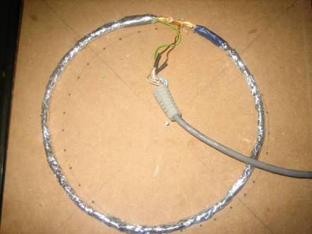

    I have a question about coil shielding.
    I plan to use copper-tape for shielding.
    My question is, should I cover the complete coil or only surfaces not faced to ground?
    Complete coil with a gap

      Whats the gap for?

        If you don't have a gap, the shield will act like a shorted turn on a transformer, and your detector will lose all sensitivity.

          If you are looking for delay times of less than 20uS, copper tape might not be the best, as even with a gap, you may get excessive signal from the shield. Properly damp the coil with no shield and if you have a scope, look at the output of the preamp and see how fast the waveform recovers to a flat baseline. Then put on your shield and then observe how much the recovery time has increased. You can get some improvement if you have the shield tape flat around the side of the coil, fold one edge around the coil to the inside and then a strip of insulating tape on the first fold, so that when you fold the second edge over the first, the two edges are insulated from each other. If you wind the tape helically around the coil, then normal copper EMC tape will be too conductive and ruin the recovery.
          A flat shield should be on the ground side as it eliminates the coil to ground capacitance effect, particularly on wet ground or wet beach. It will do little to reduce r.f. pickup, whereas a shield around the coil as described above, will do both. The best material for a flat shield is graphite of nickel conductive paint. A solid metallic flat shield, even with a gap, will give a large signal.

            My xperience with shielding is always reduce the deep, and what would happend if i shield my coil but i not connect it to gnd side of the battery? In this case i found it has no different, whatever i connect to the gnd or cut the line, all test is do above the ground(air).
            I put shilding (alu foil) roll and roll over the coil, not make a long strip from the outside and inside of coil circle, is this the right way of shielding?
