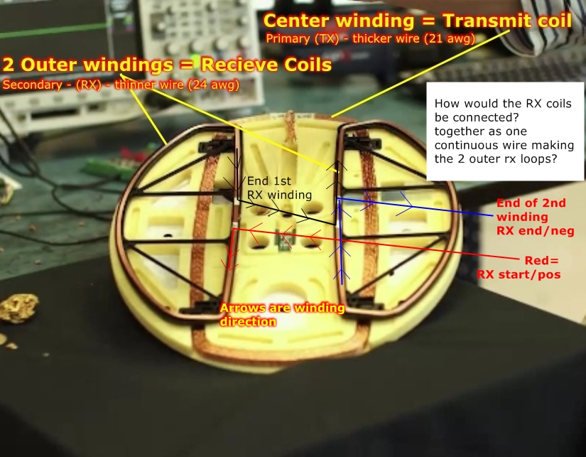

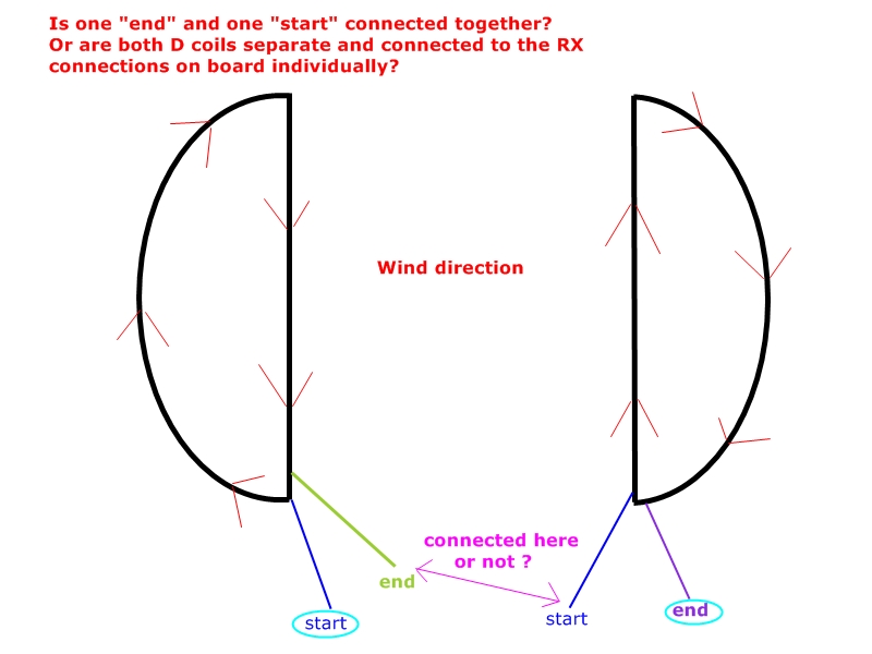

    I saw this awhile back and wanted to try one but am not sure of how this particular coil is wound.
    Are the RX coils one continuous wire, wound separately as the two outer loops with winding the same direction?
    See pic for clarification..

    Hi geoscash,
    Ive been wanting to make one of these as well. The way it looks right now how you have the wind direction it would I think act like a figure eight coil as the fields would be flowing in opposite polarities.
    It wouldnt hurt to make the coils seperate and try both configurations.
    One thing to consider is that both coils will need a seperate damping resistor.
    I think there are some components in that coil we cant see.
    I just built my first (3dSS)dual field coil and the whites patent on them states that each coil will need a damping resistor.
    Here is a link to the patent, https://www.google.com/patents/US7994789
    Figure 6 is how to wire the coils in succesion. R1 is your damping resistor in the detector .
    Damping the second coil is a bit tricky as you cannot see the op amp out put on it. What I did is look at the flyback and there was a spike midway on the downslope there I adjusted out then looked at the coil flyback voltage and adjusted it to max while checking sensativity with a nugget. For this coil I am getting 508 volts flyback on a stock minipulse and nothing is heating up but Im waiting for the magic smoke.

            It appears the windings should be out of phase for the coil to ground cancel properly, I just finished making the coils yesterday with a 254 uh tx and two rx's at 180 uh but when tied together I only get 310 uh rx.
            Today I will balance them and test them, I want to try both in phase and out to see the difference in sensativity to noise.
              Out-of-phase is what you want. If the 2 RX coils are completely uncoupled then the total reading would be 360uH. If they were perfectly coupled then the total would be 0uH. Since they are very loosely coupled, your result of 310uH is very reasonable.

                    Ohh Yeah you want to wire the coils in parrallel not in line .

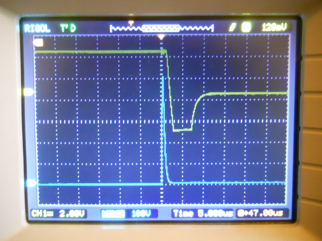

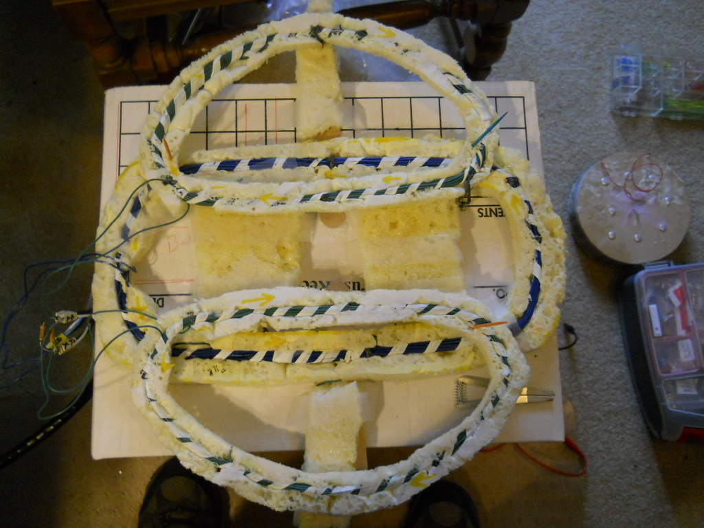

                      Hi Geoscash,
                      Finally got this coil to work like its supposed to as far as ground cancelation goes.
                      Here is a pic of the winding directions I used.
                      The Tx is 22 awg solid 20 wraps 264uh damped at 542ohms.
                      The Rx are 26 awg solid 20 wraps 180 uh 310 together, individually damped at 191ohms.
                      Here is a scope shot its not the fastest I think due to the wire I used and or the Rx coils could be a higher uh for more sensitivity .

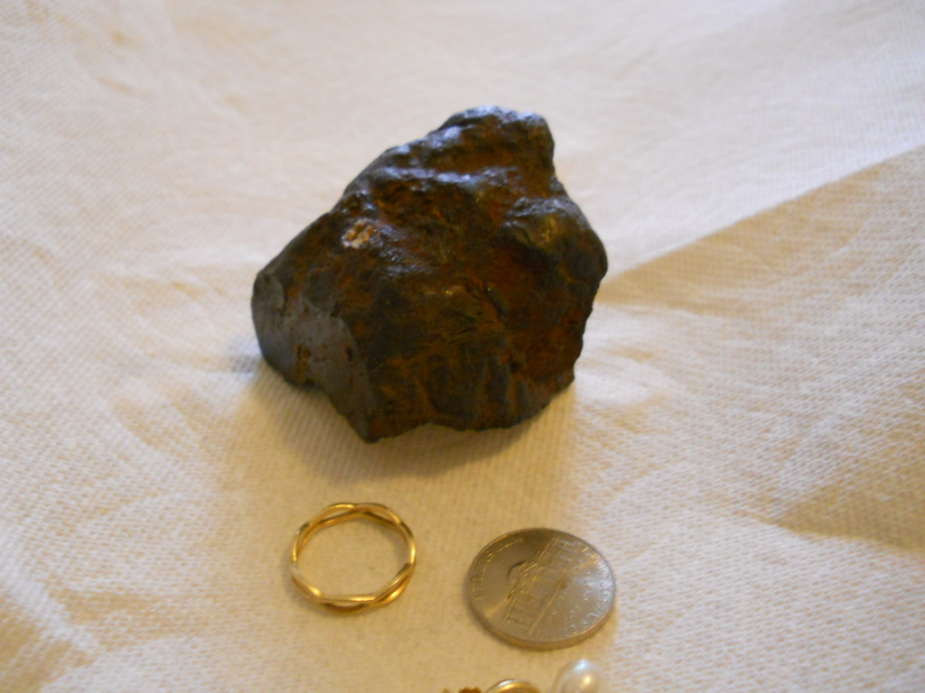

                      Here is the chunck of hematite I use to check ground cancelation. Its tough for any coil to eliminate at 5 us. This coil does it almost completly and still hits my gold rings held behind it.

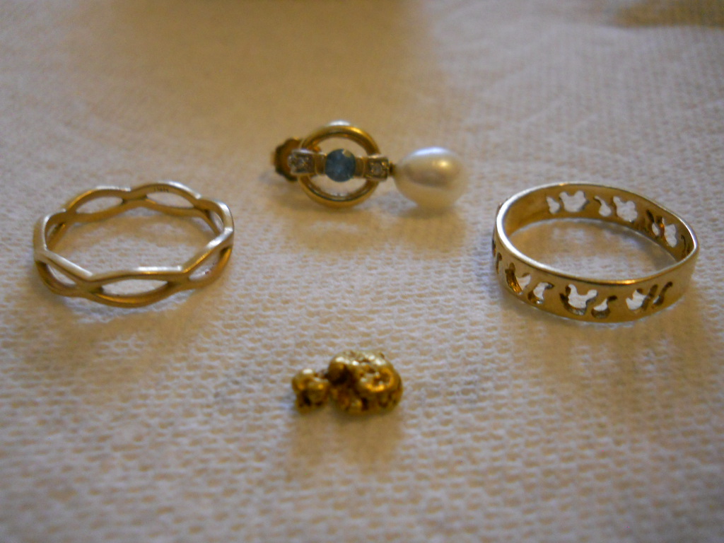

                      The nugget I use as a tester is hard to hit for a 1.2 grammer as it is porus but not invisible. When the Rx coils were undamped I could get it at just 4 inches but my ground specimen also responded. Once everthing was damped and balanced it canceled the ground but the nugget it barely squeeks.
                      The plus side is it still hits small rings my test rings are 1.5 and 2.5 grams 14k at 10 + inches nickel 12+ Yet it lost the 1.2 gram nugget and hits this earing at just over a gram at 3 + a little inches. Might be good where I want to ignore small foil and with the ground canceling effect these coils might do well in salt.

                        If I understand it right, with the Rx coils out of phase there is a null in the center. Cancels any target, ground,a nickel, etc. if both Rx coils see the same percentage of the target.
                        Figure eight coils cancel ground if ground is the same under the coils and the same distance from each Rx coil. I have found they are better at reducing external electrical noise than cancelling the ground signal.
                        I lost a lot of the signal at 12 inches with a 8 inch coil so I wouldn't have been able to detect the nickel at 12 inches with Rx out of phase. At distances less than coil diameter there wasn't a big difference with coils adding or subtracting except for the null in the center.
                          still confused!!!
                          Thanks for the info godigit1, but I am still confused as to which way to wind the coils, opposite each other?, the same direction as each other? What is "coupled/un-coupled/loosely coupled" mean? And how do you or how are you connecting the each individual wires of both D coils, is the end of one and start of the other tied together or is each coil wound separate and connected individually to the receive connections on board? Thats where my confusion is at....lol
                          I always thought for it to RX or work correctly, the 2 coils had to be the same wire from start to end, meaning wind one half then continue to the second half with the end of the first half so you would end up with a "start" (plus side) wire on one half and the "end" (ground/neg) wire on the second half... example drawing attached....

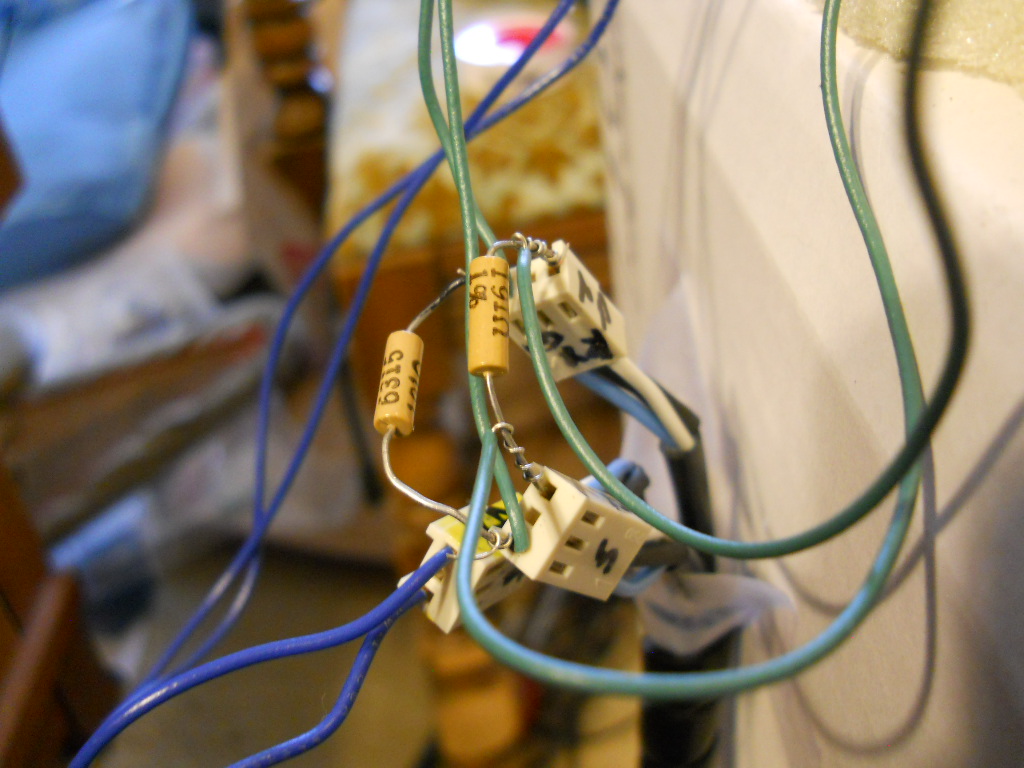

                            Hi Guys,
                            (How do you damp each coil individually if the coils are in parallel?)
                            I placed the damping resistor at the coils directly between +and -
                            I made a nine wire test cable for testing up to three coils at a time. So I was able to try wiring a few different ways.
                            I ended up with the coils in parallel with there own lines back to the MPP where both RX are joined and negatives connect directly.
                            Its on the board the wiring becomes parallel.
                            (I always thought for it to RX or work correctly, the 2 coils had to be the same wire from start to end,)
                            I started off with the coils in line But I couldnt get the coil to behave properly.
                            You want to wind the coils as in the jpg of the DDs and the Tx coil direction lines up with the directions of the flats of the d's.
                            Here is the set up procedure I used.
                            1 Connect The tx coil as a mono and damp it Then disconnect it from the RX.
                            2 Place your first D on your tx and put a damping resistor set up between the wires. Put your scope probe on 10x and connect directly to the coil while the TX is running damp out any oscillations as best you can.
                            3 Go ahead and pre balance the coil while you are here but it will have to be fine tuned again.
                            4 Repeat for the other half of your D
                            5 Hook up your first coil.
                            6 Monitor your Tx op and flyback on you scope, it will look like hell. Now take your d and adjust it first away from the center, your Tx will clear up and invert .
                            adjust your d back toward the center tell your signal goes positive, Fine tune out the little spikes paying attention to the amp speed and get it close to where it was when you damped it first. I also played with a target at this point making sure What I was doing was effective. You can see by my scope shot that I still have a little spike where the fly back peak is but this is where I got best response.
                            7 Repeat for your other side and redamp the Tx.
                            With this set up I was getting a nice detection field. Testing with a nickel I had good depth at the edges About 8" and wider than the coil, then the field mushromed up to the center about two inches and in the center it had another 2 inch gain in the typical DD knife shape but only about 6"of the center of the coil. kinda like a curly bracket }.
