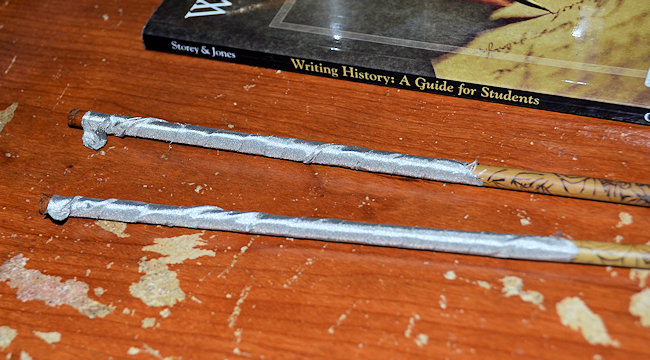

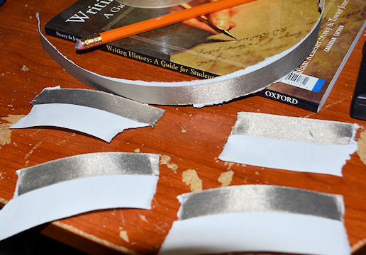

          The last few coils I experimented with aluminum tape. Unfortunately (maybe) it does not have conductive adhesive. Before pulling my hair out, decided on a small test. Tore off two 31cm strips (about 25.25" each). Then tore one of the strips into four pieces. I wound them onto two chopsticks (only things handy at the time).
          When tested with my multi-meter: yields 0.4Ω on both winds (measured on the outside). What am I missing?
            Confused I am. What are you asking here ? About the Resistance of the foil ? .4 ohms could be your test leads. Make little difference. The Shield could have a few hundred Ohms and still work fine.
              Was referring to conductive/non-conductive adhesive on tape. There was a suggestion that covering a tape break with non-conductive adhesive would not produce a valid Faraday coil shield. In this experiment it does not seem to matter. But might in a completed coil? I have three coils made thus, great depth, but probably useless in highly mineralized soil. Can't get outside to test ... too much snow and cold.
