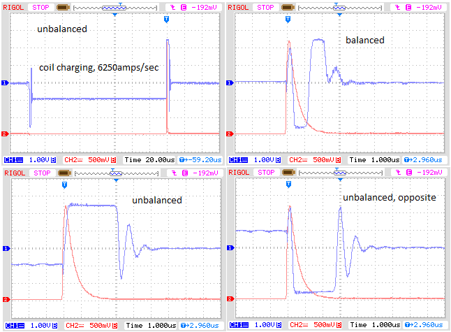

              Connected my 8 inch DD coil to the bench circuit and performed some tests. Scope pictures amplifier gain 450, unbalanced(coil balance, one of the first attempts at IB coils, not very good) balanced(used a ferrite bead to balance) unbalanced, opposite(used the ferrite bead to unbalance opposite polarity). Looks like could sample the balanced coil a little sooner. Channel 1(amplifier out) Channel 2(probe near mosfet to show decay shape) I haven't been able to prevent the amplifier from saturating during the decay, would be interested if you can.

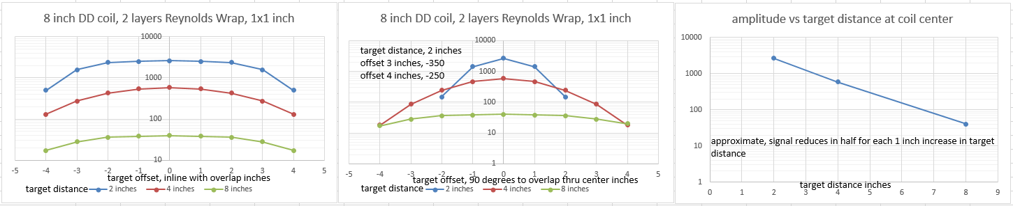

              (DD coil) Charted integrator out vs target distance while offsetting target from center of coil, inline and 90 degrees from DD coil overlap. Couple observations,(a DD coil is usually drawn to have a narrow detection range) charted a narrow range with 90 degree offset with the target at 2 inches. The amplitude at 3 and 4 inch 90 degree offset reversed polarity(added value to chart because log plot can't chart minus values). At larger target distances not so narrow.
