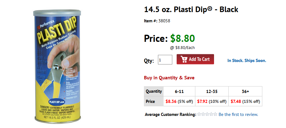

    Poor a little in the housing apply with brush. Let Cure. Keep adding layers until your happy.
    https://www.lowes.com/pd/Plasti-Dip-...3-5fd3c27b2c4b
    Nice product.. plastic dip.
      Short CUT. Click image for larger version
        Short CUT. [ATTACH]39434[/ATTACH]
        Nice. Do you know something about isolative/conductive properties of Plasti Dip?
          None Conductive. Can also be used as protective coating on under side of coil housing like coil skid cover.

            Yes, probably this "Plasti Dip" suit better to our coil potting needs:
            https://plastidip.com/our-products/liquid-tape/
              Actually it's the same stuff. Just thickened. Plasti Dip does contain Methyl Ethyl Ketone that likes to eat some plastics but I've not found it a issue using thin coatings.
