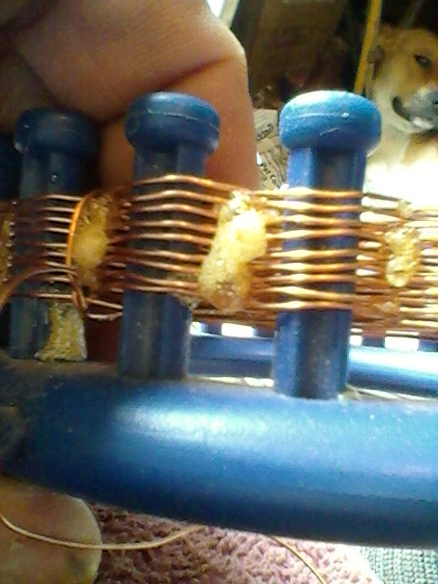

      This should get you there. Save your self the head aches and hit Wal Mart. These things are Magic. https://www.walmart.com/ip/Darice-Easy-Knitting-Round-Loom-Set-Neon/10727494
      Includes four neon-bright round looms: Pink 9-1/2" diameter, 41 pegs; orange 8-1/2" diameter 36 pegs; lime 6-1/2" diameter 31 pegs; blue 4-1/2" diameter 24 pegs
