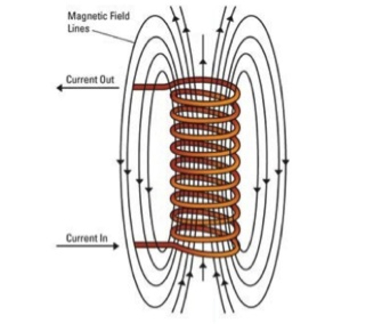

        Is this what they are referring to as a "spirally wound" coil or something similar???
          [ATTACH]39348[/ATTACH]

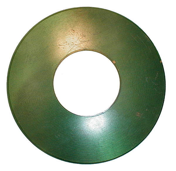

          No, that's a solenoidal coil. Spiral coils are flat, think of an old-style stovetop coil. Here's a Tesoro printed spiral coil:
          Gary (aka Chemelec) has posted extensively on spiral-wound coils, you can do search and see some pics.

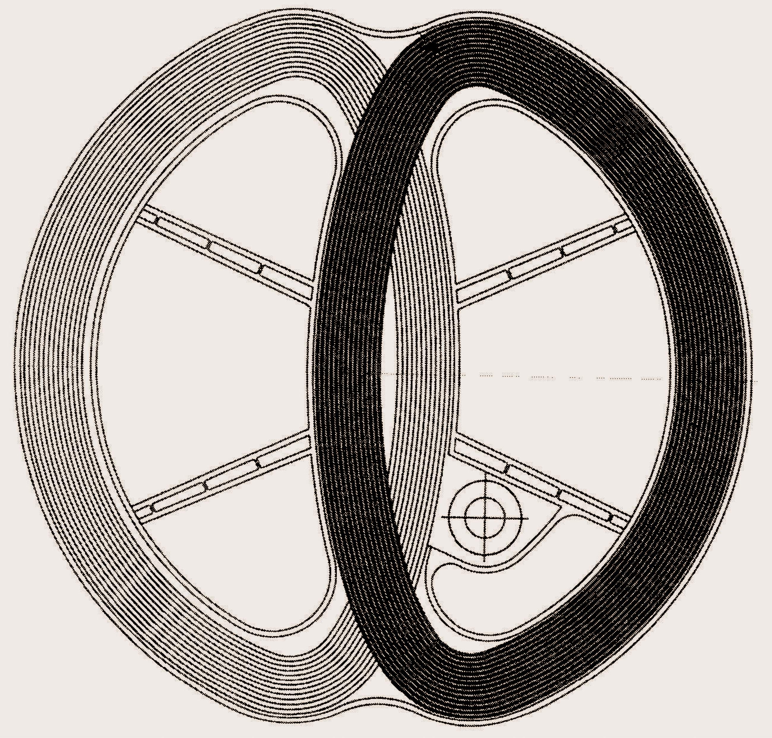

            From patent:
              Coils manufactured in this way would achieve lowest possible parasitic capacitance, but will loose some loop cohesion that will result in lower output power and lower RX end due to lower Q. It is trading one evil for another.
              In the Induction Balance detectors these kind of coils can contribute nothing to performance, but only easy automatic manufacturing process.
              I have experimented with a great variety of RX and TX loops and every single time when the loops get out of the highest Q for the given amount of turns the coils exhibit lesser performance capabilities.

                  From patent:
                  [ATTACH]39361[/ATTACH]
                  I know this is a old thread but looking at this coil it looks like its a Double OO type coil I dont see individual Tx And Rx windings.
                  It looks like the windings stack and have one continuous wire.
                  Thanks to anyone who might still be looking in on this thread.
                    looking closer it must just be a artists conception of the coil.
                    Please disregard..
