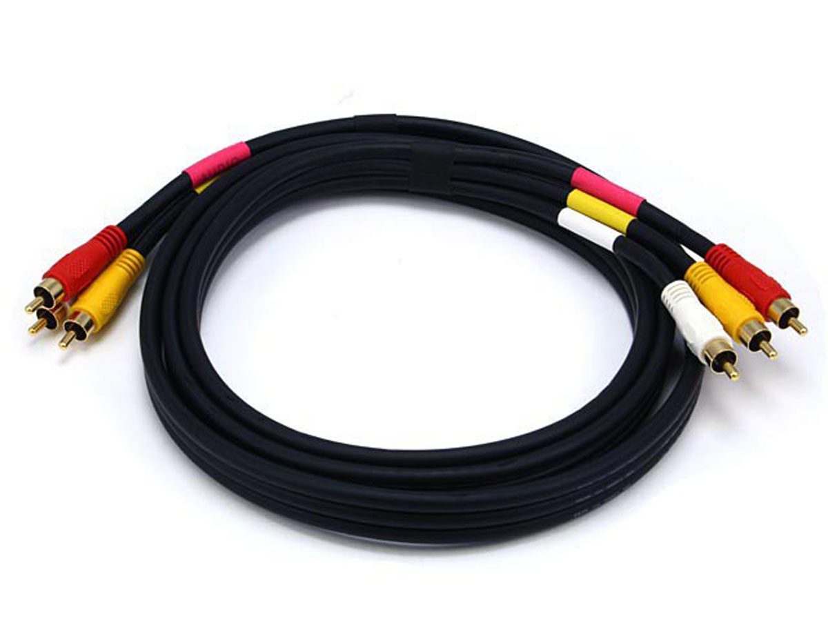

              You can use some better quality Audio cable like for stereo .. Keep the RCA jack and use that too. The Surf is not all that picky.
                  [ATTACH]39548[/ATTACH]
                  So basically, I can just use whatever gives me the best results, that I have on hand, and not worry about interference or anything, right?
                    No not anything. Audio cable is Shielded and Stranded core wire. Just happens to be suitable.

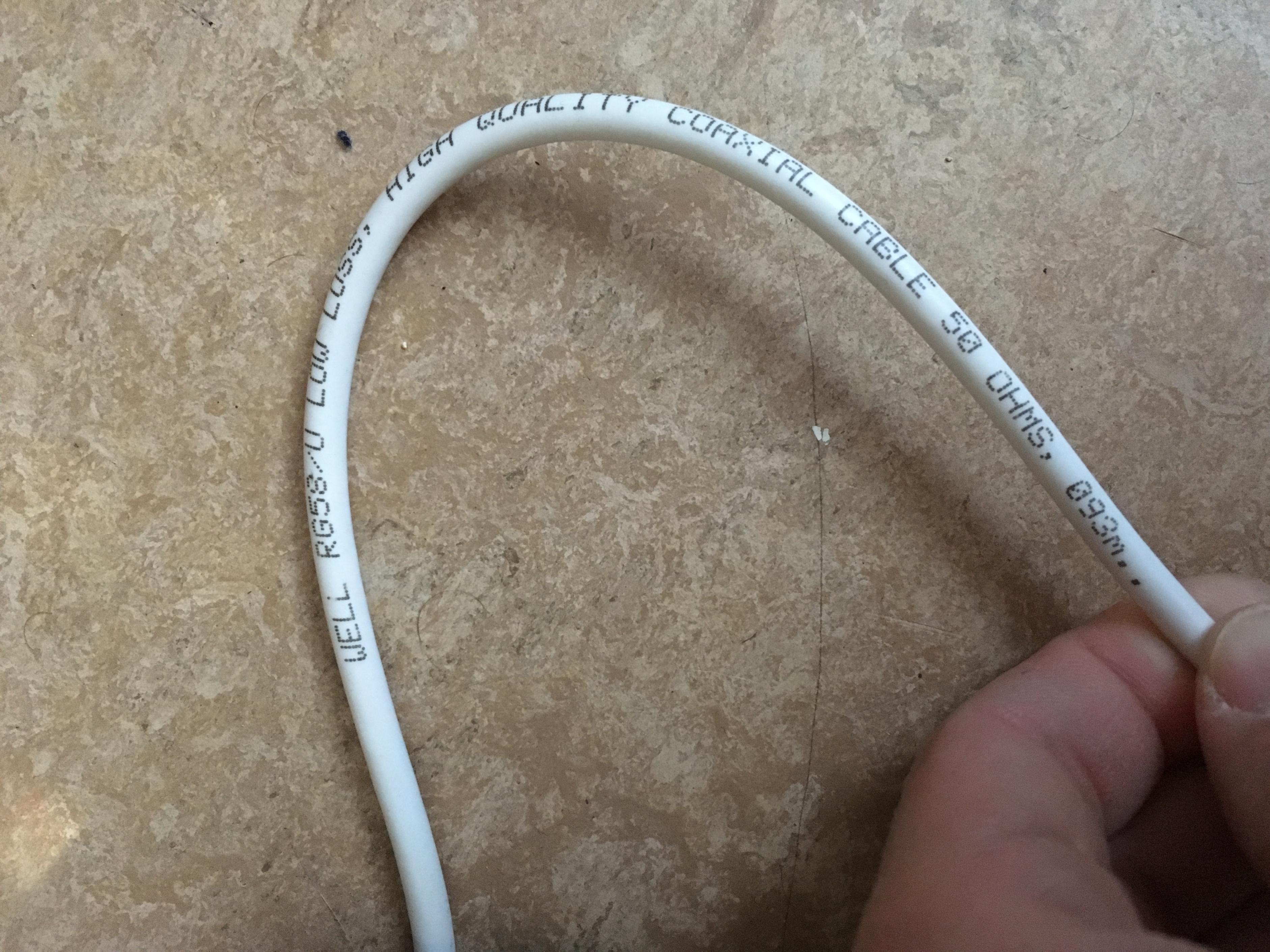

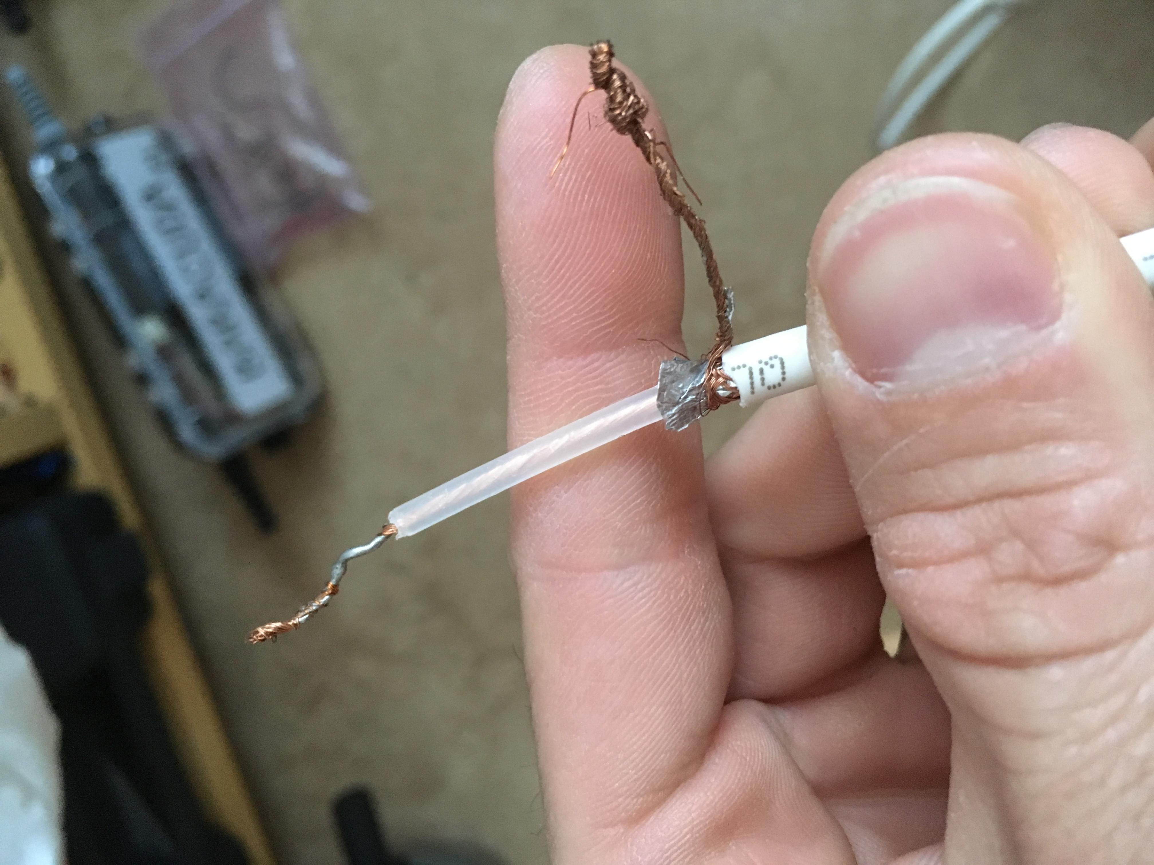

                          Isn't RG58A/U a VHF CB antenna cable? I don't think you could get it in double shielded core like something along the lines of a XTL cable? 2 shielded wires with an outer braided shielding? In that case, what would you use if one wants to make a DD or other coil that has separate TX and RX ?

                            i have some rg58 with alu foil shield.
